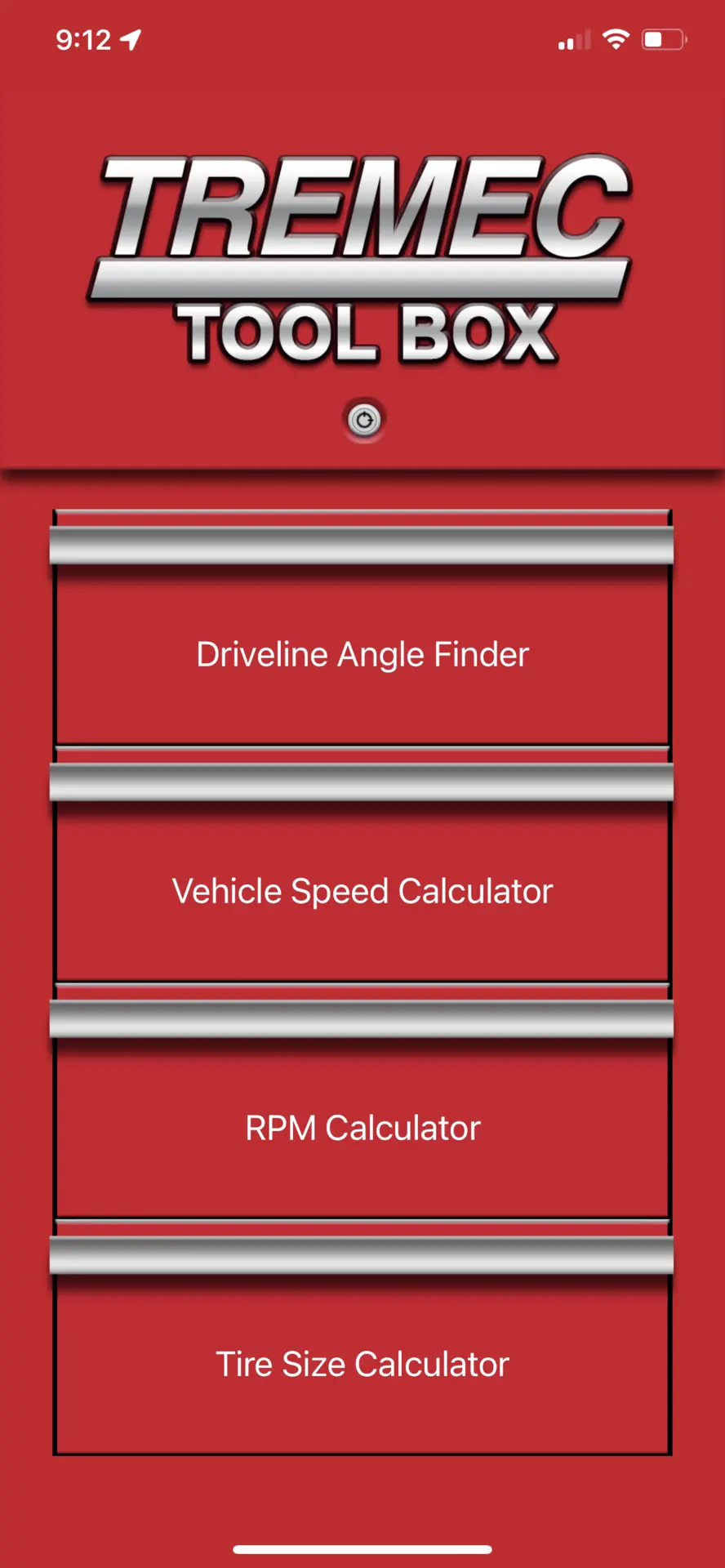

I have been " told" that there is an app you can download to your phone??
Yeah. I saw that in a YouTube vid the other day. I think it's the Tremec app. It basically turns your phone into an angle cube. Maybe it tells you where to stick it, too! lol
What I'm kind of guessing is that there may be a tool that gives me a perfect 90° angle off of the back surface of the pinion flange/yoke, and maybe adjustable to different sizes. The rear housing itself is not a great place to get a reading.
Of course, now that I think about it more, I'm dumb. I don't need a 90° angle. I just need a flat surface. Take the angle of that and subtract 90 :rlaugh:

Tremec tool box is a good app. It’s how I measured my driveline angle

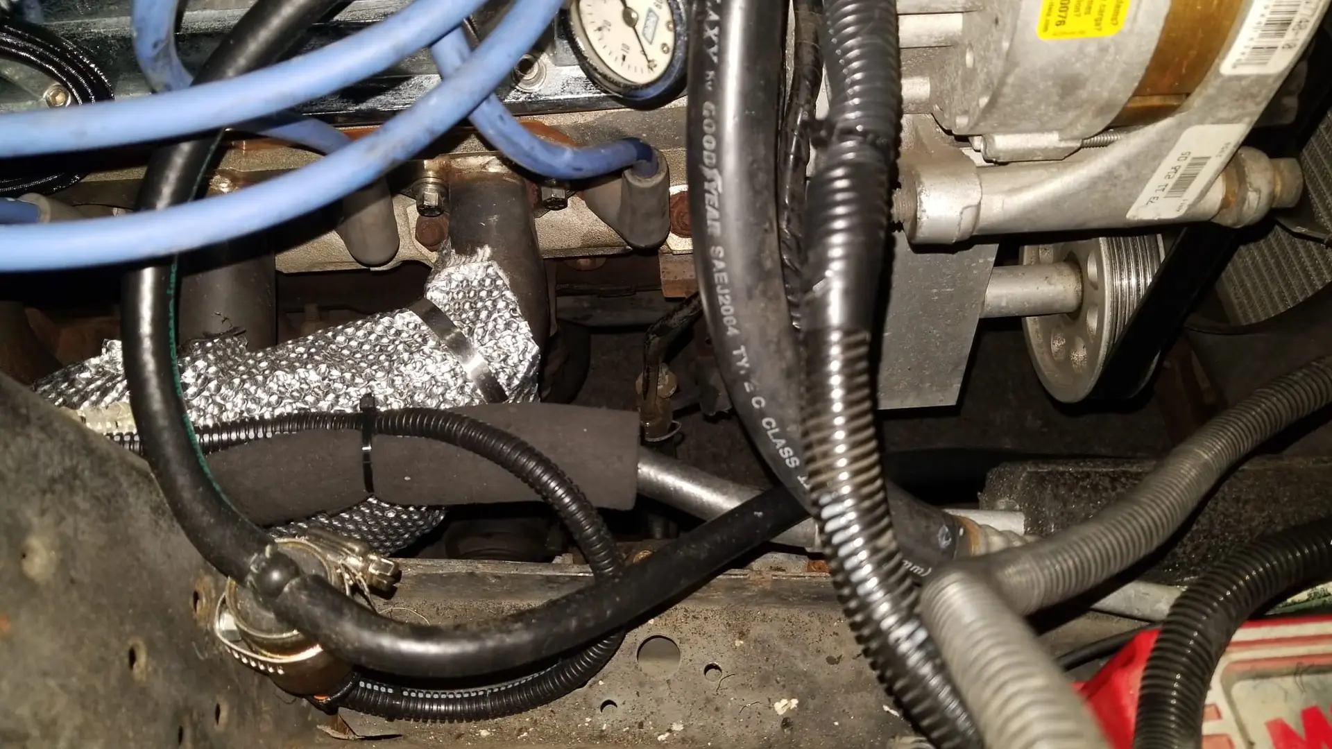

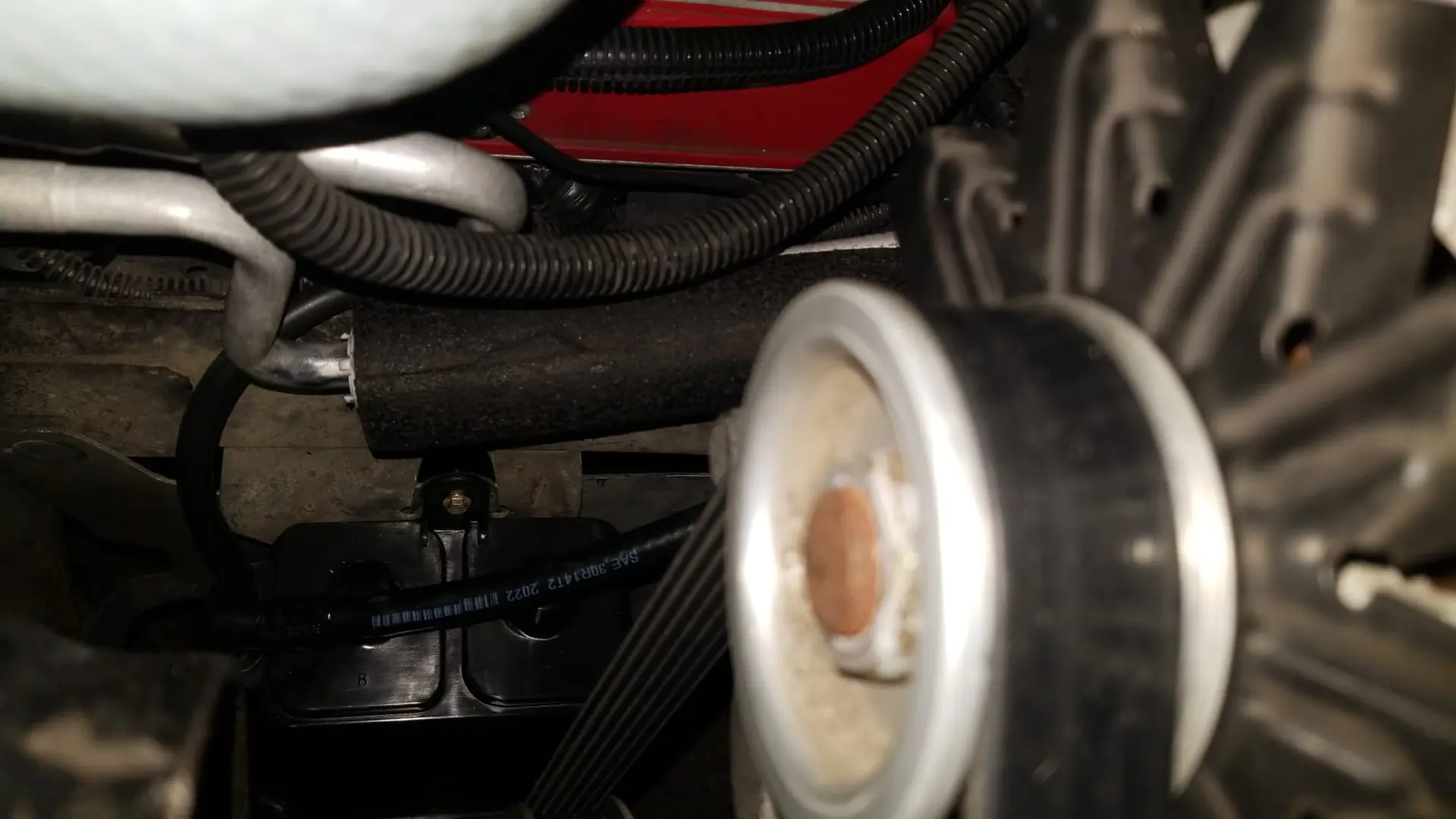

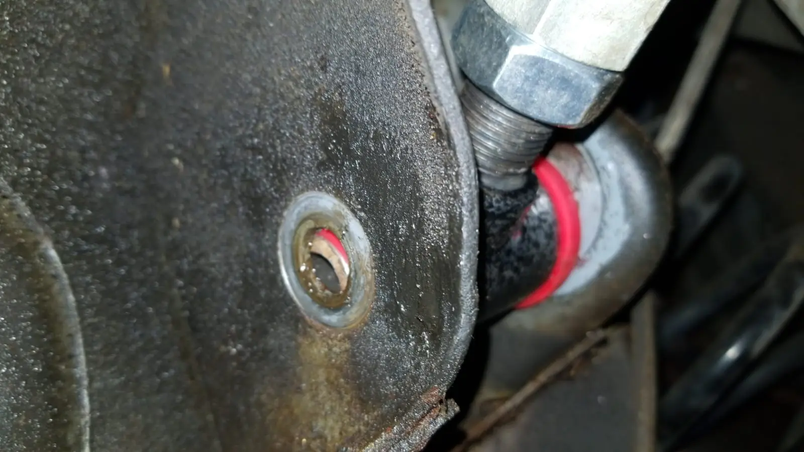

The charcoal canister, purge solenoid, and wiring pigtail is in. On the first night driving it, for about 30 minutes, I didn't catch a single whiff of the smell of gasoline and figured it was a success. However, on day 2, it smelled of gas again... damn... I can't find the smell outside of the car. It doesn't happen when I run it on normal A/C, but it does when it's on Max. Could positive cabin pressure while on normal a/c be keeping it from allowing exterior gas vapors in?
I ran the line a non-stock way, and connected the existing hard plastic-feeling line to a 5/32" (?) line with an adapter, which I then realized I had to size up to whatever-hell-spare hose I had that actually fit the nipped on the charcoal canister. Then I put shrink wrap over both connections to try to ensure an airtight seal. This is not a vacuum line. So, I don't know how successful this will be in the long run, and when I drop the tank, eventually, I'll consider rerunning the whole line. I also probably wouldn't recommend this routing as I noticed tire rub marks and I'm concerned about the line, even though initial test-drive demonstrated no issues. No pics, but the surface rust here has been treated in the same manner as the rest of the stuff I've found on the car.
In this pic, you can see I mounted the purge solenoid in a non-stock location and then ran its vacuum line to a T in front of the upper intake where diagrams showed the stock location. Is there a way to test the solenoid?

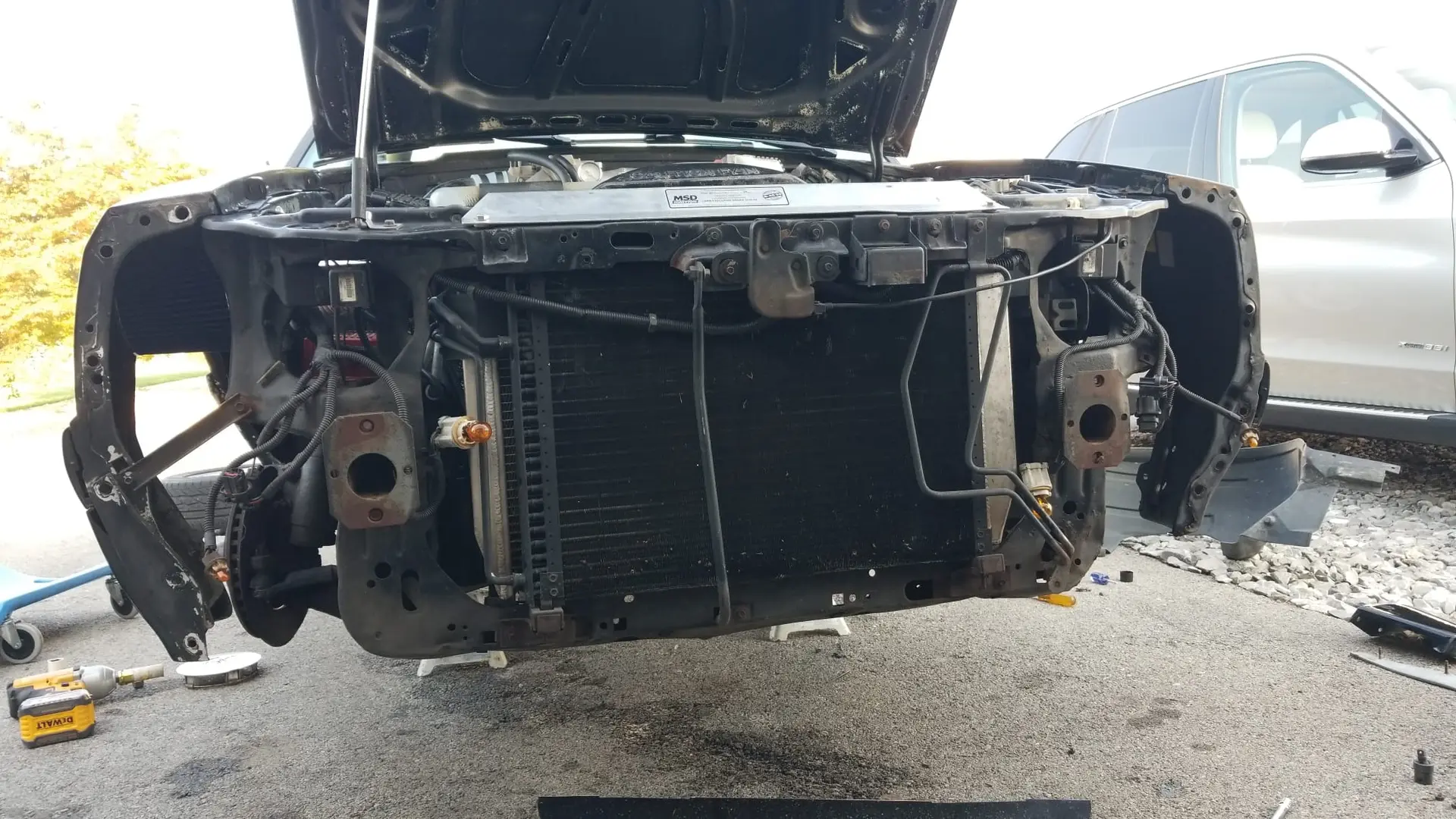

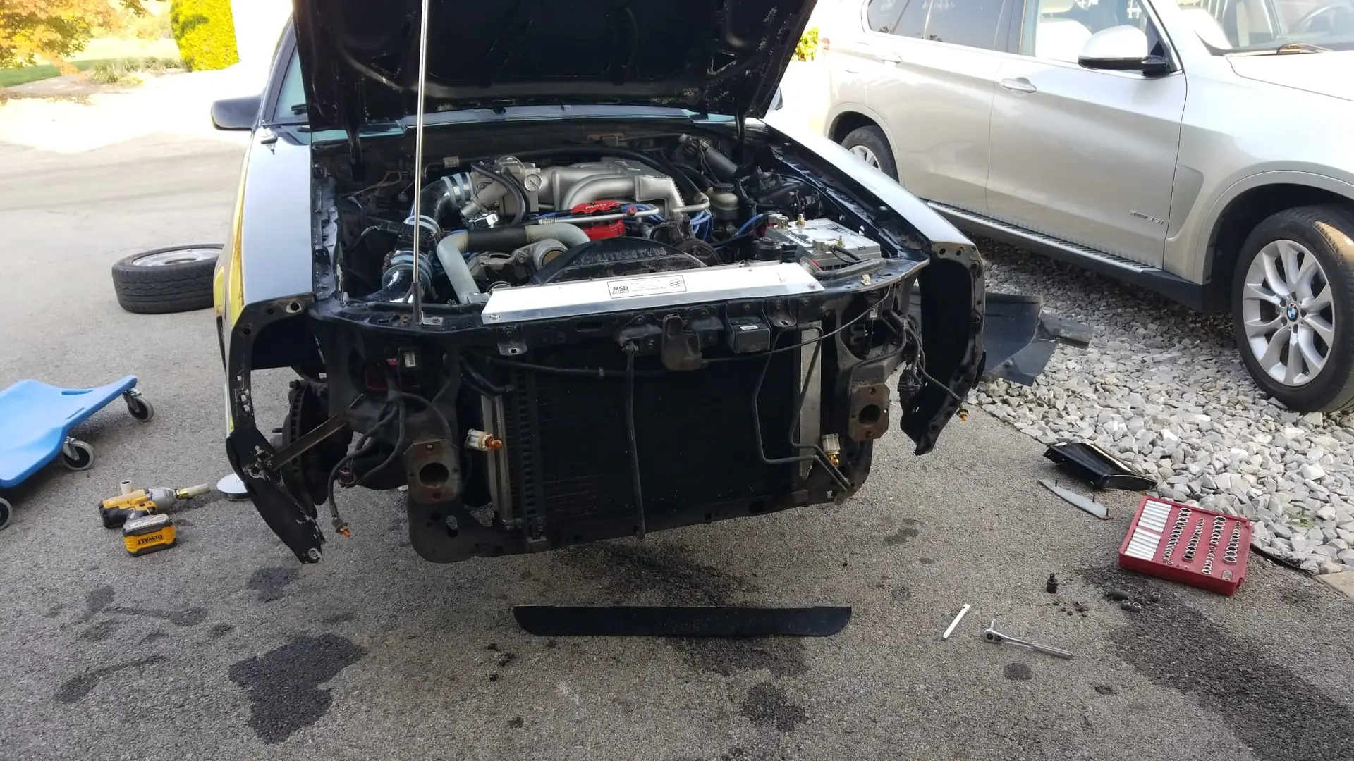

Next up, I found I was missing the front bumper support and ordered one, only to find that the impact absorbers were gone. Looks like they run $150-200 used. So, I decided to put it back together and bide my time until I come across them more affordably. Meanwhile, I did some more resurfacing and corrosion protection:

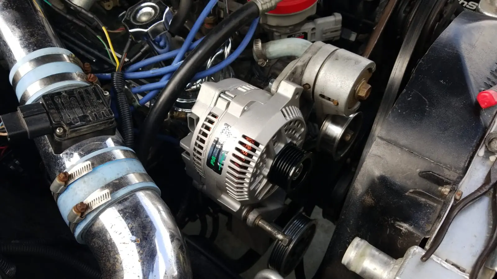

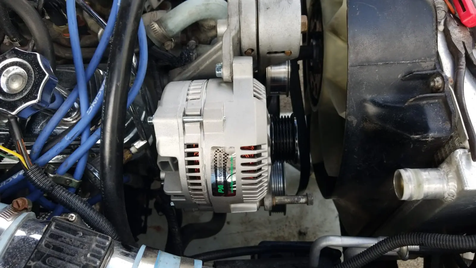

When I took the car for a drive, last night, I was disappointed to see low voltage. This morning, I found that the connector to the voltage regulator was loose & falling apart. I considered this the perfect reason to make a little upgrade, which I happened to have almost everything I needed and that's what I'm working on, today:
I figure that I'll go ahead and install that 185* thermostat, while I'm at it. I really think I figured out the cooling issue *fingers crossed*, and I'd like to have some heat so I can keep driving it, this winter.

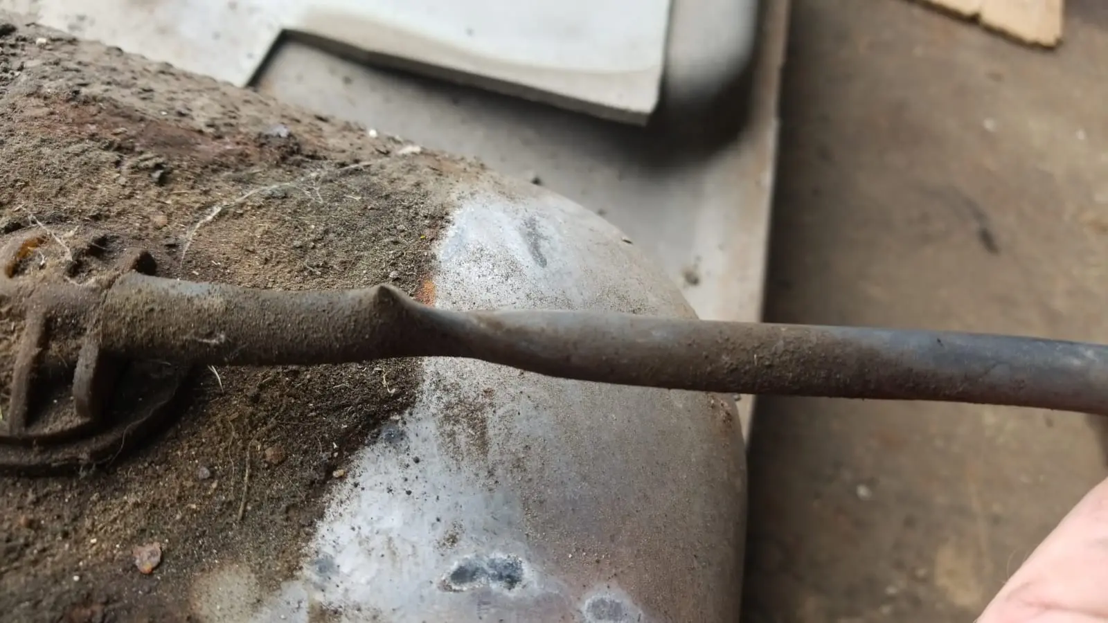

Well, I dropped the tank today and may have found 2 problems I've struggled with.
Gas Vapor smell resolved, I think...
I dropped the tank and found the vent tube pointed straight forwards. The floor pan is designed to give room to the fuel tank, but obviously the clearance to the front was not sufficient for this orientation. It should be pointed to the passenger side, IMO. I replaced the line, oriented it correctly, and ensured it was not being pinched when I reinstalled the tank. I really think this has cleared up my fuel smell issue.
I used an air hose to blow off corrosion and debris from the exterior of the tank. The interior of the tank looked very clean. So, no need to replace it. The underside of the car needed a little help, just like everything else. I hit it with a wire wheel and some paint. Now, I feel like I've pretty much hit every part of the floor pan from front to rear. The car's back in good shape, regarding cleaning and rust prevention.

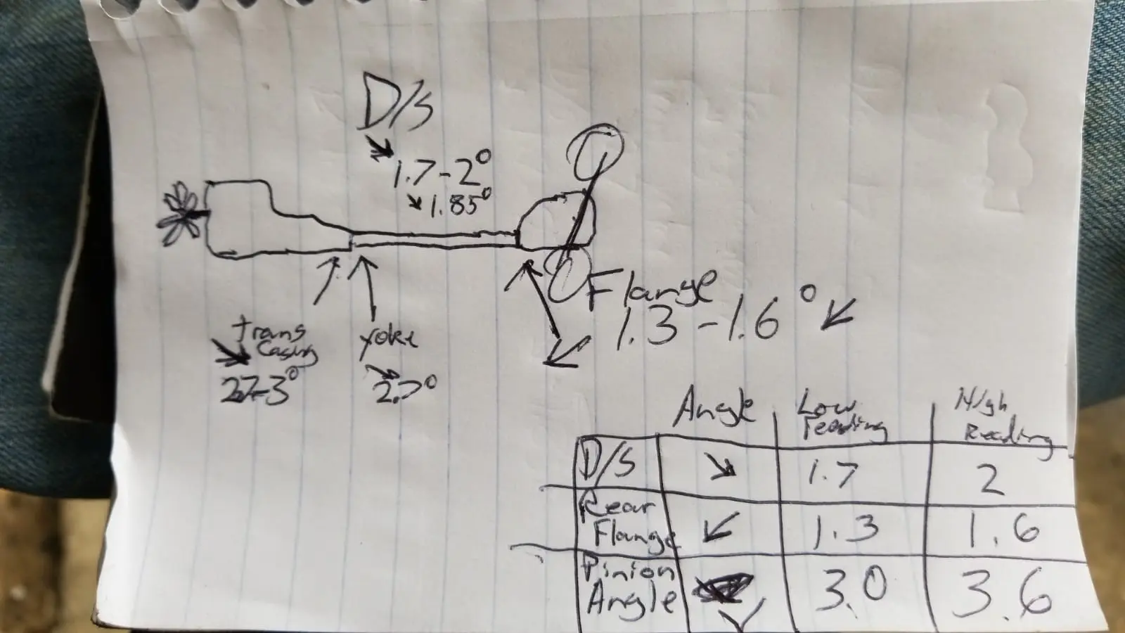

I finally got it onto a car lift where it's on all 4 tires, and measured the drivetrain angles. I used straight edges to help me get the angle cubes where I needed them. I sketched out the angles, and I suspect this is far enough out of tolerance to cause the vibrations I've been feeling.
In case it's hard to make out my chicken scratch, I'll try to interpret in text format. I took many measurements at each point, because it really isn't easy to be consistent when holding a straight-edge in one hand, an angle cube in the other hand, and try to get it angled correctly in 3 axes. So, it wasn't all that consistent, and the diff's flange was so hard I ended up pulling the rear of the driveshaft off to get more exposure to the flange's surface. Anyways, the rear of the trans casing where the yoke slides in measured 2.7-3* downwards in the direction of the rear of the car. The driveshaft measured 1.7-2* downwards towards the rear of the car. The rear flange measured about 1.3-1.6* downwards towards the FRONT of the car. Thus, the pinion angle was a 'V' with a 3-3.6* angle.
This tells me that the solution to my problem is either to get upper control arms that will extend longer than the non-adjustable s that are currently on the car, lowers that I can shorten, or some combination of both.
I'm thinking that the engine and driveshaft angles are ok, as is. They're only at around 1* difference, relative to each other. Of course, the driveshaft may come up a bit when I adjust the rear diff. But even another 1* would still leave the front yoke to D/S within tolerance.

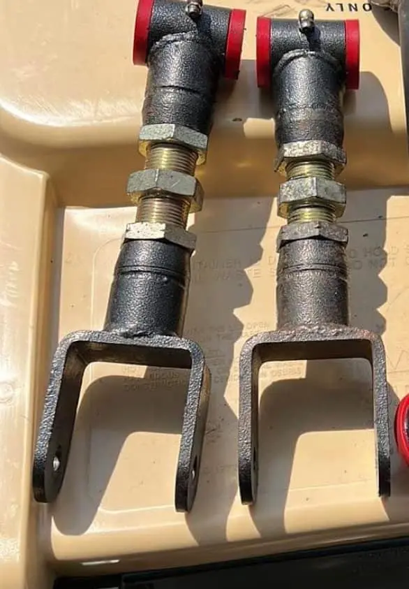

Team-Z, maybe? But are they long enough?
But then I find what looks like the kind of Team-Z products I'm used to. I think the stuff above is some kind of third party manufacturer after Team-Z went bigtime and the one I've found on the marketplace below as the in-shop work they used to do:
Those older ones look more adjustable and more stout. I'm going to try for them before ordering the newer skimpier-looking ones.

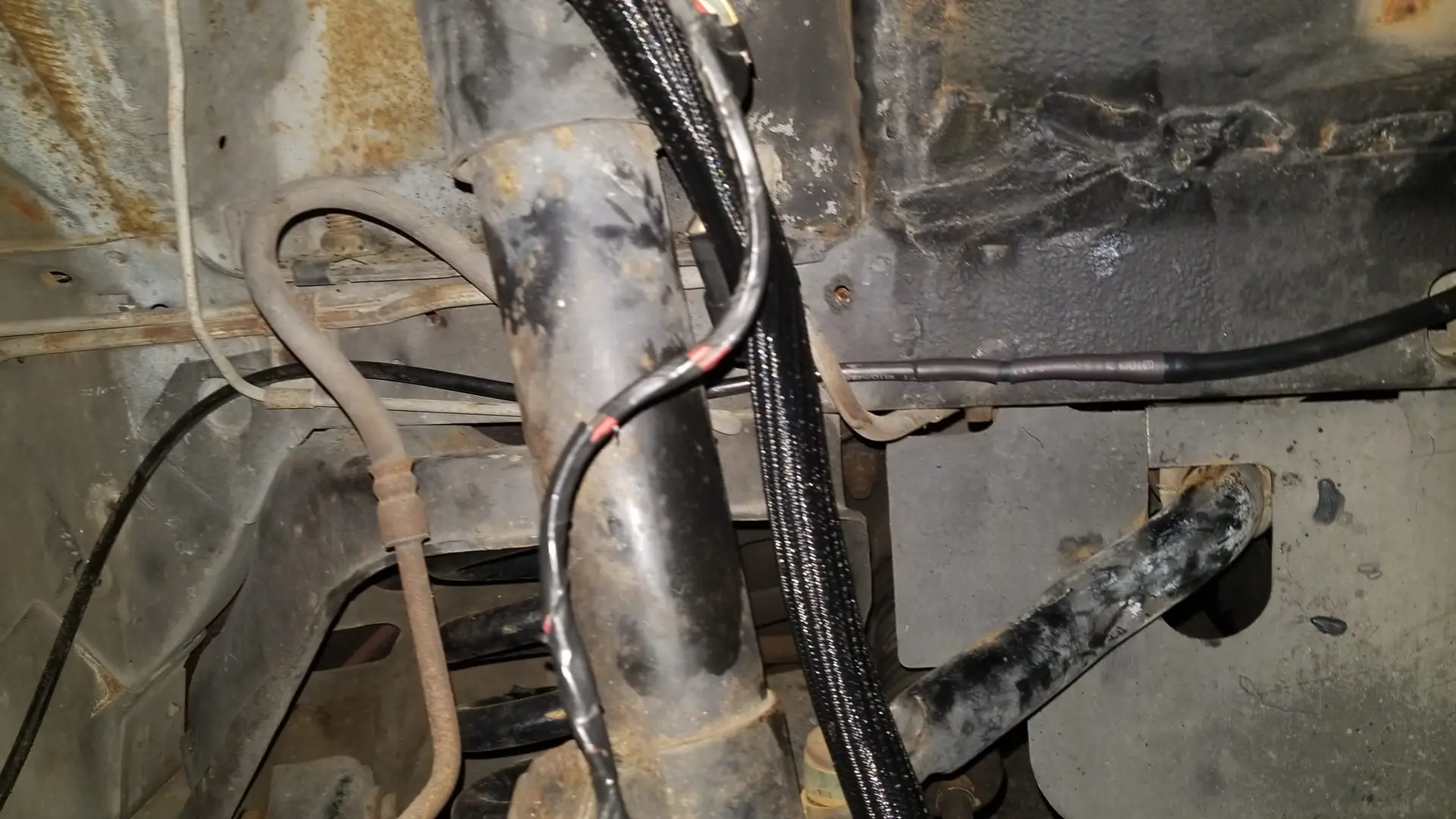

Wire tuck in progress... pics soon
Replaced stupid-looking chrome-but-corroded antenna plate.

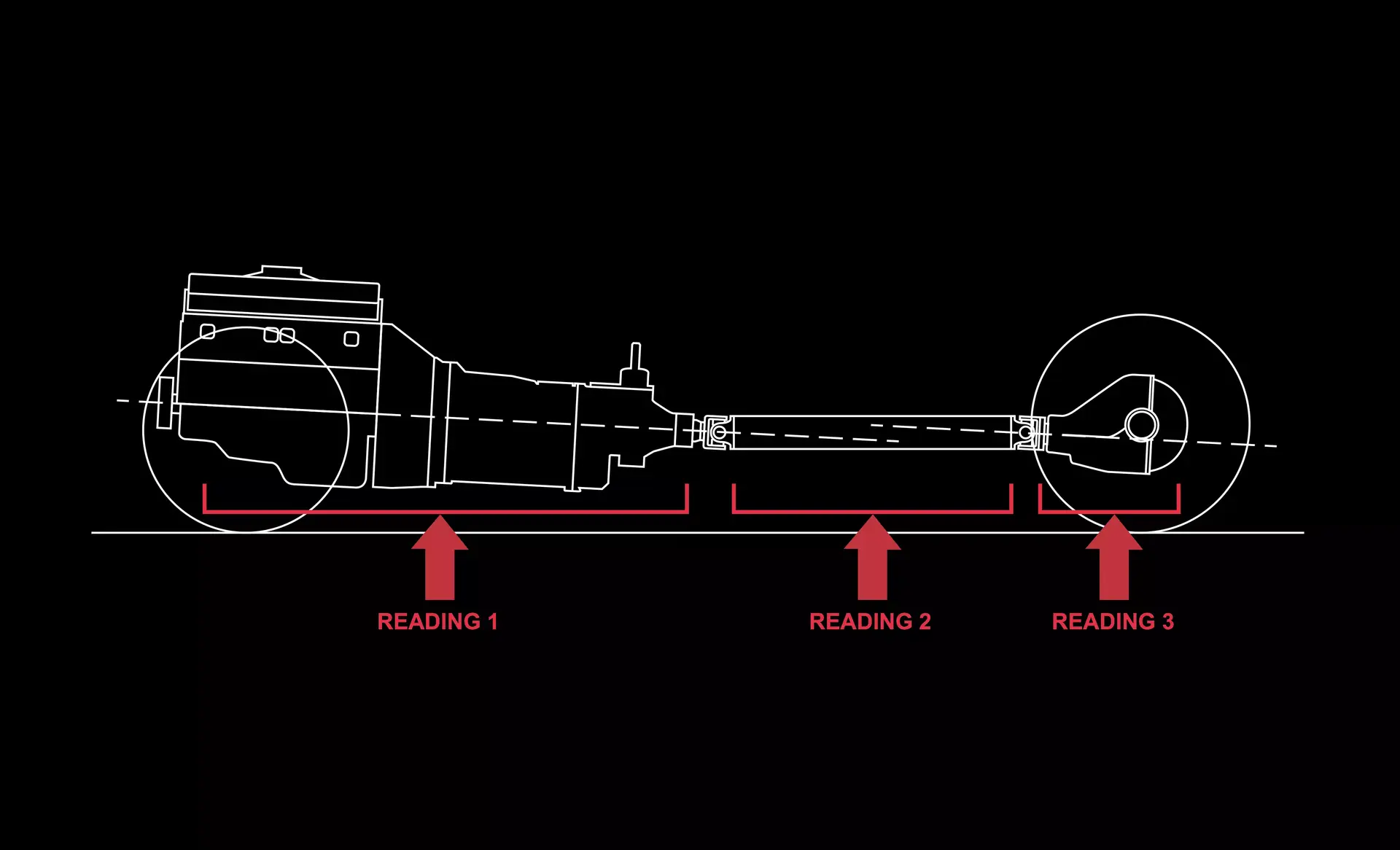

- Engine/trans angle (Reading 1 in the diagram in post #130 above) should be approximately parallel with the rear diff/pinion (Reading 3).
- The angle at each u-joint should be ~1* when you have polyurethane bushings
- Originally Engine trans measured nose-up 2.7-3*
- my driveshaft measured nose-up 1.7-2*
- my pinion measured nose-down 1.3-1.6*
- Thus pinion angle was ~3-3.6* (very bad)
- Engine/trans were out of parallel from the pinion by ~4-4.6* (very, very bad, apparently). I was sure after the previously posted video that this was my culprit

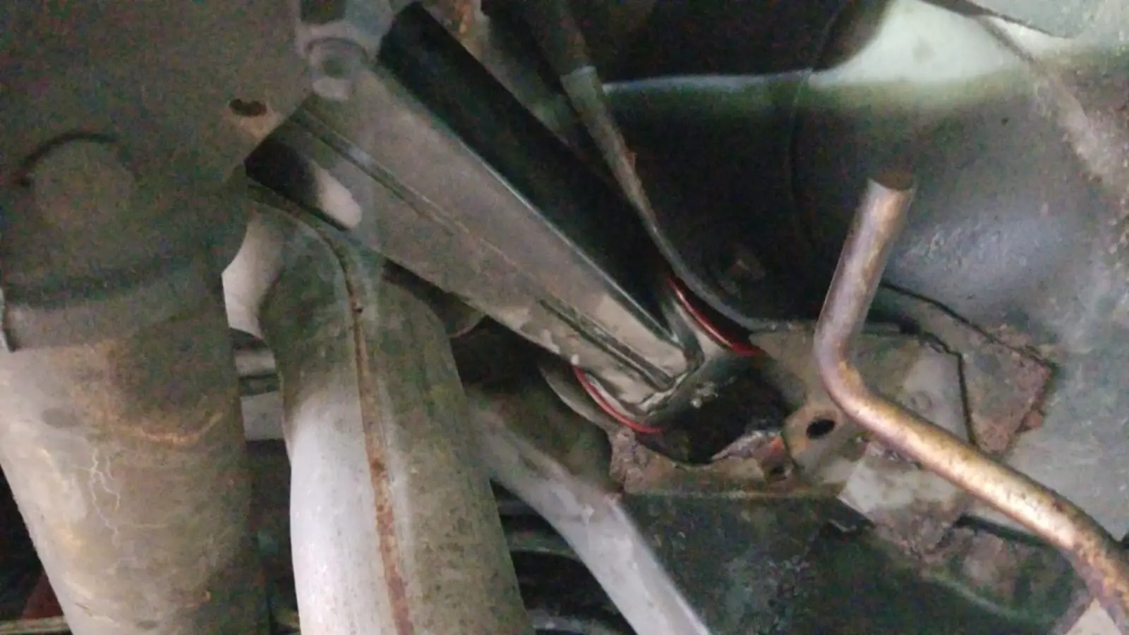

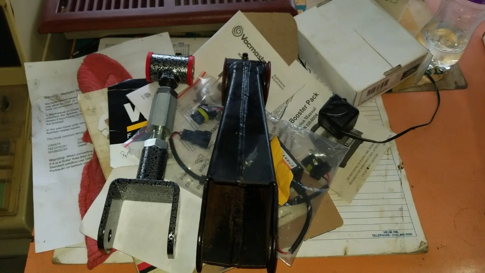

New upper control arms:

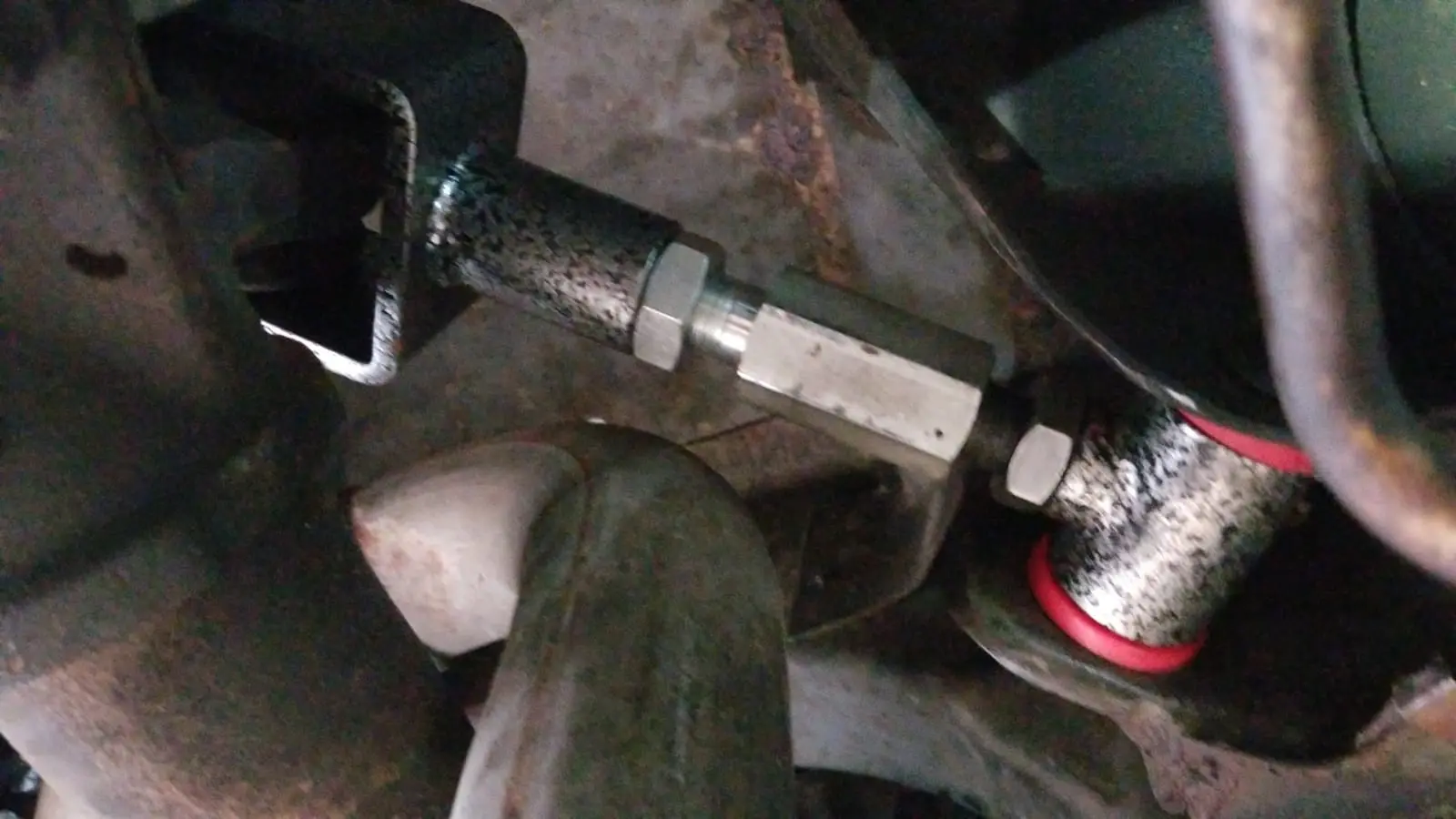

First, let me just say that while I was disappointed with the advertised pics of the Team-Z control arms in comparison with other parts of theirs on my other black car, the actual parts look much better than the advertising pics... They're really doing themselves a disservice with those ad pics, IMO. Here's what they look like in comparison to the BBK 'gripp' UCAs that came off of the car:
The pic may make those threads seem a bit small, but after using them and adjusting things with them, I have no concerns whatsoever. They are very stout.
Now, UPRs Pat Casey claimed that the stock upper control arms are supposedly 9 3/8". I wouldn't know but the BBK Gripp UCAs were only 9 1/4", as best I could measure. I set the Team-Z UCA that way to assist getting them into the car. However, I still came up a bit too long:
Now, maybe the rear moved a bit to cause this on the install, but regardless, the Gripps were just not long enough and could not compensate for how much the car is lowered in the rear. Side note: lowering the rear pushes the differential nose-down, because the UCAs are shorter than the LCAs. The Team-Zs did have enough extension range to get me back to where I needed to be in the end. I was concerned before-hand that I would hit the end of the extension range and then would need to purchase adjustable LCAs, too. That was unfounded.
Here's a before/after of the gripps vs. the Team-Zs. It's a shame these will never been seen by anyone other than maybe a mechanic on a lift:
