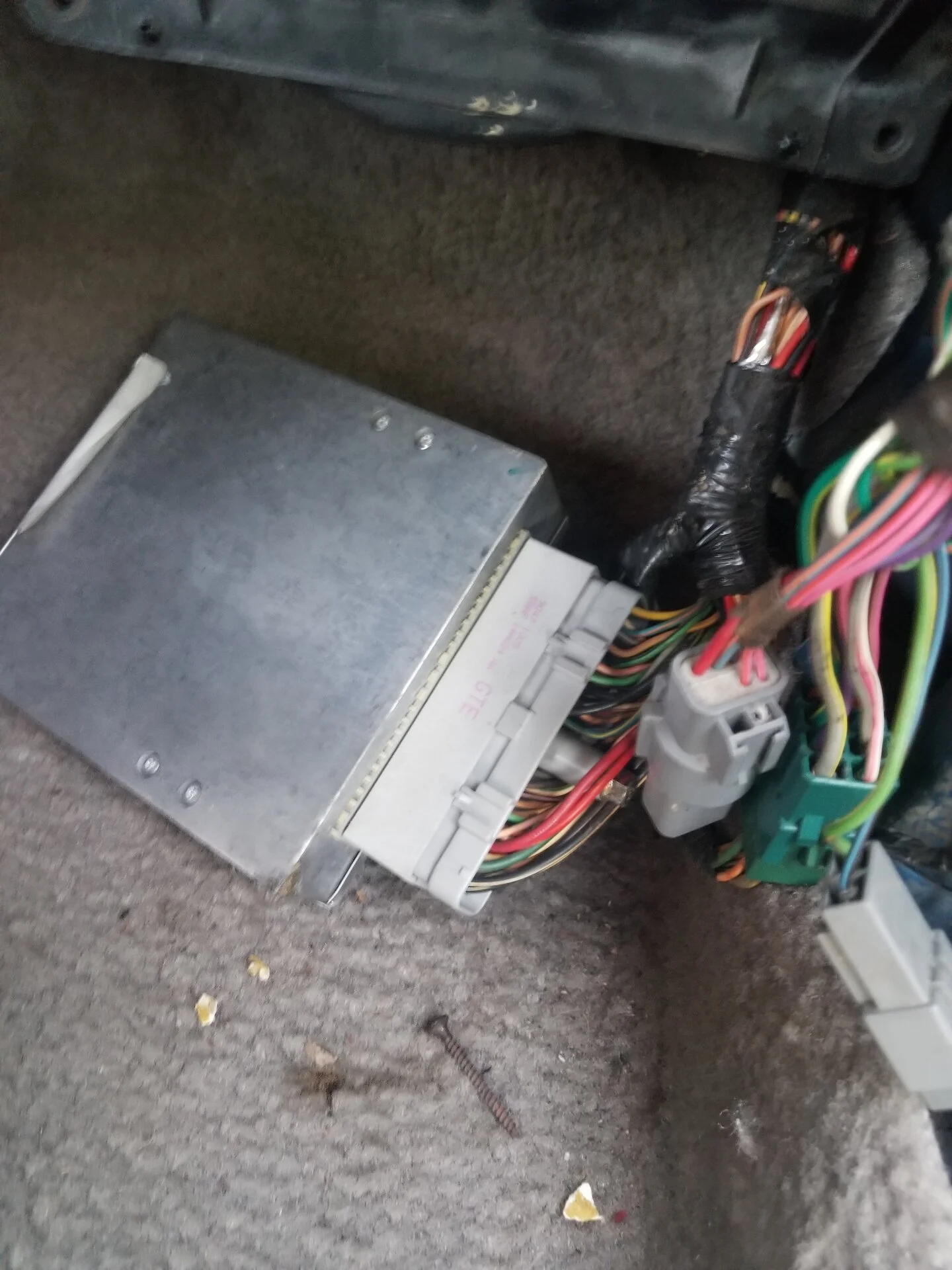

Haven't done much troubleshooting lately, just driving the stang here and there. Randomly dies every once in awhile.
After many passing codes(11), we've picked up a 14.
That is the computer. We haven't tucked it up behind the dash due to all the troubleshooting we've done in the passed few months.
Today I ran to tracker supply to pickup fuel for the grill and I asked my daughter to ride with me. As we sit in the driveway at idle the car died. The car wouldn't restart. I see my daughters foot on the computer. She moves her foot from the computer and the sob started right up. I was like what the hell! I start the car and slightly move the computer, died. Repeated this multiple times and some while in gear.
I'll leave you with that.
Have a good evening.

Most likely a wire is loose or pulled out of the connector
Processor itself is most likely okay
Good luck
Take a six cell mag light and inspect the female pins in the connector and make sure they are all ok and in position
Reactions: 1 user

If I was you, I would treat your daughter to something good because she saved you a ton of head scratching and stress.. Jingle each individual wire in that harness to the ecm until you find the culprit if you can't visually see the problem easily

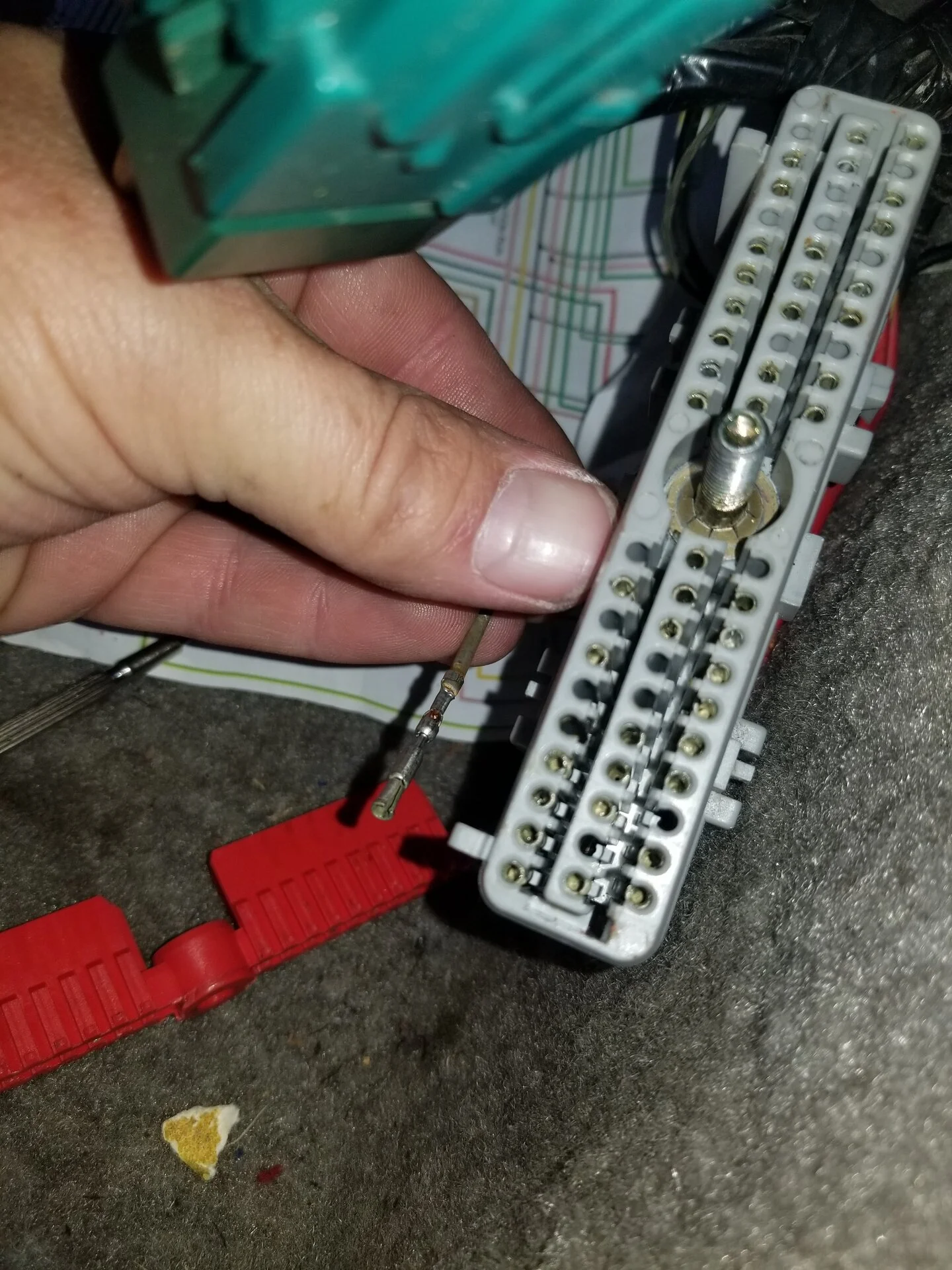

Well we've found a loose connection. Pin #56 PIP. Give a little tug and she ain't happy about it.
Now i can't help but wonder how many more are like that and with that I have a question.
How do you release the wires on the connector??
Reactions: 1 user

Great job
You saved yourself several hundred bucks
Do tuck that processor back away now
Now you can enjoy your Mustang again

Just updating the thread. I've been driving the stang like it was my daily. Taking to on longer runs to get temps good and warm. Basically try to get the car to chit the bed.
All is good. KOEO passes every time. The loose connection was the issue. Car runs super smooth. A true joy to cruise around in even though it looks like a turd. We'll start to begin body work this winter it seems. Thank you for the help and responding to my problem.
