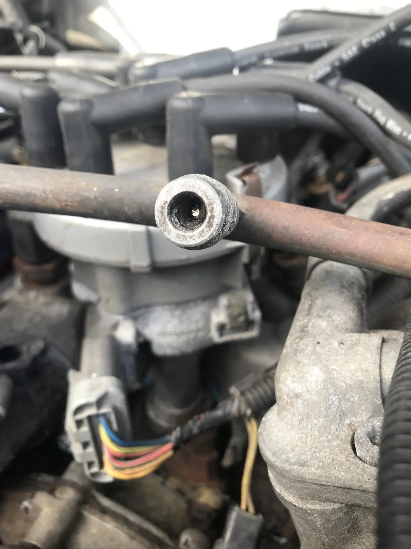

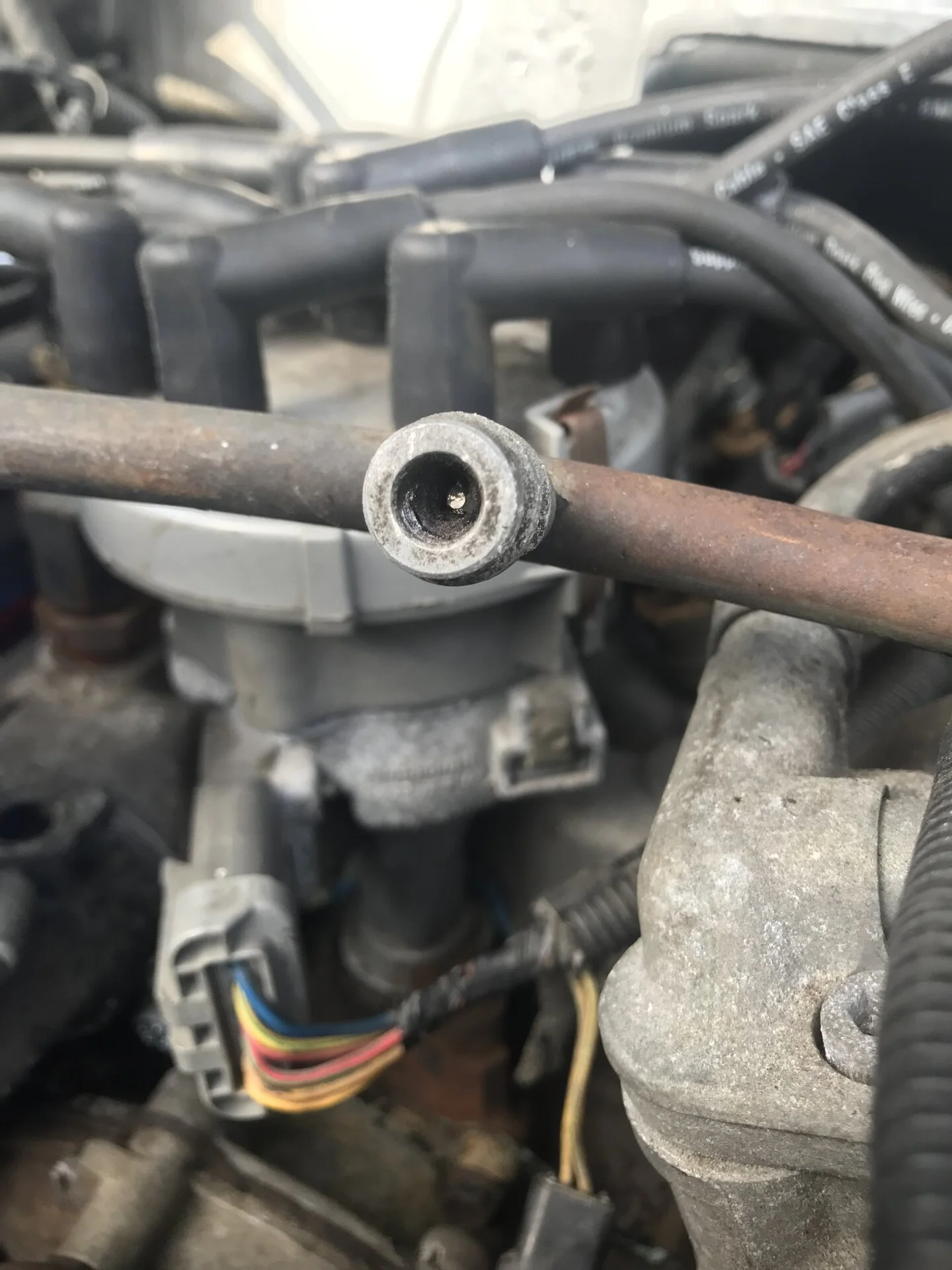

Can your multimeter read amps in DC up to 10A? What does that added on relay go to?
I'd start first by dumping codes and see what the ECU doesn't like at the momemt.

Can’t see, but from the oxidation it looks original.
Is there a sticker on the side that says GAY? Serious question. Some oem distributors have this label.

It says Motorcraft on it for sure in two different locations. I will check for the "GAY" sticker also....
