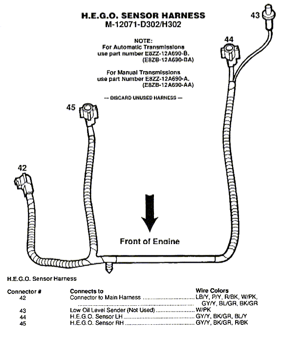

When I got my car, the o2 sensors weren't even connected. pretty much I need to redo all of them, but I don't know where they are suppose to plug into and im guessing there is suppose to be some kind of harness that goes down to them that I don't have either.. Does anyone know where I can get a new one of these, and where they connect to the main harness at?

See the following website for some help from Tmoss (diagram designer) & Stang&2Birds (website host) for help on 88-95 wiring Mustang FAQ - Engine Information Everyone should bookmark this site.
Ignition switch wiring
Vacuum diagram 89-93 Mustangs
HVAC vacuum diagram
TFI module differences & pinout
Fuse box layout

Alrighty thats what I needed thanks
