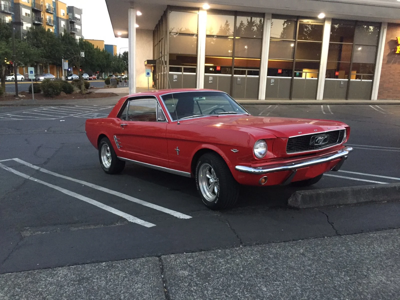

Drove my '66 coupe this summer and put it away for the winter (no rain shall rust my baby!). A while ago, I was given a '65 A-code engine from a GT and would like to rebuild it myself and swap it for the 289 currently in the car. I'm proficient with my hands and my ability to learn anything I need to complete a given task and have a garage with the necessary tools so I'm not questioning the feasability just the decisions to be made. Been reading endlessly and thinking about how I want to go and I wanted to solicit your thoughts!

Here she is:
