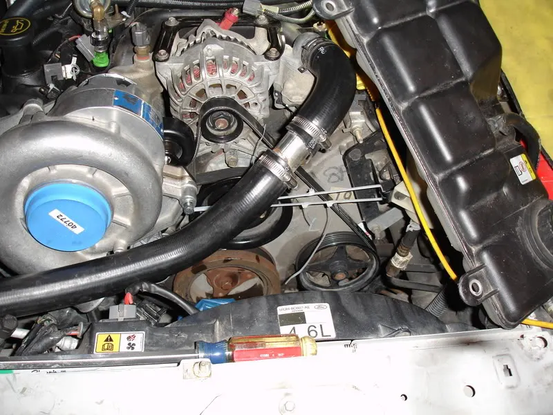

so I got the belt on, Benny gave me a great idea, and I took it and ran with it a little.
I used zip ties to hold the tensioner in place like so-
It got my where I needed to go, minus a couple millimeters. I took a screw driver and pried the belt on over the alternator pulley- I was STOKED I did it all by myself!
