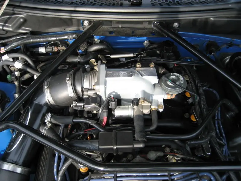

I just picked this up myself and installed it recently using the stock tb, although I spent the extra 10 bucks and got the powder coated version so it will stay cleaner - longer. I'm looking to pickup a TB in the near future to go with it, but I felt a gain with just the plenum. All the tests I've seen, there is only a couple of hp difference between the brands. The Fit and finish were top notch and Summit is always great to order from. Here it is freshly installed. Sits quite a bit higher than stock.
