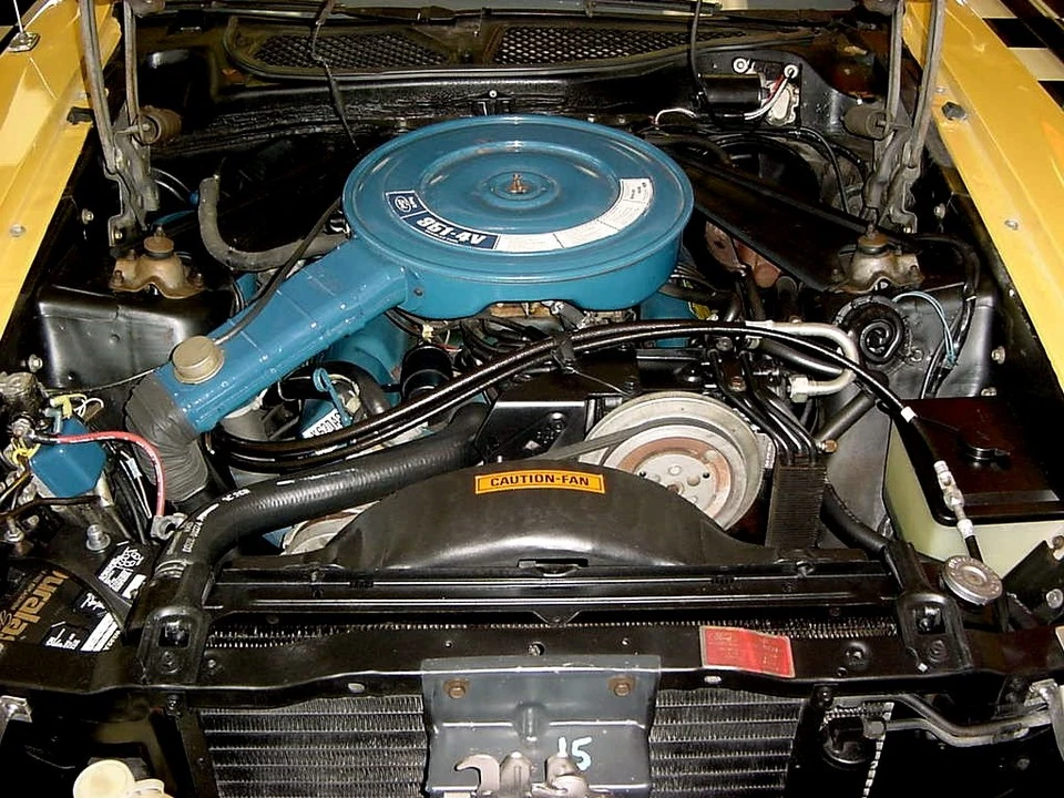

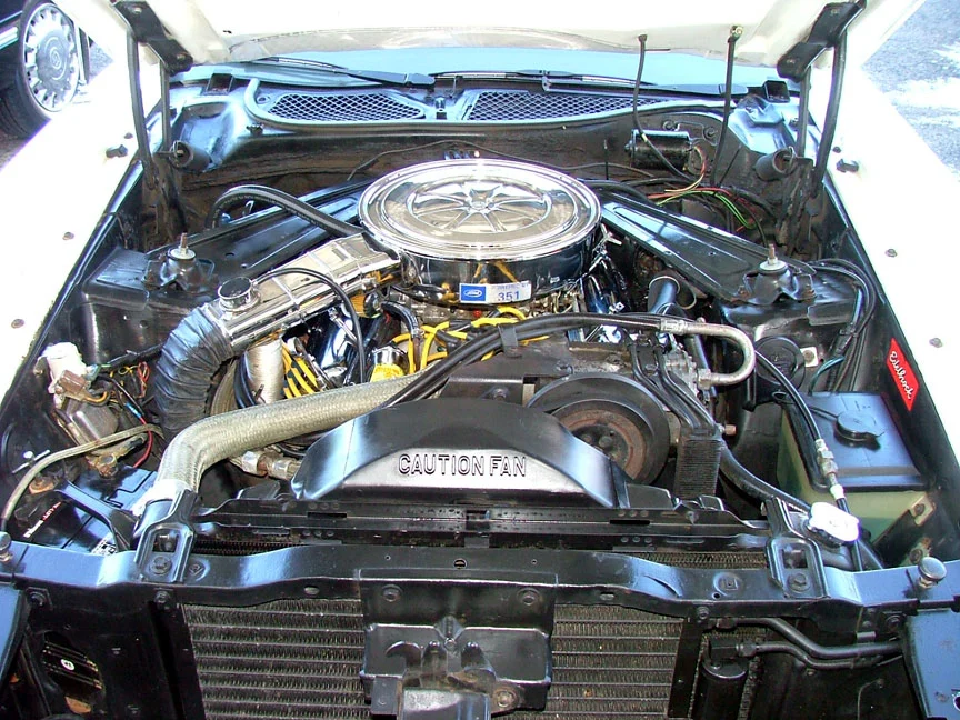

Got pic's?
I'm mounting one next week, so I would be glad to get some hints.

Jul 26, 2009
  • Jul 26, 2009
http://www.boss351registry.com/Car-Images-1/Concours BOSS 351 Engines/wilson1-engine.jpg
http://www.boss351registry.com/Car-Images-1/Concours BOSS 351 Engines/wilson-engine.jpg

Thanks. Geeee.. I would never imagined
BTW: Nice engine compartment !

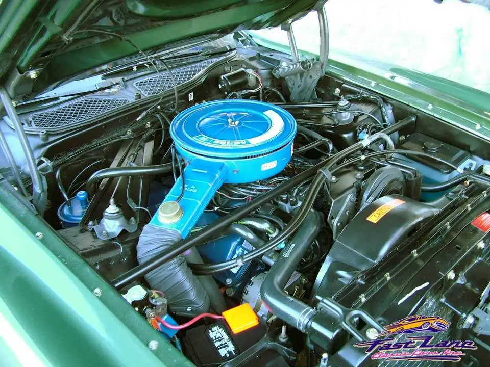

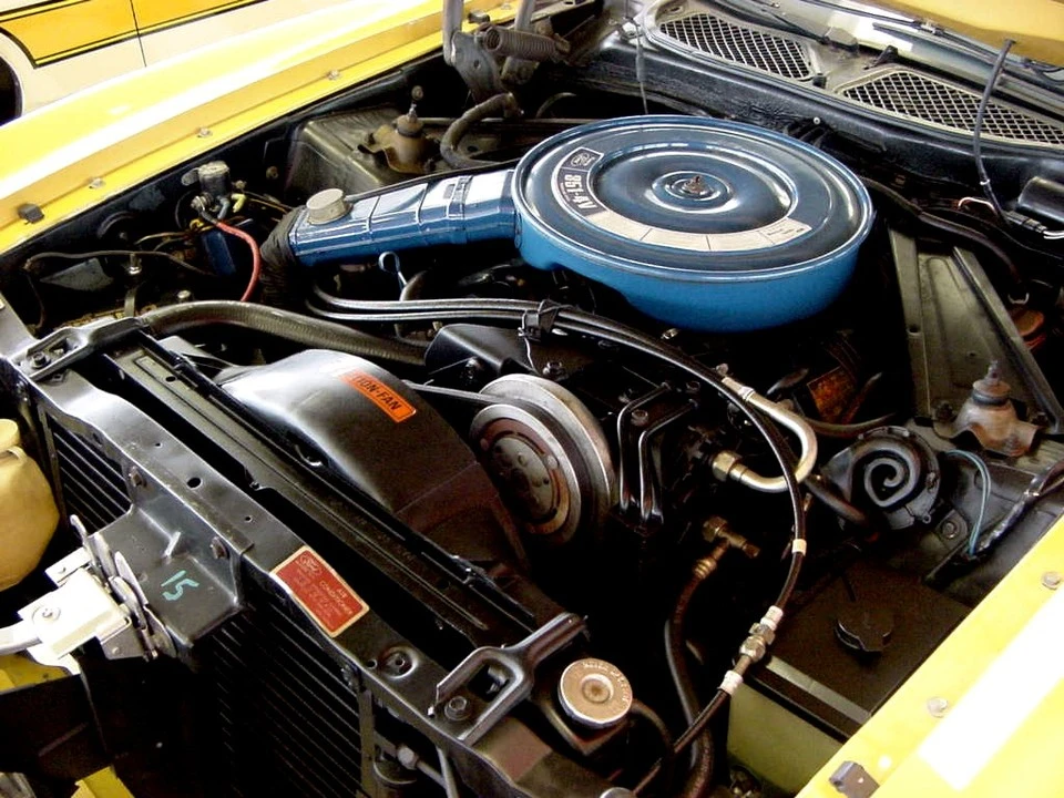

I can't help thinking that the power-steering cooler was only intended for A/C equipped cars. I don't really know, but without the A/C, the cooler looks like dung IMO.
Though 71-73s are different in many ways, I suspect they are the same when it comes to the power steering cooler installation (if so equipped) on A/C equipped cars. Here are a few pictures I've collected over the years:

Thanks those pictures were more help than you will ever know.
