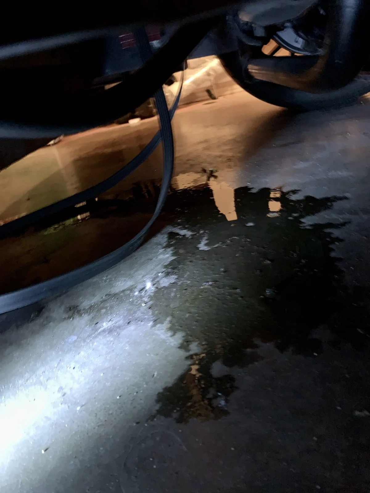

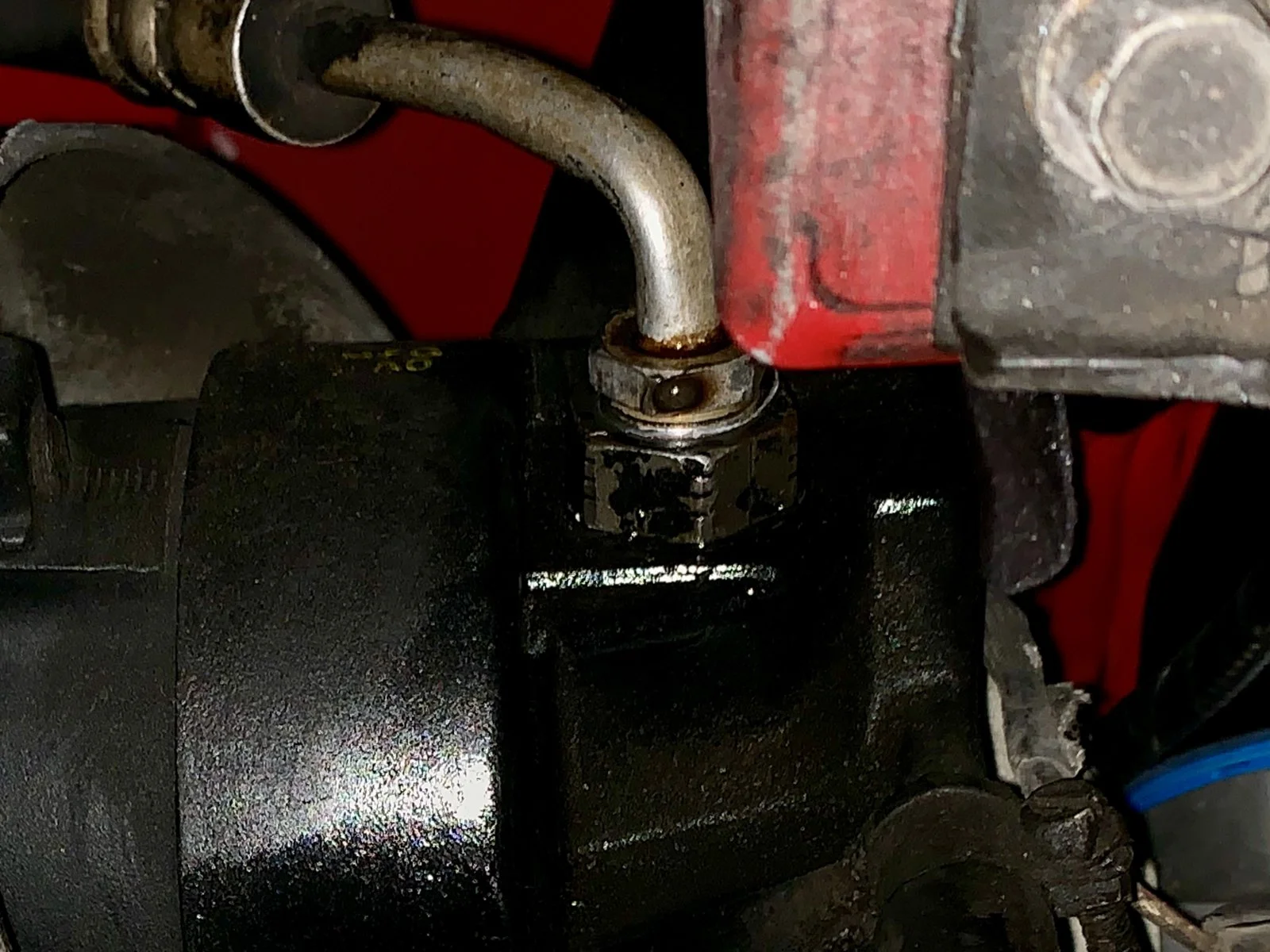

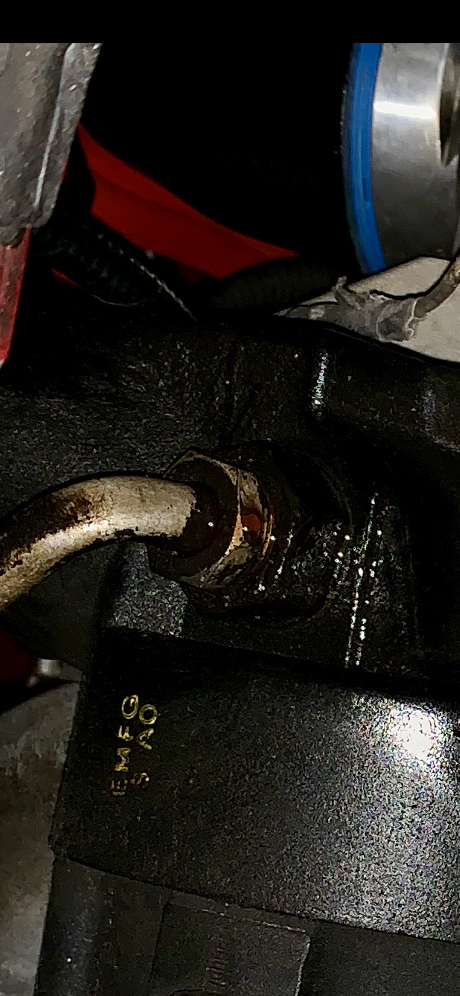

I had a small leak on my PS pump, then all of a sudden i was removing the front ac bracket to clean it up and paint it, when I noticed that it went from a small leak to a decent splooge. I can see it leaking from the pressure hose where it connects to the pump but other than that everything else looks good, and my connections at the rack are good since it was swapped to a 03 cobra rack. Could it just be a bad o ring or something or should I just replace the pressure hose. If so how do i get the rack side off? Also if I do this what do I do about the fluid? Can I swap this fast enough with out losing the fluid or do I have to do some sort of flush?
Go back and read my previous post about rack replacement. All the answers to your questions are in there.

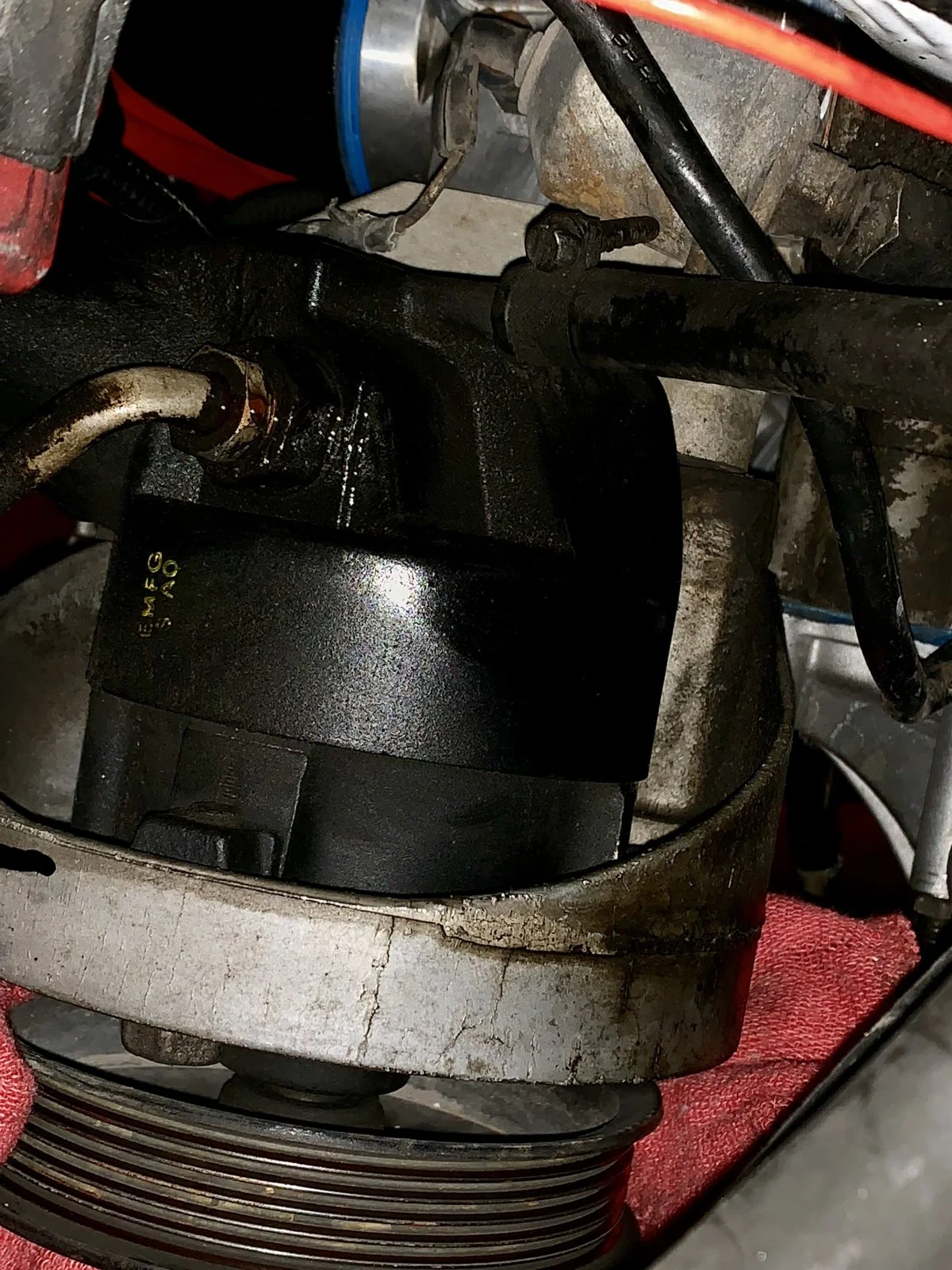

Alright so unscrewed the side on the power steering pump, and the big side piece and cane out along with the hose. Is this where you are talking about the O ring? I replaced the white Teflon o ring, got everything screwed back in, filled the reservoir and let it sit over night. I didn’t start the car and let it run as of yet, but over night it still managed to leak from the same area it was. A small leak but still leaking.

Did you separate the hose from the fitting? If not check the fitting on the end of the hose for cracks, I believe there is no o ring between the two, just on the fitting going to the ps can.

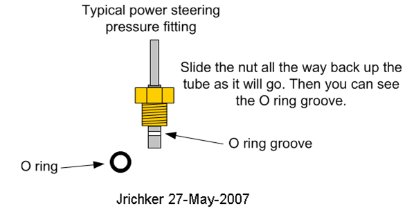

The O ring is in there, you have to slide the nut up as far as it will go before you see the O ring.
I once had a leak in the same place and never could get the correct size O ring. I ended up replacing the hose assembly and that fixed the leak

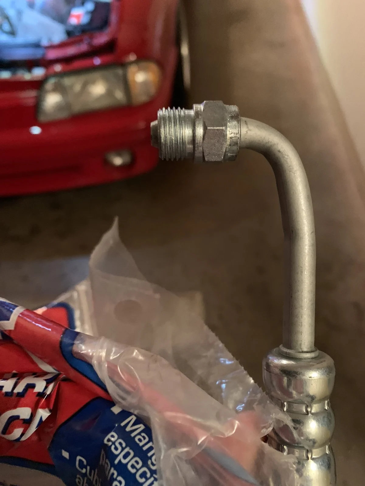

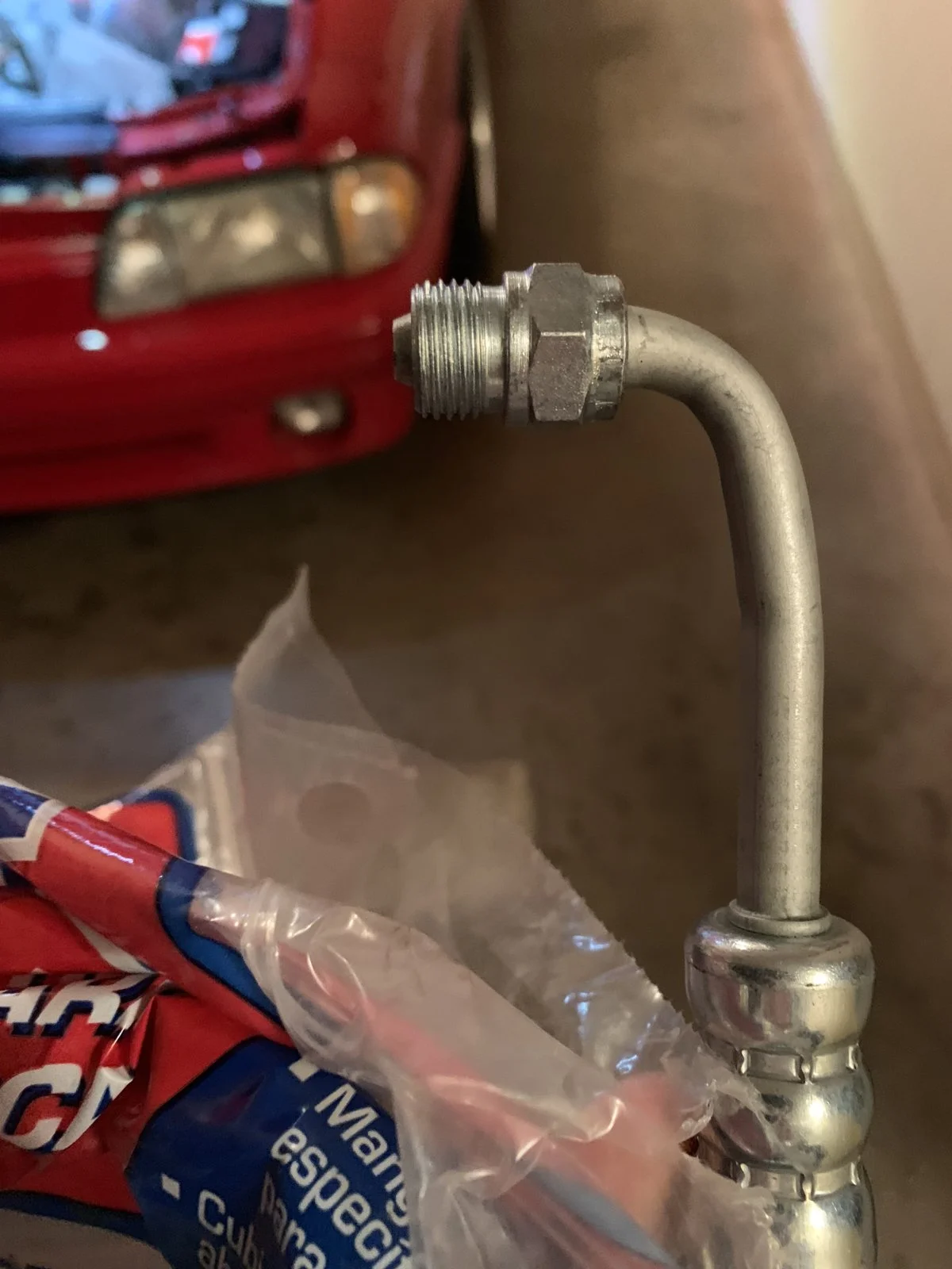

I didn’t disconnect the fitting from the hose, didn’t know it could do that. I bought a new pressure hose from autozone but just took the white Teflon off of it and tried to replace it on my original one. I didn’t want to mess with getting the hose off the rack side.

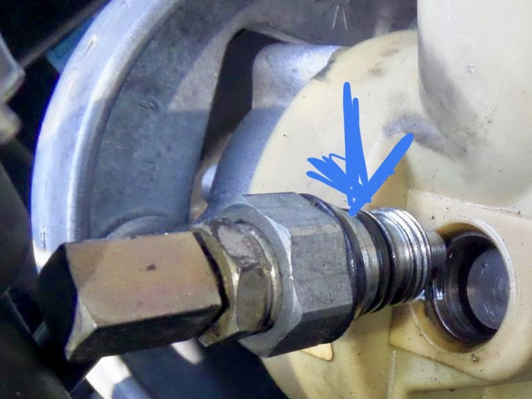

Ok so sorry don’t mean to be a nuisance, but I’m learning and trying to do this stuff by myself instead of just taking it to shops etc. it’s a slow process. So are you saying to push the fitting on the pressure hose all the way back, and an O ring will be there bc I tried to push the fitting on the new pressure hose I have back and didn’t have much luck unless I’m not giving it enough umph! When I disconnected the hose the fitting came out as hole with whatever the piece is that connects to the pump first. Is it the O ring there you are talking about with the blue arrow or there is also one inside the smaller fitting that screws into that one?
General karthief
Mod Dude
Aug 25, 2016
28,143
10,764
213
polk county florida
Nov 15, 2018
#16
  • Nov 15, 2018
  • #16
That pic with the arrow looks like it has two o rings.
Reddevil91
Mar 3, 2010
1,630
773
163
Nov 15, 2018
#17
  • Nov 15, 2018
  • #17
That is a pic a found online, it’s a taurus I think. It’s just for reference, but that’s how mine came out then I had to separate the two and screw the first one back into the pump after cleaning it up, followed by the hose. It did have an o ring there so that’s what I’m confused about. Is it that o ring, or is there also another o ring inside the fitting on the hose that screws into that piece?
General karthief
Mod Dude
Aug 25, 2016
28,143
10,764
213
polk county florida
Nov 15, 2018
#18
  • Nov 15, 2018
  • #18
Let me ask, does the ps line swivel or lock in place.
Reddevil91
Mar 3, 2010
1,630
773
163
Nov 15, 2018
#19
  • Nov 15, 2018
  • #19
From what I can tell it swivels, it’s not fixed
jrichker
StangNet's favorite TOOL
Mar 10, 2000
27,512
2,813
Dublin GA
Nov 16, 2018
#20
  • Nov 16, 2018
  • #20
The diagram in the first post shows how it looks. The Teflon ring goes over the threads. Because of the bend in the tube, it may be very difficult to slide the nut back far enough to see the O ring.
