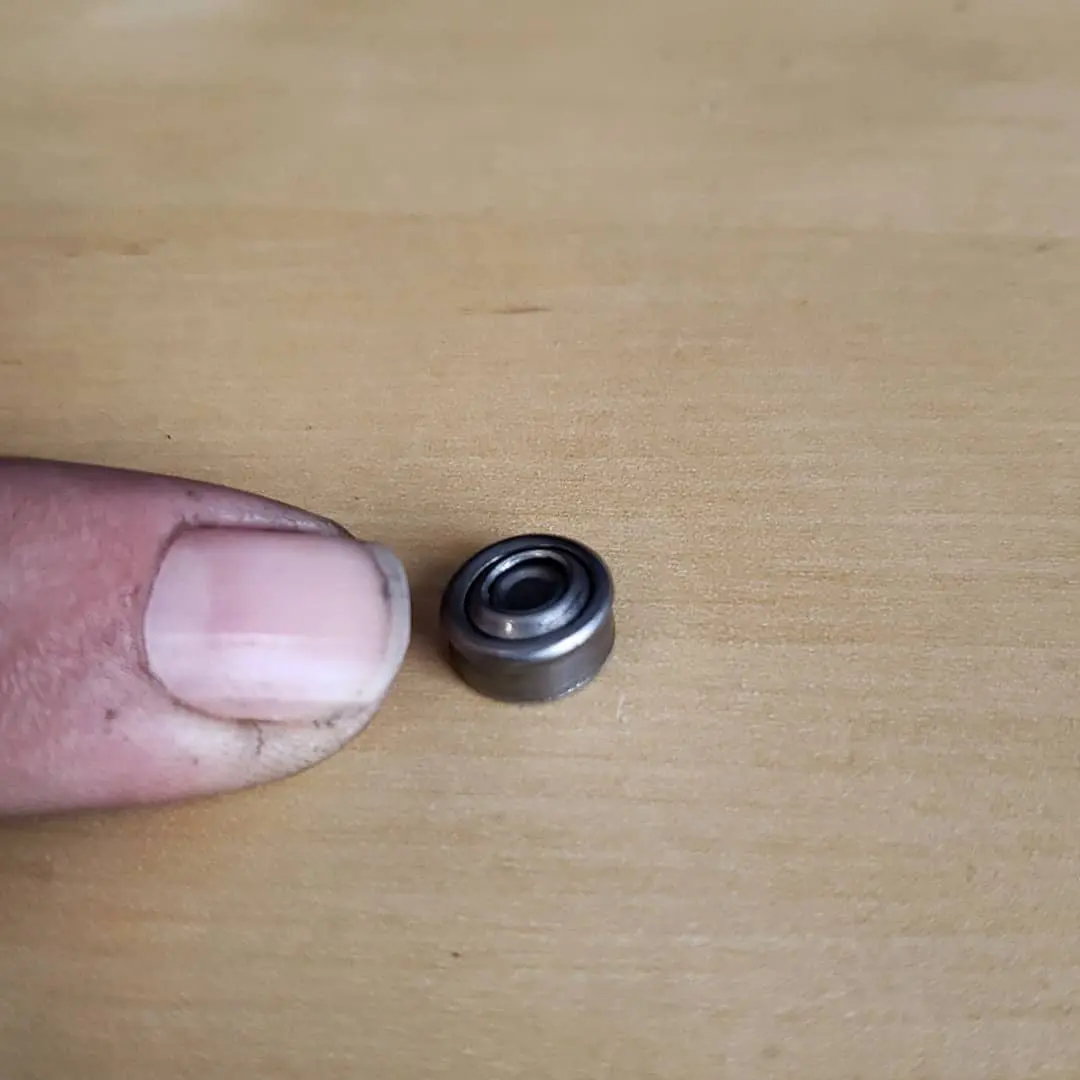

That is the check valve on a Ford steering rack. This little piece of metal has cost me a lot of heartache and three power steering pumps over the past few weeks.
I took it out (I know Ford says it is required) until I can get the refurb rack I have put in.
