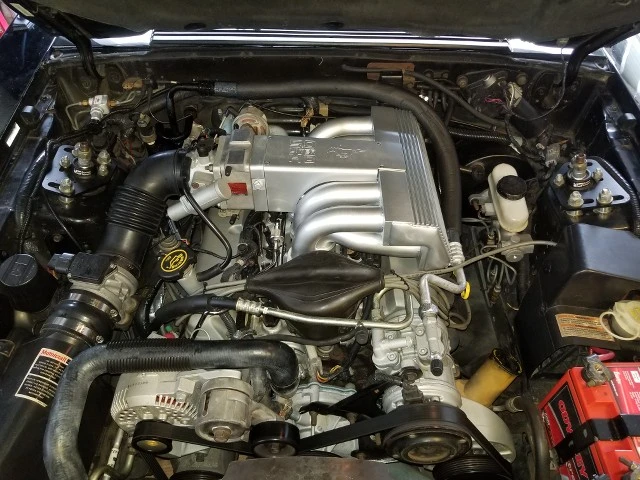

Thanks man, yeah I had the LX light on for years. It is a really clean look, but just been wanting these new lights for a minute to do a little change up.Mine are way different. 90 LX...Looks good
I agree. The orange on the lenses we have adds a hint of color. I would run the graters if I had some, but I would probably swap them out every once in a while. But I do like my 83-84 lenses.Thanks man, yeah I had the LX light on for years. It is a really clean look, but just been wanting these new lights for a minute to do a little change up.

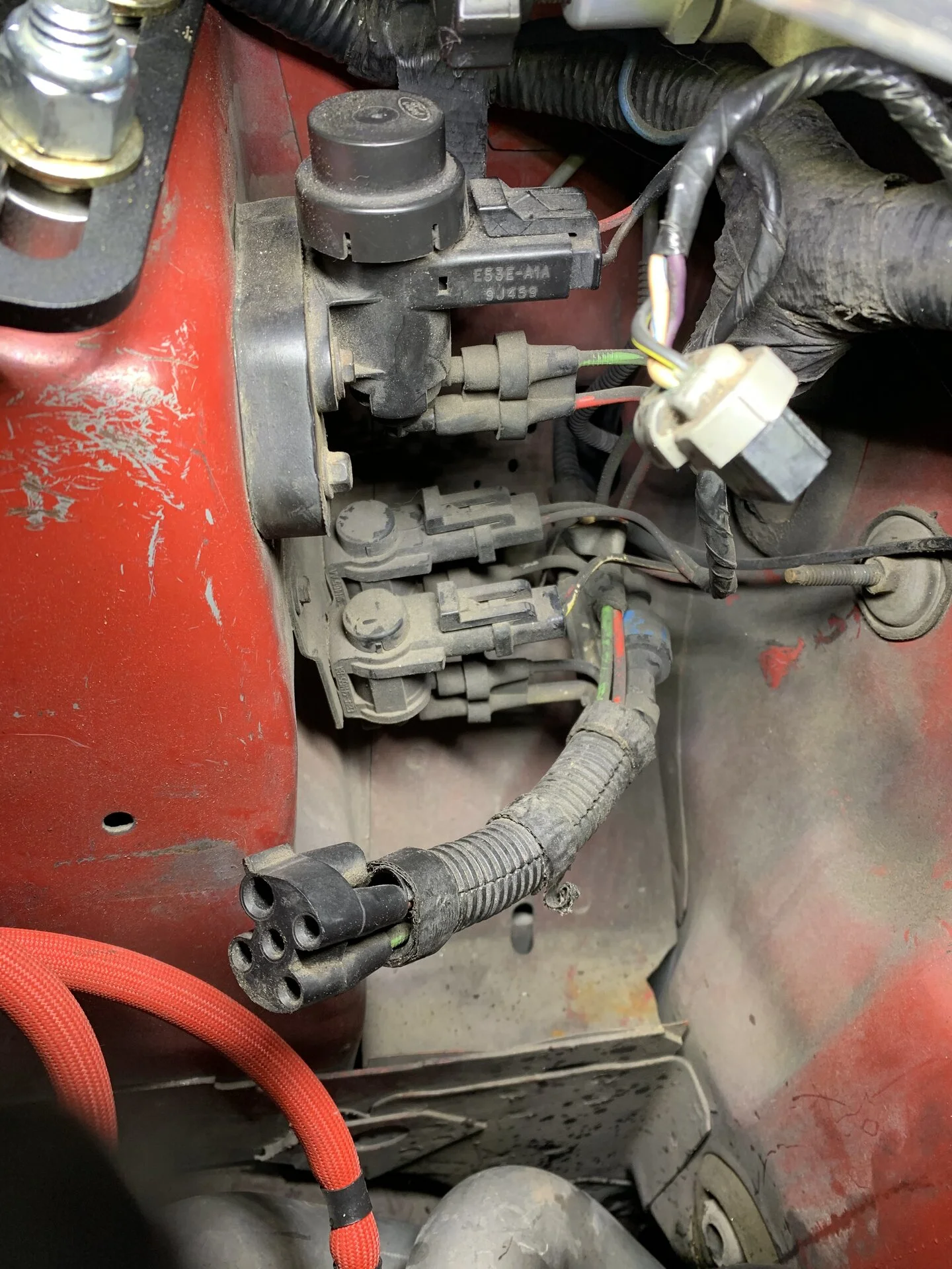

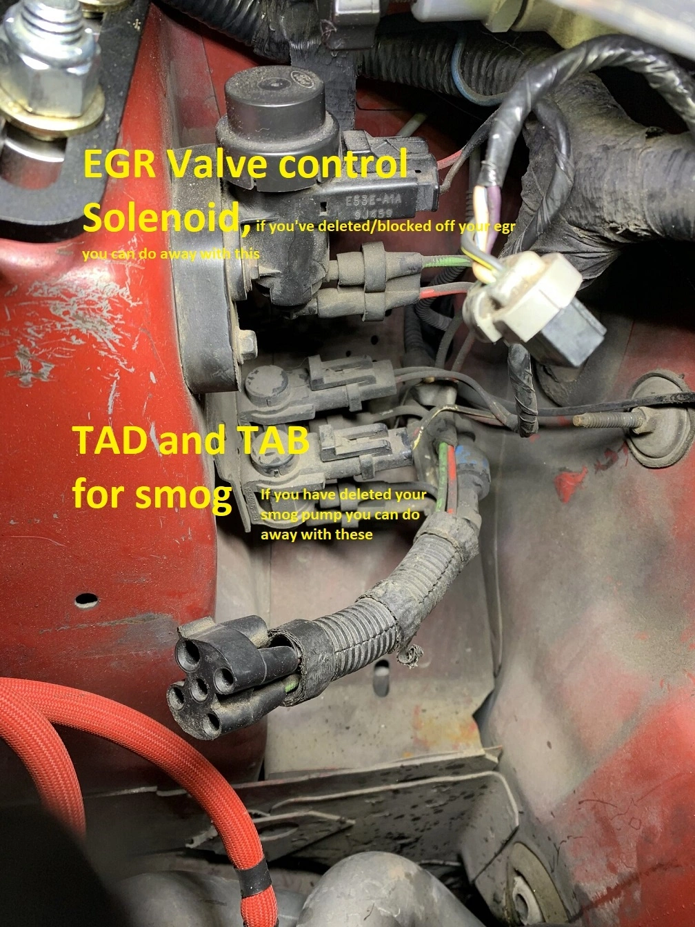

Niiiiccce! thanks man that made it very easy lol. #Cliffnotes for foxbody dummies!!! Appreciate it!made it easy for your

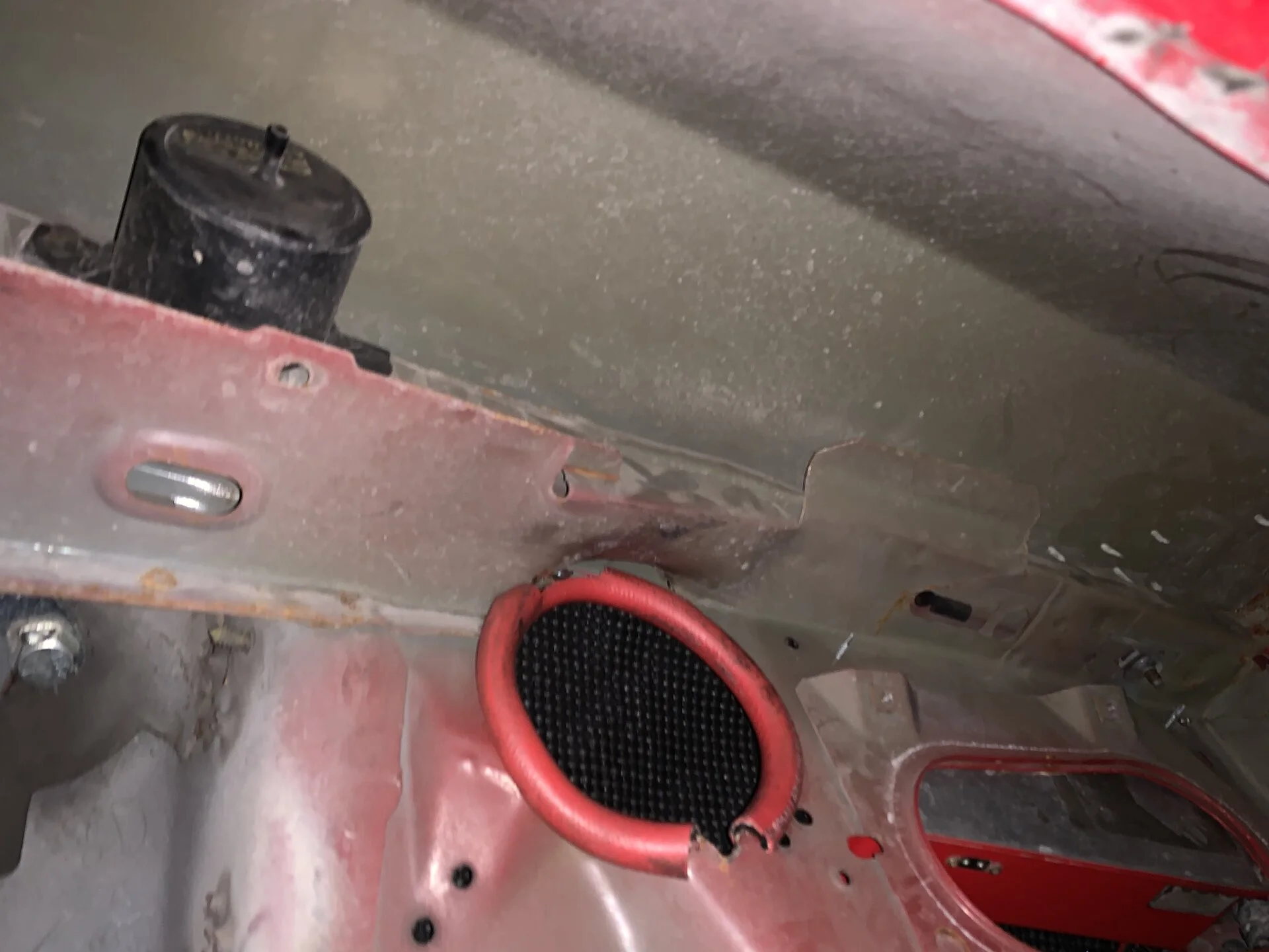

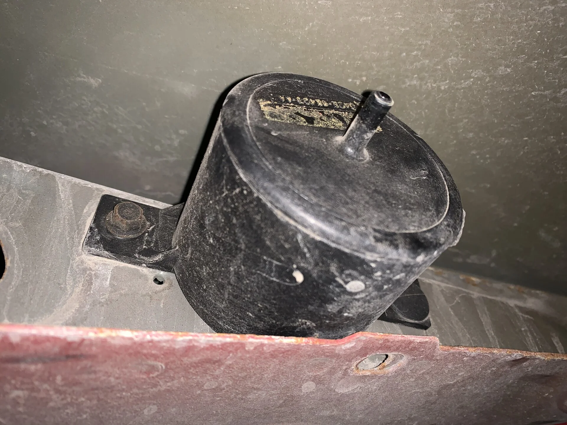

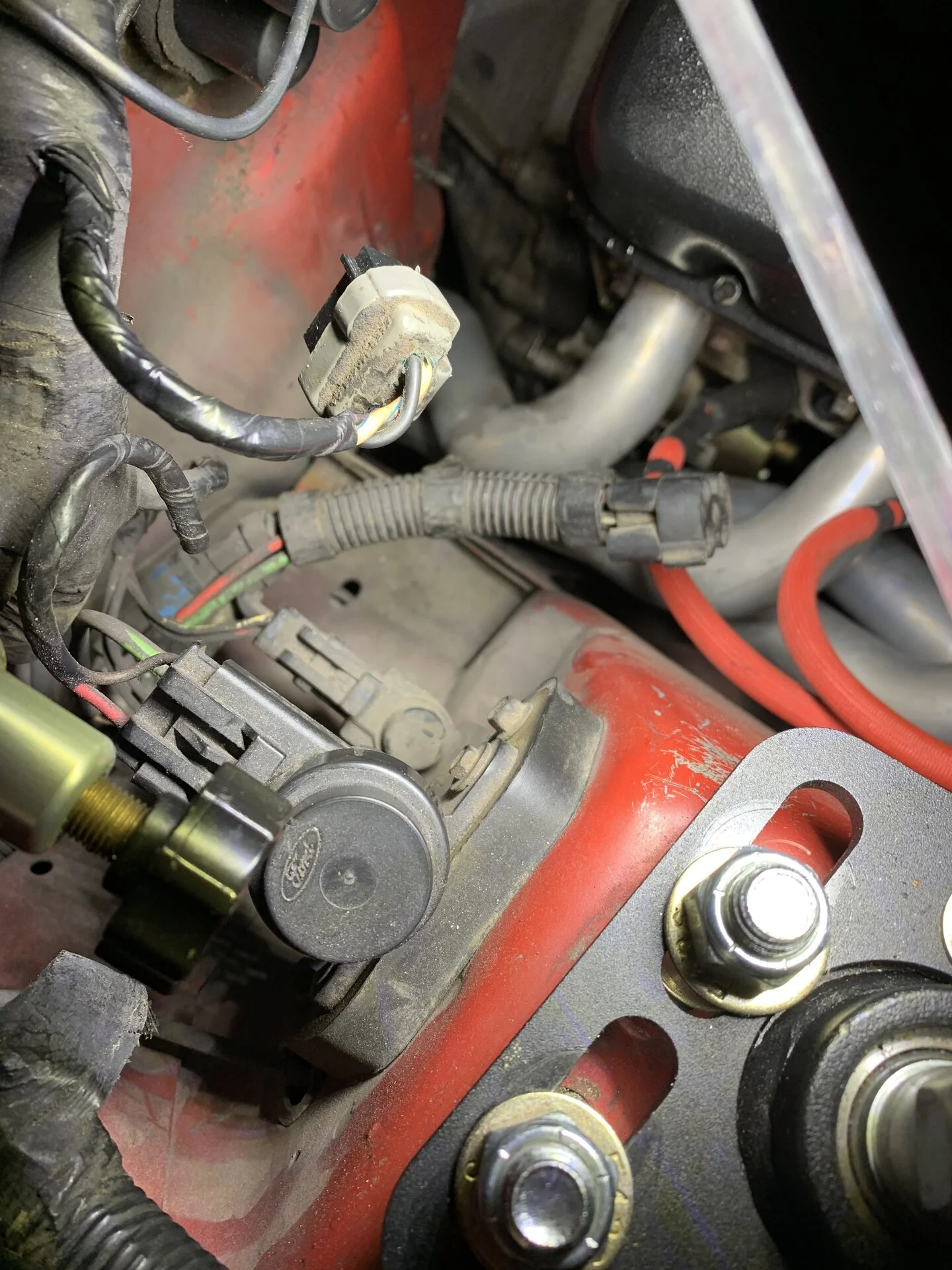

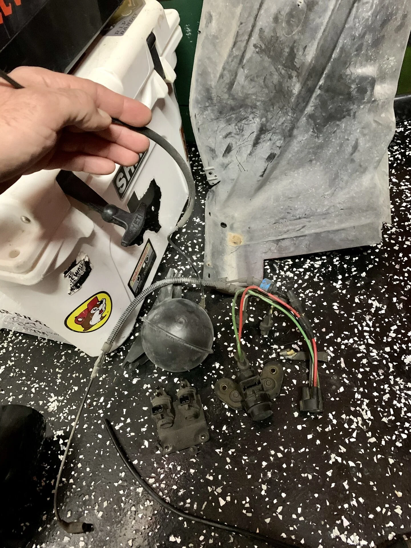

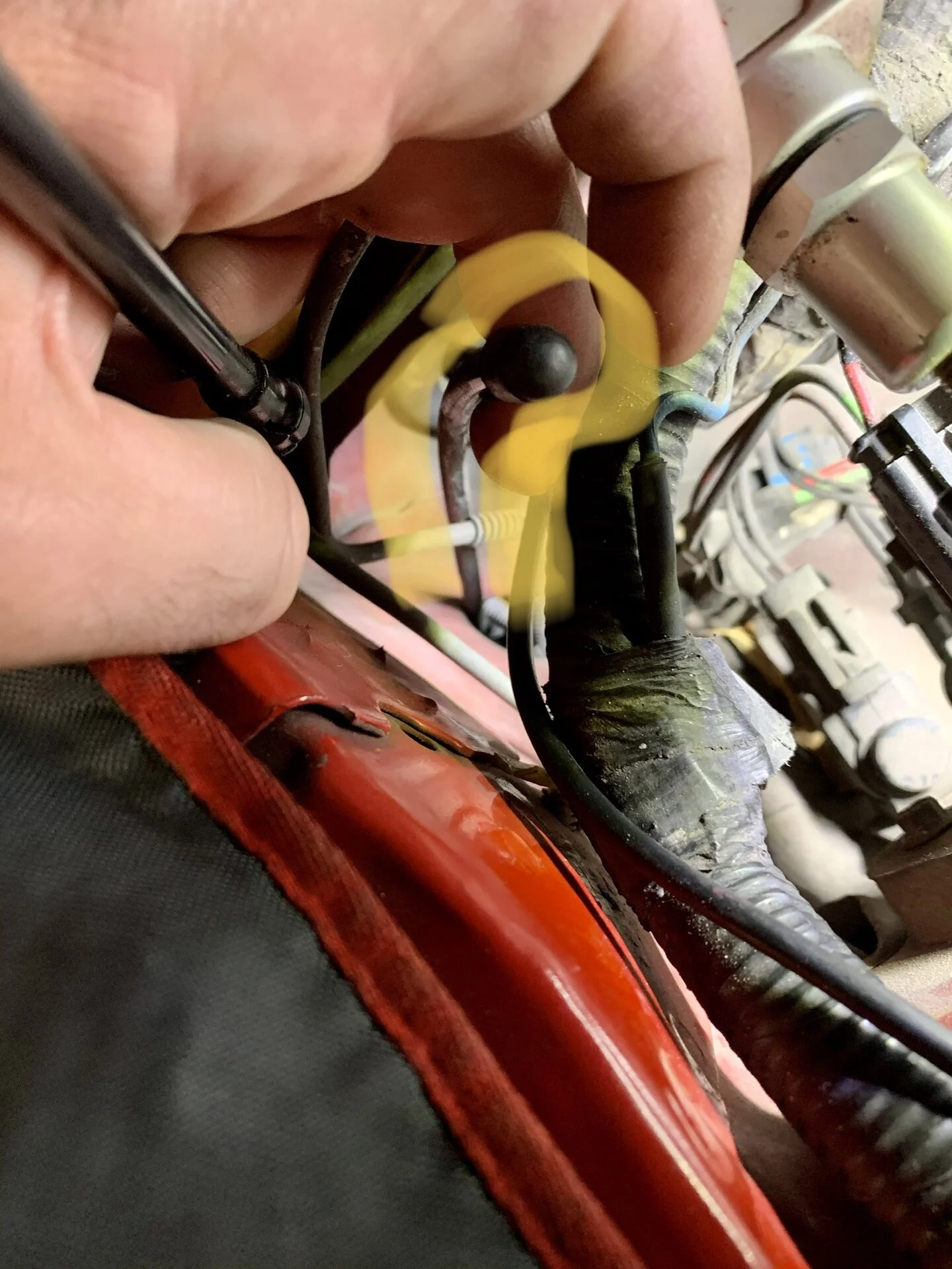

Gotcha thanks man, I’m guessing all this round ball thing is also to do with emissions as well as that small canister that one of those things was plugged into up inside the fender area?I went back and looked at my old pics. My TAB/TAD solenoids we’re a little different looking, but I did remove them.

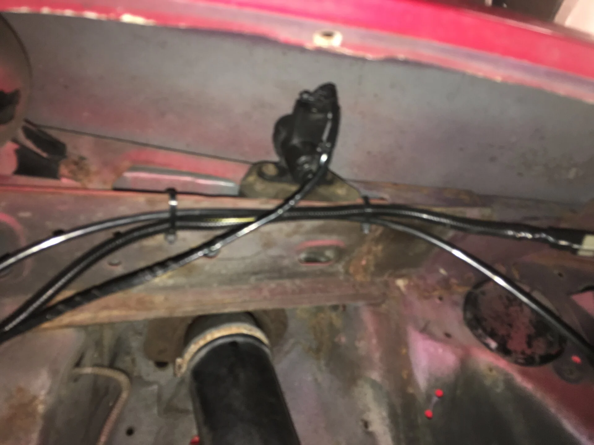

The EGR solenoid, I found a nice spot for at the top of the inner fender. Just a suggestion.
One is for emissions, and the ohter one I believe the ball is the vac reserve for your HVAC.. if you delete it you won't have air/heat thru the vents just the foot well and top of dash like defrost.Gotcha thanks man, I’m guessing all this round ball thing is also to do with emissions as well as that small canister that one of those things was plugged into up inside the fender area?
So what does this ball think connect to? I’m pretty sure it was either cut or justThe round ball is vac reserve for HVAC. You'll want to leave that.
I'm about to do this myself. I'm tucking both sides and doing a power distribution block and starter relay delete. I may even relocate the BAP sensor to the fender and tuck the charcoal canister up and in the fender too.
ok so on where is it mounted to? It was just sort of hanging there when I pulled the liner. Plus it was also just sitting back there cut and not plugged into anything unless that is how it’s suppose to be?The round ball is vac reserve for HVAC. You'll want to leave that.
