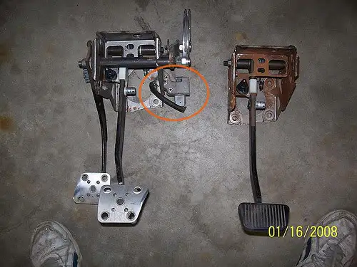

i did the swap a few years ago. did you do the wiring by the pedal assy? i think i remember something about a jumper wire in the left side kick panel also.
did you do this:
- Plug the neutral safety switch. The clutch neutral safety switch plugs are already wired in every Mustang. Look under the dash for them. They will be taped up with the main wiring harness.

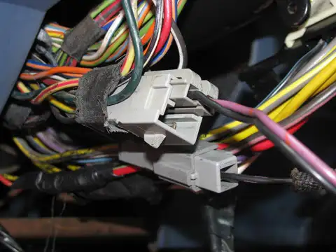

Everything is plugged into the steering column like it came out, except for this...
I can't remember if there was something else that was plugged into this connector or not. Does anyone know? I also pulled a code 67 from the car lastnight. Could this be my problem?

I also don't have this switch (circled in orange) on my t5 pedal assembly.What is it, and could this be the problem?
