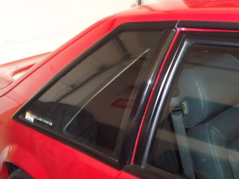

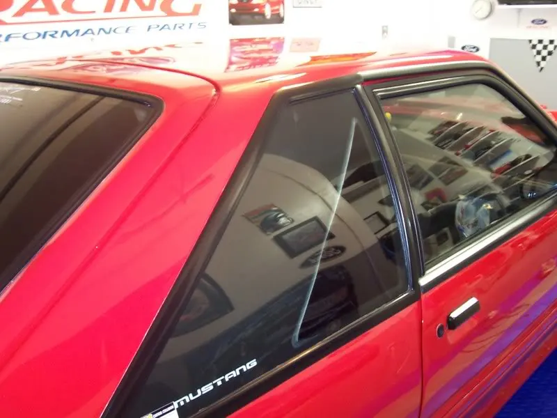

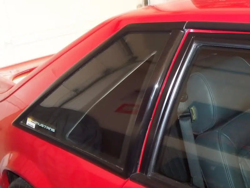

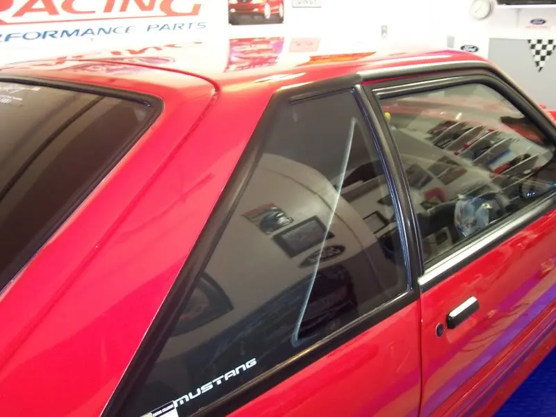

Blue oval industries provided the 1/4 window covers, I get compliments on the general condition of my cars trim and the covers go unnoticed...that says it all, not being noticed is exactly what you want from them.
