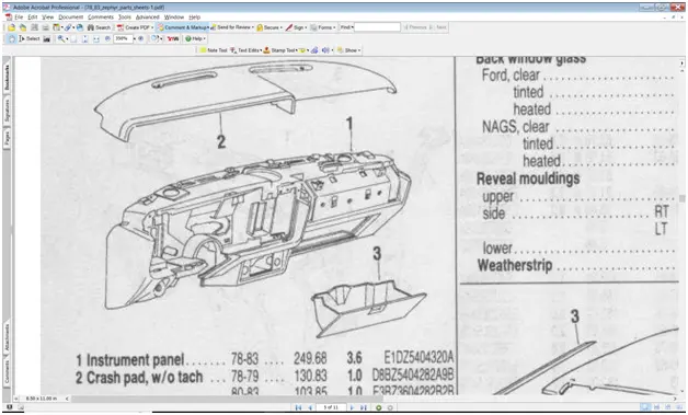

The instrument panel (AKA under the dash, dash hull/main body) might be the same as other Fox body cars. Here is a picture of the instrument panel of a '78-'83 Fairmont/Zephyr (Ford part number E1DZ- 5404320-A). The instrument panel (AKA under-dash, hull), denoted with the 1 in the picture below, is a paint-to-match part. This picture shows the hull or bare-bones dash structure without other attachments such as the instrument cluster, radio, and bezels. Perhaps, I could transfer these parts from my broken instrument panel to a replacement.
According to the Ford Master Parts Catalog, this part number (E1DZ- 5404320-A) fits:
1979 Capri
1978 to 1979 Fairmont/Zephyr
1980 to 1983 Fairmont/Zephyr, Mustang/Capri
1981 to 1982 Granada/Monarch, Thunderbird/Cougar except XR7
However, other interchange systems give a different set of vehicle dashes matching the one in my 1980 Ford Fairmont.
