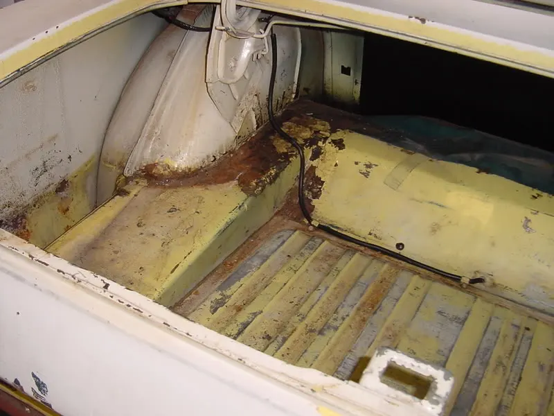

Hoping someone may now be able to help with another problem - I bought the underdash wiring harness and the wiring that goes from the dash to the back lights. A fuel sender unit comes off the wiring that goes to the rear lights. The trouble is i can''t find a hole in the trunk floor that the wiring goes through. I have seen the hole in the 66 fastback but not in the 65. Does not appear that a hole has been welded up. The unfortunate thing is there was no sender unit in the 65 when i got it. so i''ve got no idea. Anyone got a 65 who can shed some light?

The wire for the fuel sender is on the passenger side. Should come through just in front of the tank on the pass. side. IIRC it then runs along the drivers side to the dash. Hope this helps! Here's a link to wiring diagrams.

Mine comes through right in the center. Could be because of the dual exhaust.
