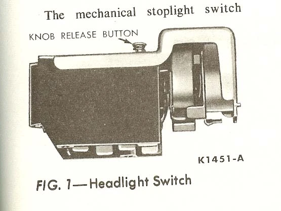

removing headlight switched
Here is in image of the headlight switch. When you press the button the know (correction) knob comes out then you can insert a screwdriver into the bezel and it screws out. As far as the washer switch goes on my 67 it is part of the insturment panel bezel and comes out attached to it.
