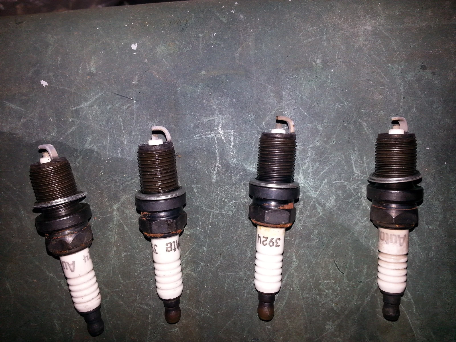

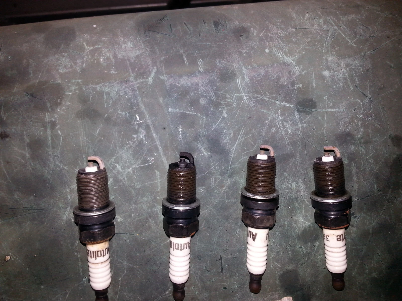

After fixing my blown intake gasket the car sounds and runs better, but I still noticed a little something missing so today I wanted to do a compression test. Got a loaner tool from Auto Zone, screw in type. I did not screw it all the way down as it was a PITA to even get in, and also get the extension coupler thing with the hose to screw on easily but I put about 3-4 turns on each one before putting the guage on and pulled on it and everything felt snug. I just changed plugs about 3 wks ago, 2 wks before diagnosing the blown intake gasket. I will post pics below of how they look. I did change the oil after putting the gaskets on and used the cheap Peak 10w 30 from Orielly because it was 14 bucks with a filter. I havent changed it again yet but i will and run pennzoil 10w 40. I just pointed the oil thing out because checking out some other post about compression test results someone said something about the oil used but i wouldnt think that would be a cause of the results.

All the plugs look fine with the exception of No. 2. I was thinking no. 2 isnt that bad with the exception of being oil fouled maybe ??????

first thing I'm going to do this morning is change the oil from the cheap peak oil 10w 30 that i just intended to use after the intake change. It appeared that i didnt have coolant mix in the oil after all so i was going to leave that Peak oil in there but I'm going to change it to my normal Pennzoil 10w 40 thicker oil. Not sure if that thinner oil had a bearing on the results or anything but I'm just going to change it anyway. That and put a new plug in no. 2 as that one plug was dry oil fouled some.
