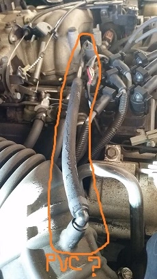

This may or may not be a dumb question. BUT, this is the PVC valve correct? I've been reading the Haynes instruction manual and it says it's on the driverside. But I think this is it. Am I right?
Thanks... Still new to working on my own car. Trying to figure it out.

No, the PVC valve is on the passenger valve cover, at the back. It is a pain to get to, but if you disconnect your intake tube and look under the two coolant hoses going to the firewall, you will see it. On 99-04 SN95s, your picture hows where where the PCV is located due to the redesigned upper engine

I'll take a look tomorrow. would you be able to send me a picture of the location?
