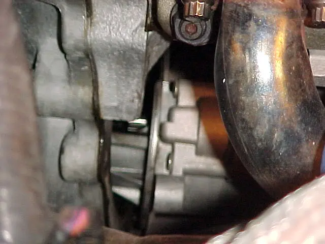

Did you solve this problem? My starter is making a weird noise when I start it up. Today I turned the key, it made the noise, I turned the key back and tried again, no noise started fine. Then next time, it made the noise twice then started fine on the third try. And the last time it made it three times and started fine on the fourth. I guess it seems to be getting progressively worse so I want to fix it tonight.

Yeah I probably should have taken a quick look before searching for an answer online....
If the picture's not clear, the upper bolt is missing and the starter is about an inch away from the bellhouse. Glad it was that easy.

It was a horrible grinding buzz. Obviously the starter gear was missing the teeth of the flywheel. Surprised the car even started!
