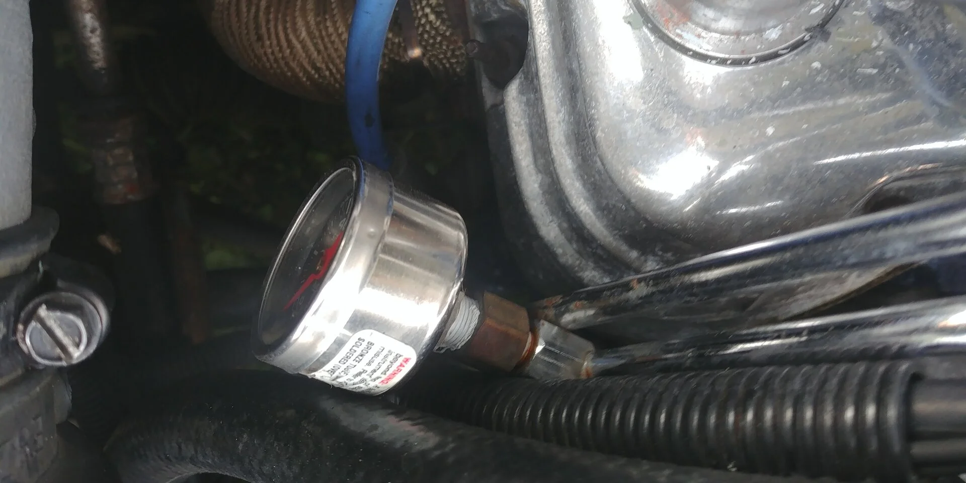

Here is how I have mine installed. Basically removed shrader valve, installed adapter fitting and then attached gauge.

Can you see it good strait up the way you have it. From the side of coarse. This is one of the only how to thread on putting on a fuel gauge here

No issues reading it. Think about it, you really only need to see if you are adjusting the fuel pressure.

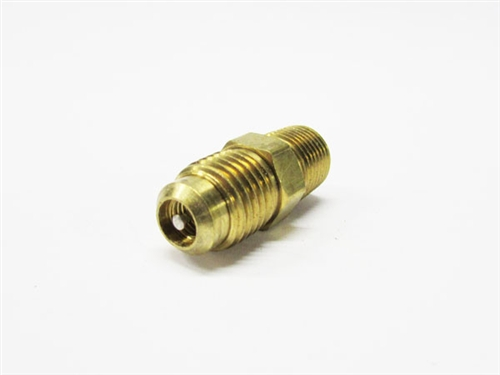

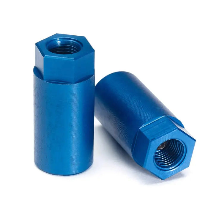

Schrader Valve Adapter
Performance Fuel Systems - Products

Fuel pressure gauge adapter fittings:
http://www.holley.com/products.asp?product=17945NOS AN 4 to 1/16” pipe
http://www.holley.com/products.asp?product=16785NOS 1/16” male pipe to 1/8” female pipe
