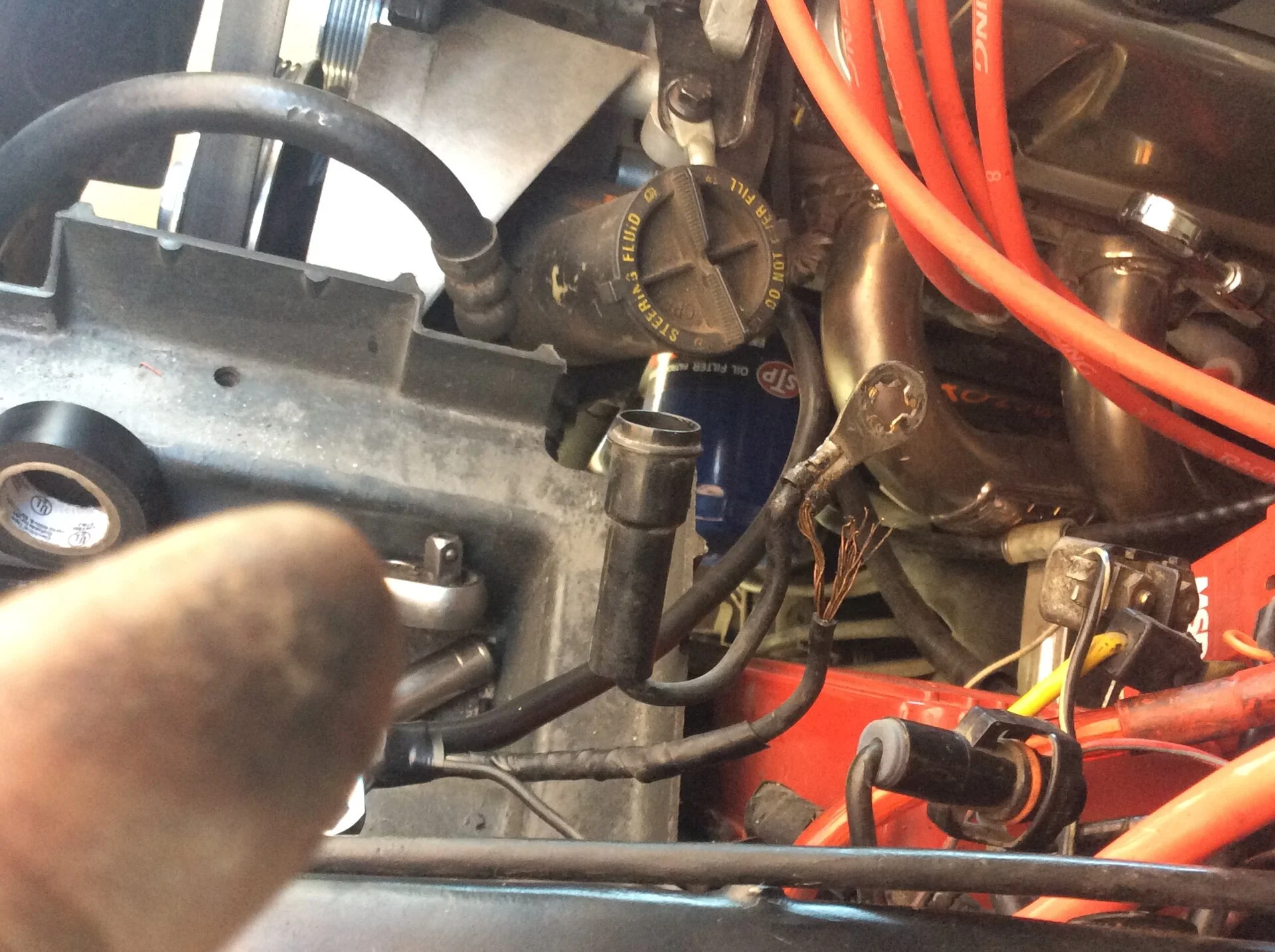

Ok I went to parts store,battery passed at 2 locations I had it charged either way,as for the starter it passed as well but I did get a new one along with new + wire but as I was looking at the wires I found this in the pic. At the fender the ecu ground wire one side looks good but the other end looks messed up. It has like 5 wires going in the ring and the other 10 all frayed looking. Could something like this cause issues I’ve been having? Stuck starter solonid/starter or a no start at time. I don’t know but I know it’s important lol

It’s a problem for sure. I doubt it is THE problem, but it needs fixed. Now it’s time to check out the grounds and positive side cables and all connections on the big cables and the small grounds like you are doing.
Before we swamp you with info on checking for voltage drops, let’s see that meter you have.

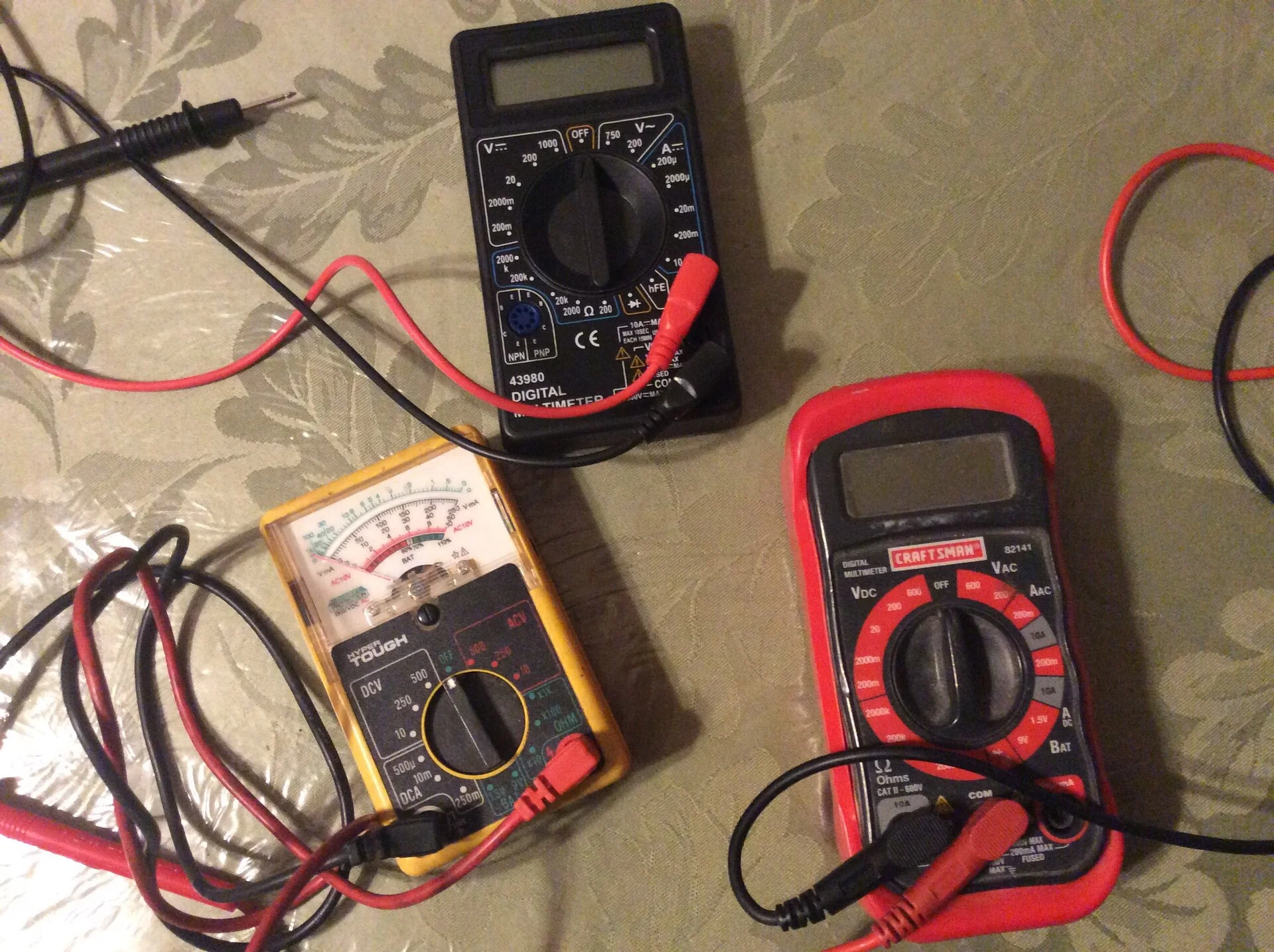

Thank you soo much,here they are

Yes! Any of the three will be useful for chasing down these issues. The two reasons I rarely use my analog meter any more are 1. The digital is easier to read than making sure I’m on the correct line 2. If I drop the HFT cheap meter, it’s not a big deal. So my two good meters are often neglected.
Before testing, have a wrench handy that will work to remove a battery cable if the solenoid sticks again. A 6” adjustable Crescent wrench works well for this. The first thing to do with the wrench if the solenoid sticks is to use the curved side of the wrench head to tap, but not break, the top of the solenoid (starter relay). That’s often enough to free the stick points in the relay.
Set the meter to a range that will test at least 12v DC. Touch or attach the black (negative) lead to a good ground. Pull the small trigger wire from the small post on the solenoid, and use the positive lead to make sure that wire has power when and only when the ignition key is in the start position.
The other steps have been posted many times. I will look for a good thread for you. But if someone finds a “testing for voltage drops” and other starting issues (besides the cranks, but no start) check list, PLEAE post it. It’s time we have it stickied under the tech threads. And if it’s already there, I need coffee to see it.
