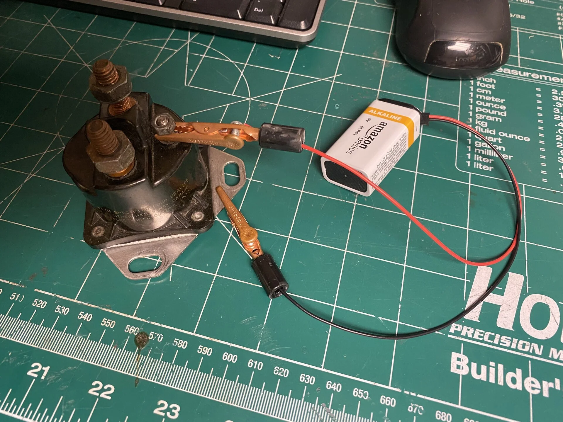

Yes it is. Basically there are the two large posts on the solenoid, one connects directly to battery and has all the other power feeds on it. The second only goes to the starter. The small one on top gets a power signal from ignition and essentially connects the two large posts when engaged.

You are eliminating the possibility there is a bad connection in the existing cables/connections on the relay
Battery to small post will be a clean connection.
Also, one more thing to check. The starter relay grounds through the metal casing that mounts it to the fender. Make sure this is clean and rust-free and has a good solid rust free connection to the fender
You can see where the clips are on the relay. 12v pos and a hood ground will close the relay and bridge the two biggest posts together.
A 9v battery will not activate the relay. I tried.
