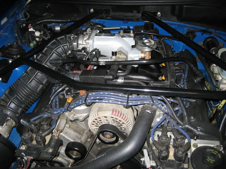

About 30k miles were on it when I installed it and while I drive it agressively, it's not abused in any way. Here's a shot just after install if your interested how it looks cutting out/around the black plastic cowl piece.
