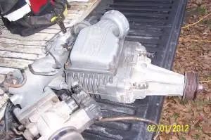

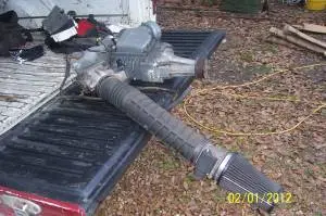

Well actually i did find a supercharger perfect for my mustang, 3.8 Ford Supercharger just about everything i need for $200, but i didnt know if i needed anything else.

Hmmmmmmm. don't see the lower intake manifold that the supercharger bolts to, don't see the rest of the intake plumbing into and out of the supercharger and intercooler that went with those pieces from the factory, don't see the fuel rail that must be used with that set up.....................want me to go on? Want to guess how much more you will have to spend to make it work? It will turn out to be much more than $200.00 to make it work.
