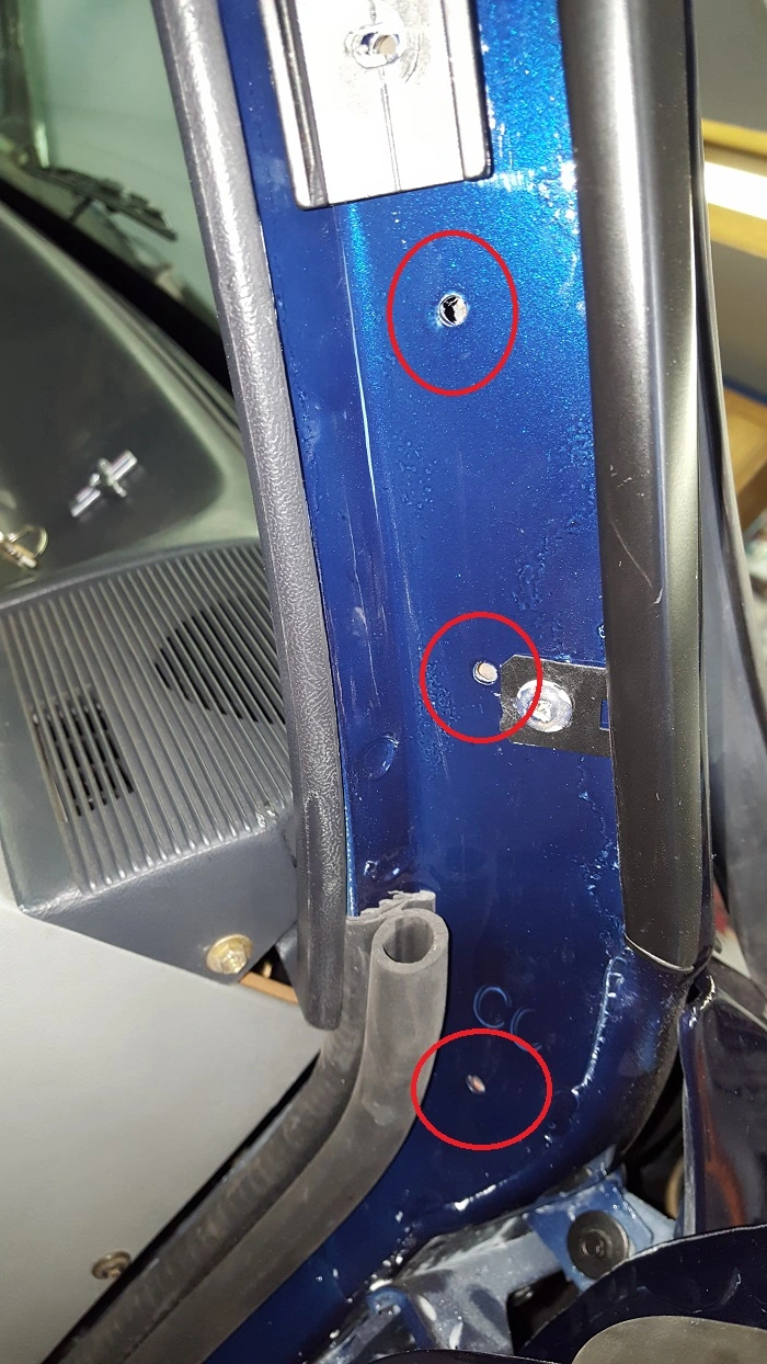

On the A pillars, the aluminum seems to be too short towards the bottom as the weatherstrip is molded to accept that piece another six inches..and there's three more holes below the aluminum strip. Pic below, holes circled in red.
Or are these holes for the plastic pins that go through the weatherstrip and into the body? There are no holes for doing this in the weatherstrip I currently have.

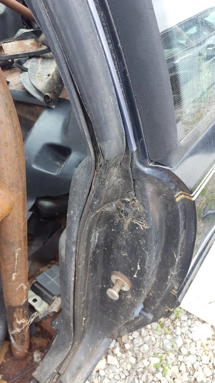

I went to the scrap yard yesterday and pulled all of the t-top related trim and retainers off two cars (one was a '84 and I think the other was a '82, there were no '87 or '88 t-top cars there). The older cars had the three retaining pins in this location. I'm wondering if I have an early '87 and they used up the older weatherstrip before going to the new style.

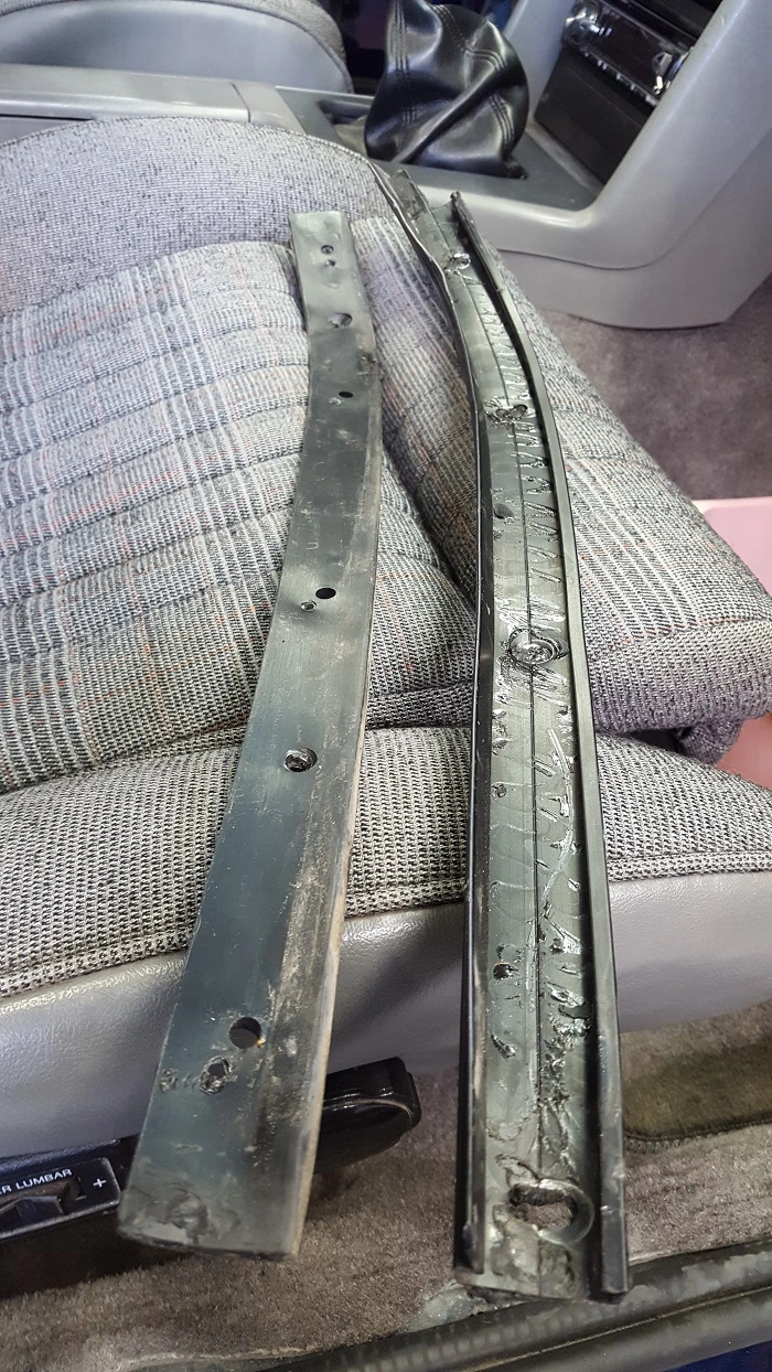

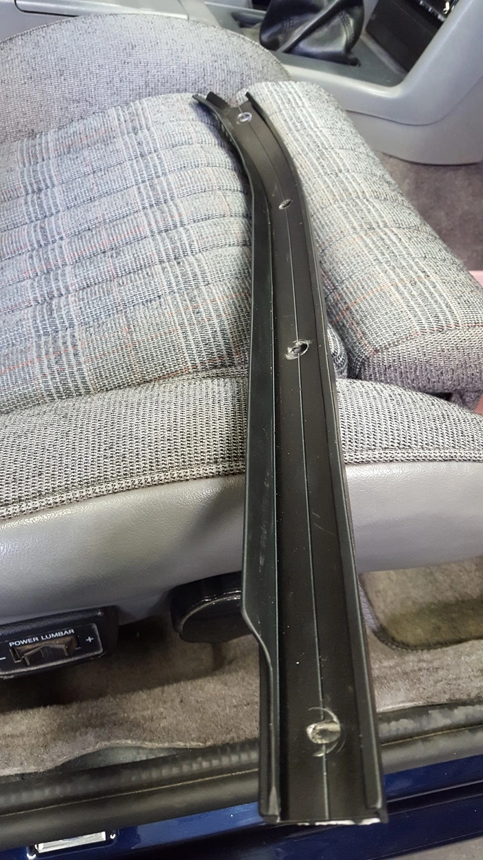

Here's the front retainer I am currently trying to use. The only reason for trying this one is it was on the car when I got it. Problem is, this car was apart so many times by previous owners, I really don't know what is correct for it.
Here is one of the '84 retainers with the plastic shim that goes behind it

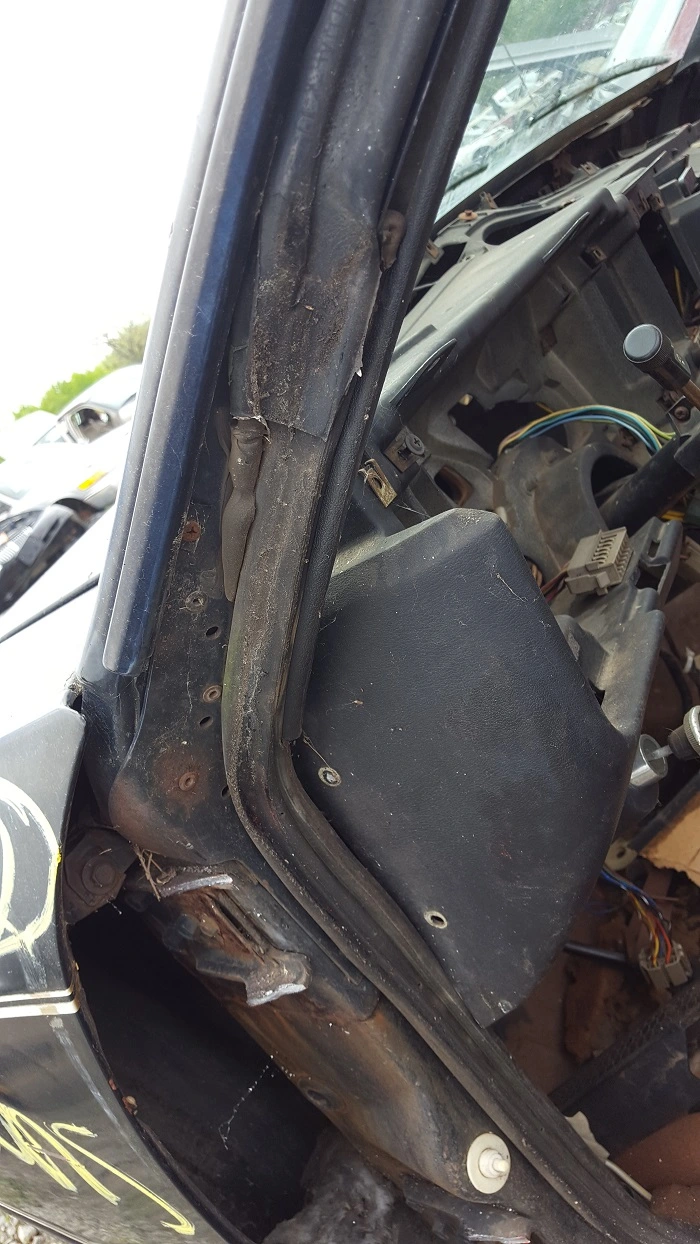

Here's a couple pics of the older weatherstrip on one of the cars

Did some more investigating and found out the older style retainers with the plastic spacers and the newer style are basically identical. The newer style has the spacer built in. When comparing, they are the same. Still wondering just what style of weatherstrip this car is supposed to have.
