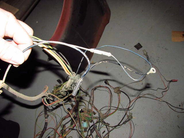

soon as it stops raining i will look at my harness to see how the sail panel wire was connected ,i will take a couple of pics.

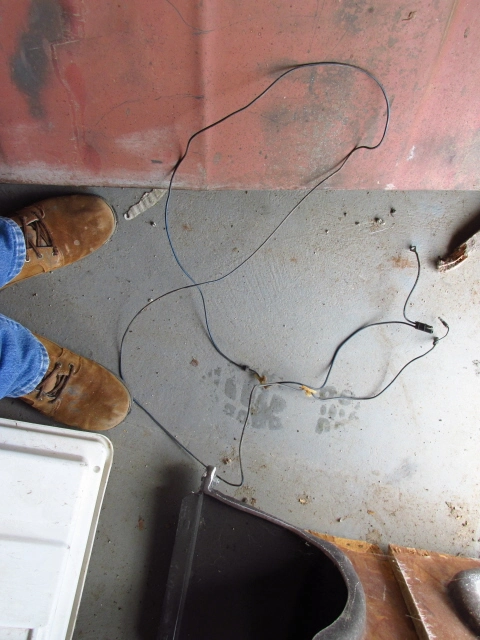

Hey it stopped raining . The sail panel wires do come from the tail light harness ,it is a black with blue wire .There is a pig tail that comes right out of the harness.
. There is a jumper wire that goes through the box section inside the rear window lower panel to the pass side ,there are a couple of short jumpers that connect the sail panel . these wires are black with a blue stripe as well .
