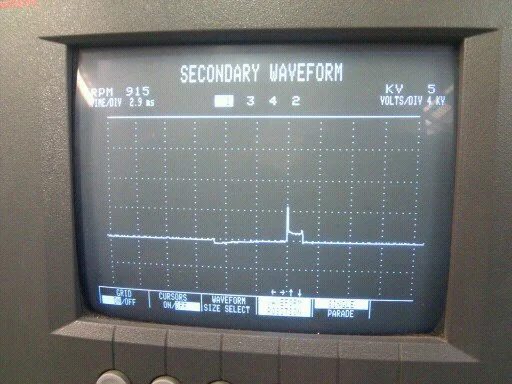

A spark from a typical automotive ignition system is a sharp spike with a very fast rise time.
Taylor wires use a strategy that dates back to WWII; the wire inside the Taylor wires is a coil that forms an inductor.
Short story on AC circuits and inductors:
Inductors have a very low DC resistance but a very high resistance to AC current or spike waveforms like the one in automotive ignition systems. Inductors oppose the change in current and the higher the frequency, the greater the opposition to current. A spike waveform is by its very nature a high frequency AC current. The resistance to current flow in an AC circuit is called impedance, and it varies with the frequency of the current in the circuit.
Executive summary: spiral wound wire core spark plug wires offer no performance advantage over conventional spark plug wires. They may be made of better materials or have better manufacturing quality, but no greater spark energy in typical automotive use.
For those of you in doubt, here's the century old technology behind inductors. The laws of physics and the math associated with inductors isn't anything that "newer and better" technology is gong to change.
http://www.electronics-tutorials.ws/inductor/inductor.html
Automotive ignition information and waveforms
http://rafiq003.blogspot.com/2011/11/engine-control-sensors.html
