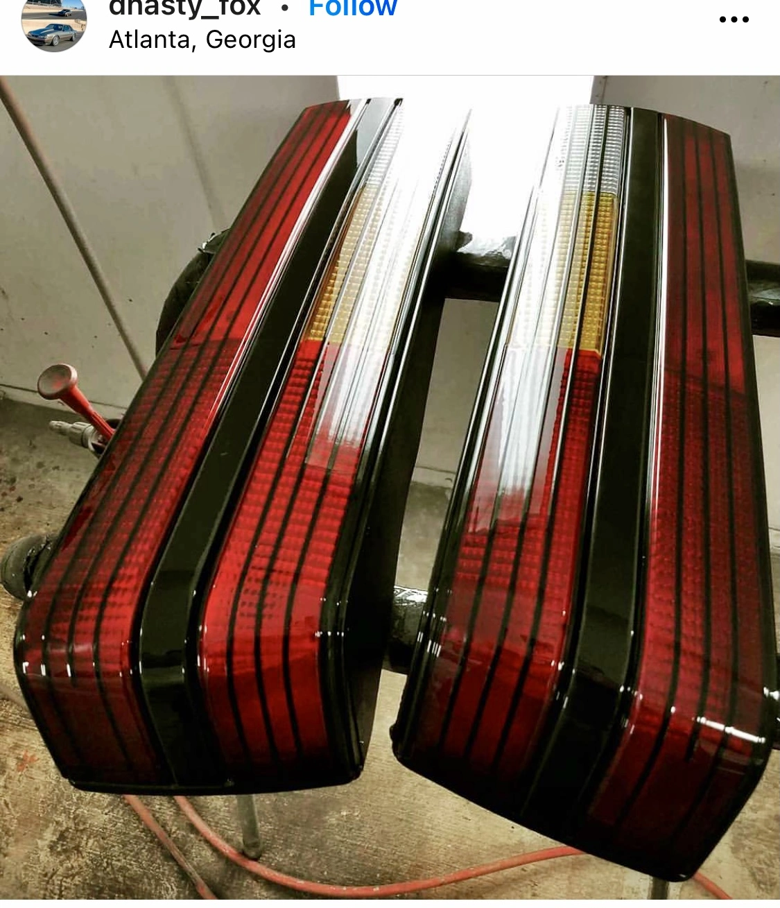

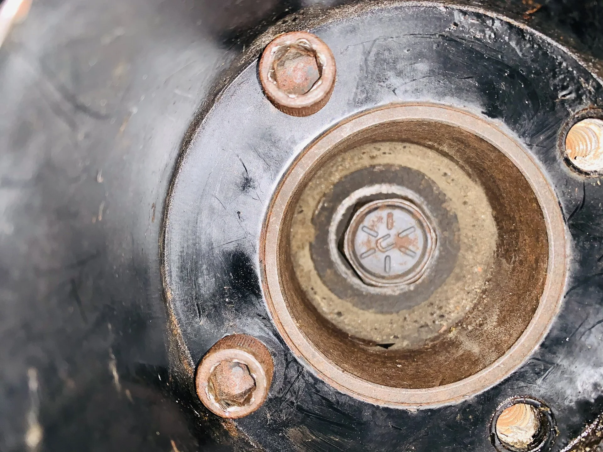

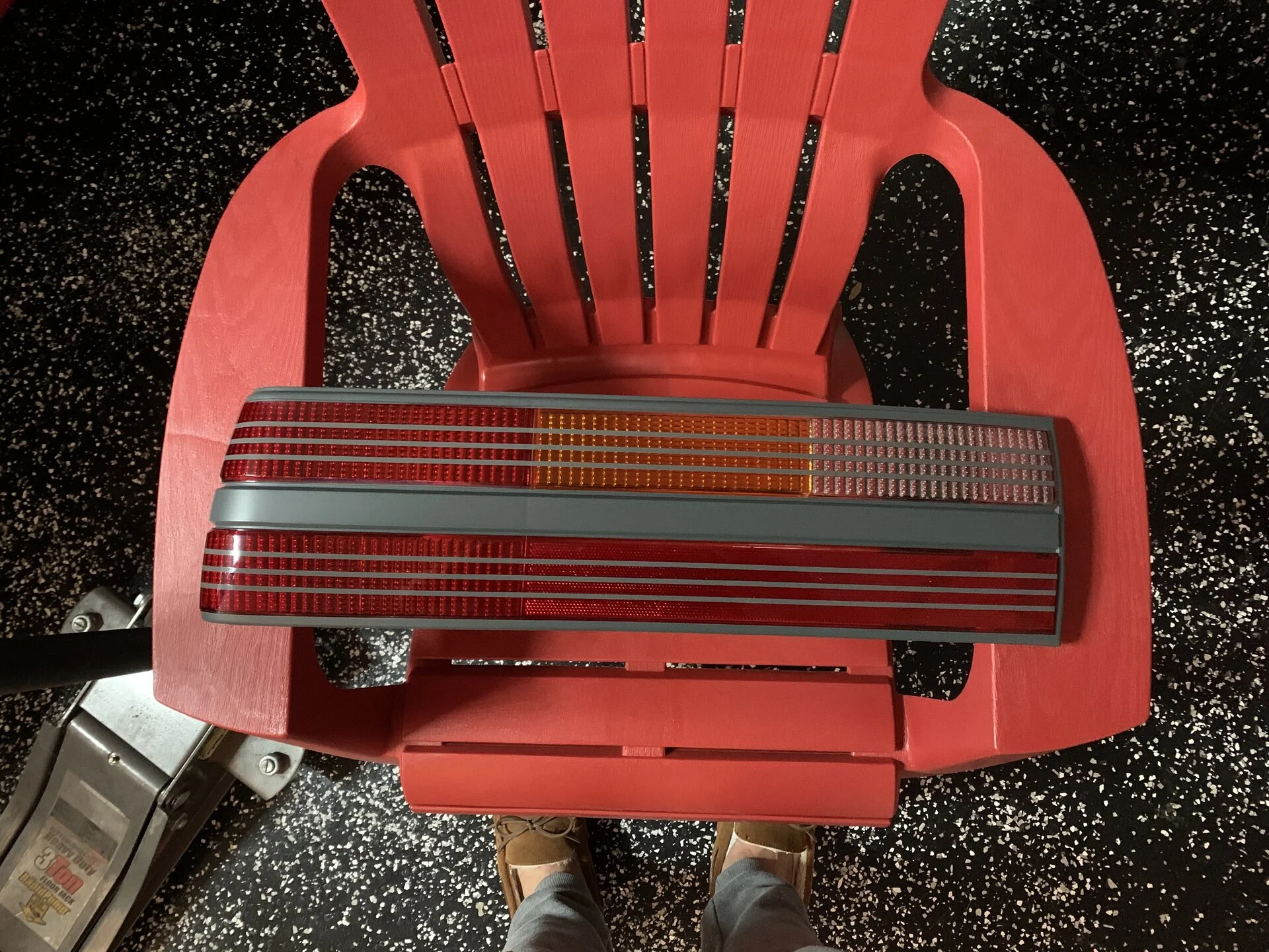

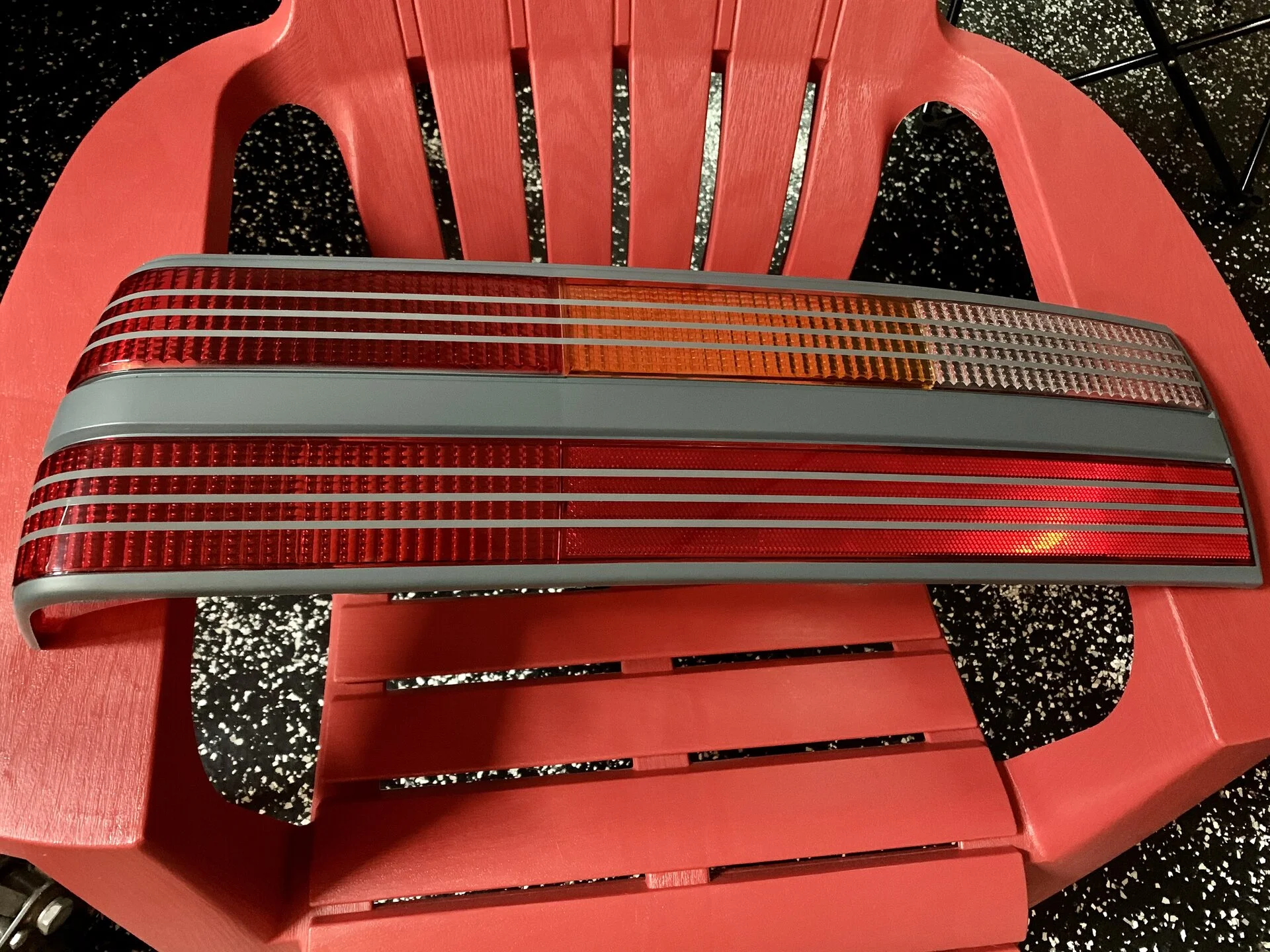

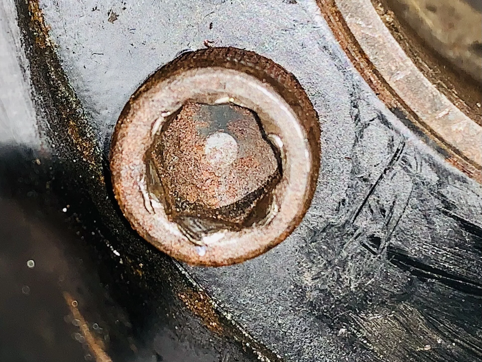

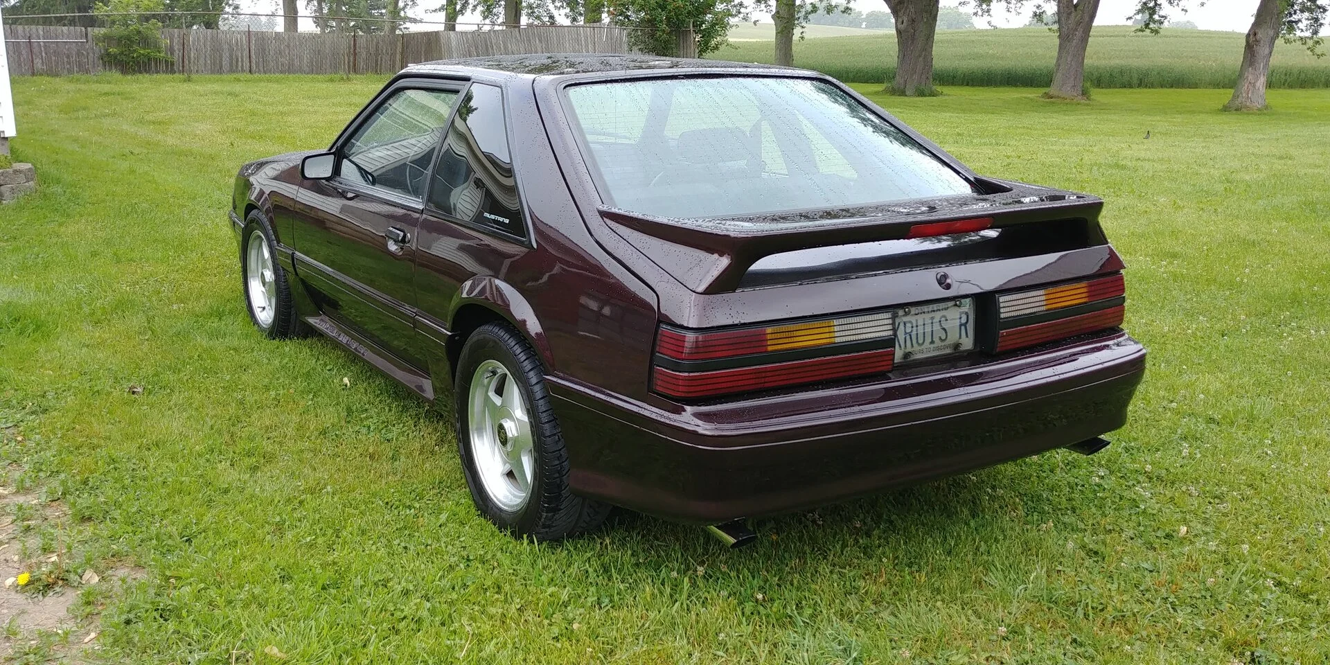

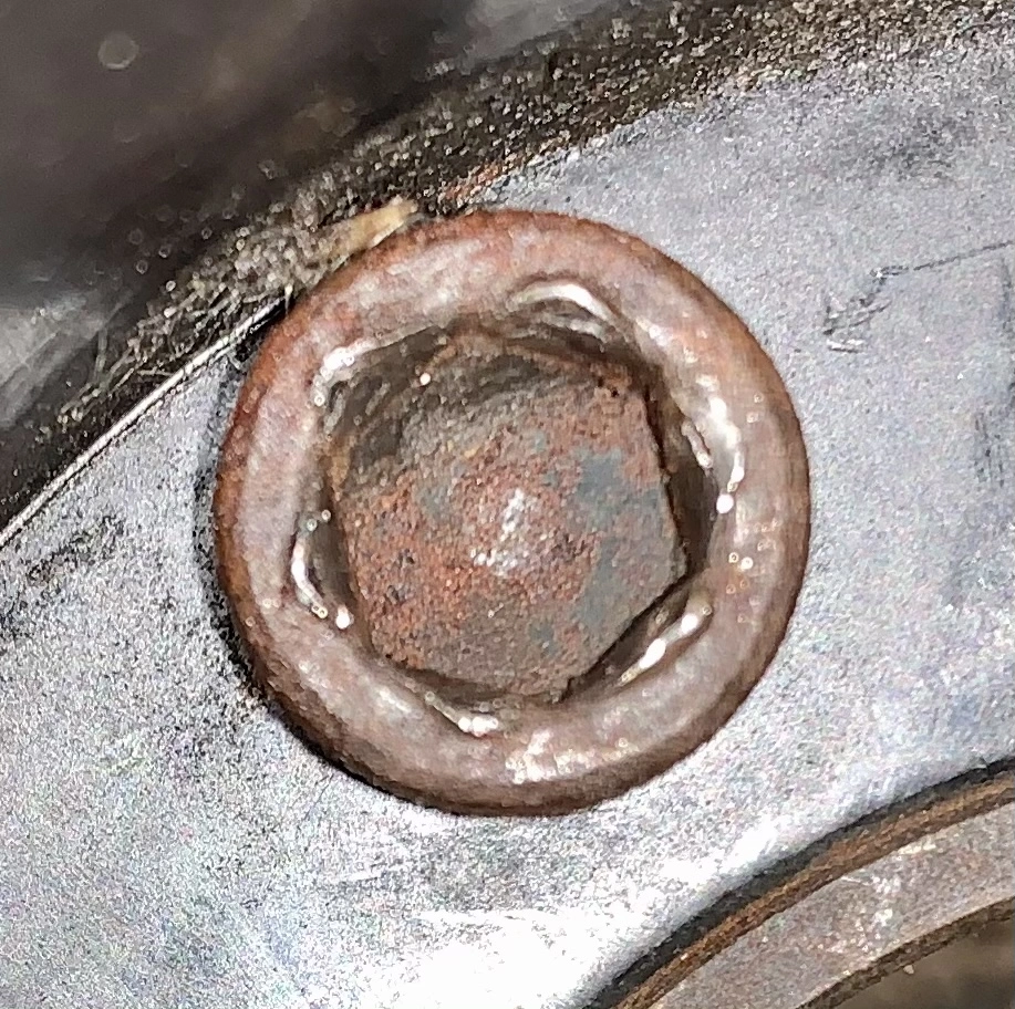

I picked up some cobra lenses from blue oval industries, I’m debating whether I should just leave the lenses alone or do something like this guy did bc I really like the glossy pop and the black vs the grey. These were clear coated at a shop, but I thought maybe I could mask off the light area and just spray it with some sem trim paint, then run the black striping over the grey. Idk about clear coating. Also what do you do when two of the crank pulley bolts look like this?!?!?!? Wtf!!!! Ended up passing in that blower, well hesitated to long and it got sold quickly.
I’d replace those bolts. Would be a pain to torque those down.

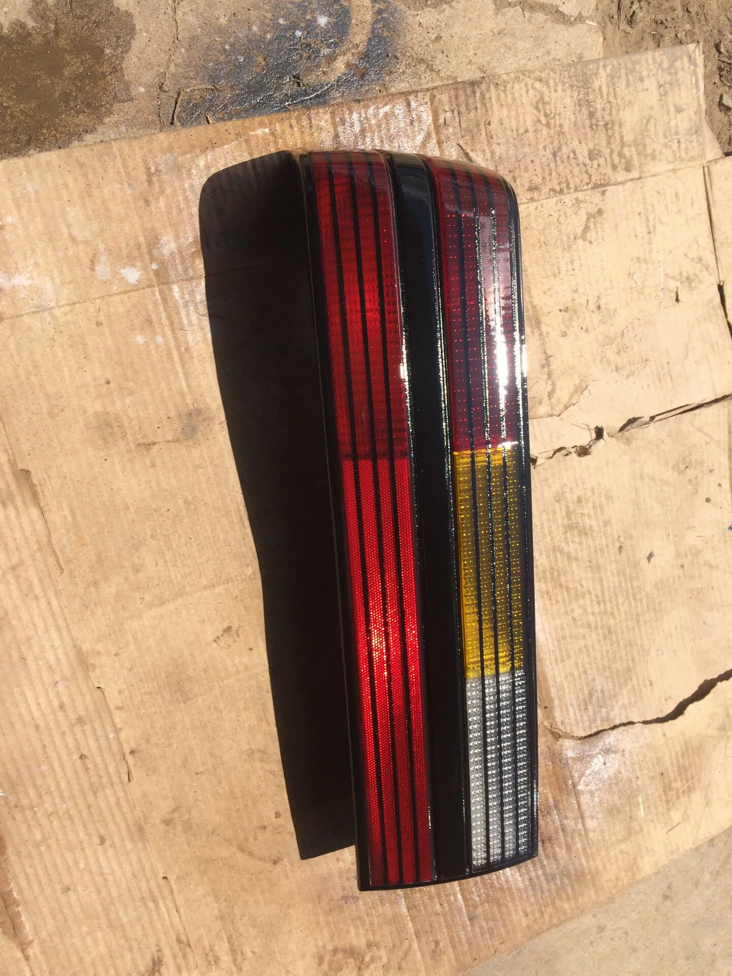

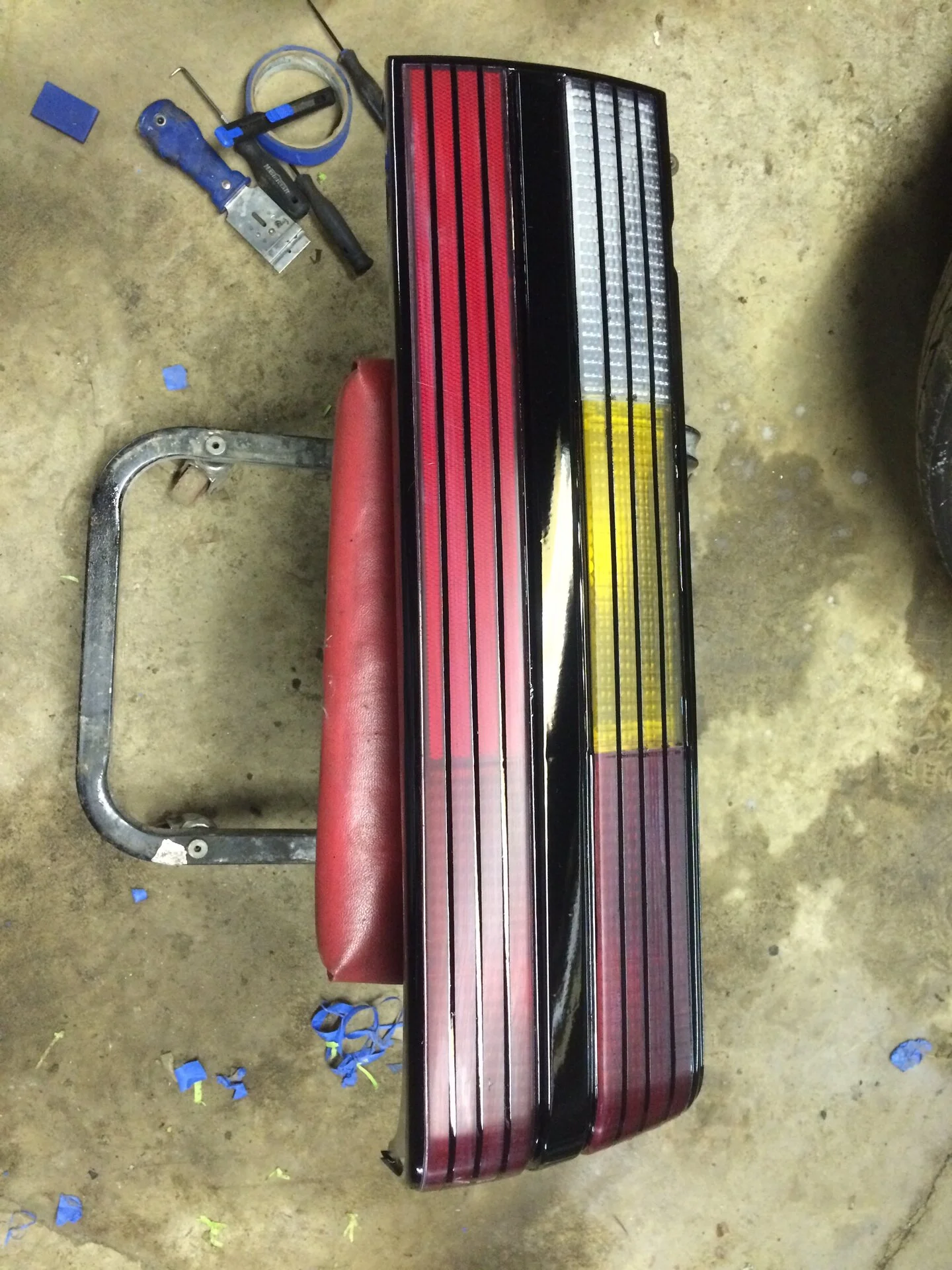

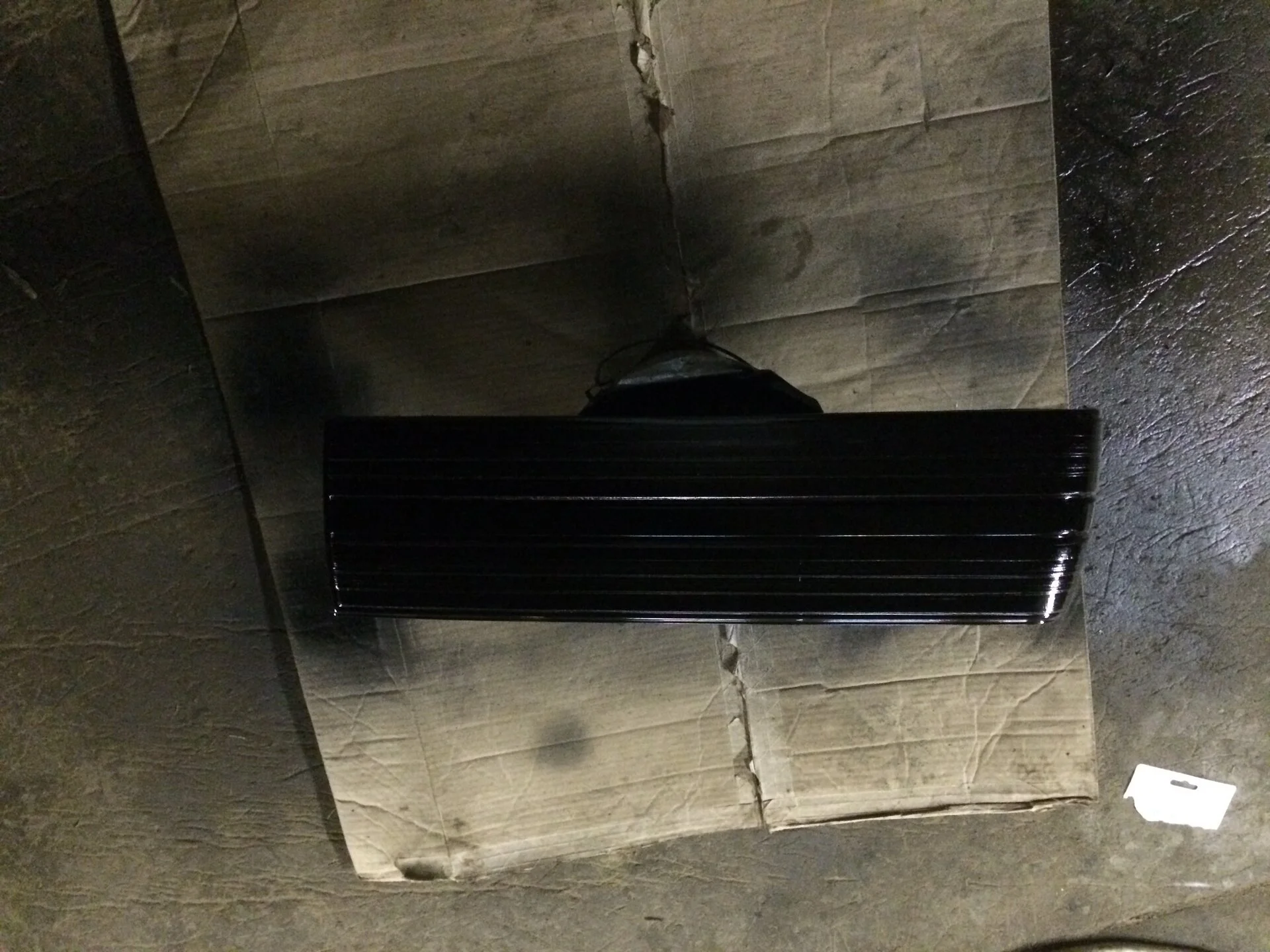

when I did my taillights, I got a beat up pair of 83-86 GT lights, painted the bar and edges black, and then clearcoated the entire lens. I then added the 1/4” black pinstriping myself. Did this 20 years ago and held up great. I agree that the black looks much better. I think the 84 SVO lights were black, 85-86 and 93 cobra were gray.

Nice I like that!! what did you use to paint the black part, and what clear? Are the aerosol ones ok like SEMs ok? Could I paint, clear the lenses with the grey stripes on, then just lay the black over them? I don’t trust myself to peel the grey ones and then try to lay down the black lines straight. On those bolts, they are pretty stripped out gonna maybe try and get a torx bit in there and see if it will grab maybe.
So I’m not sure how the rattle clear works but say if I spray the black parts first, can I then just follow up and spray this clear on top of it? Or do I have to do some sort of sanding etc?

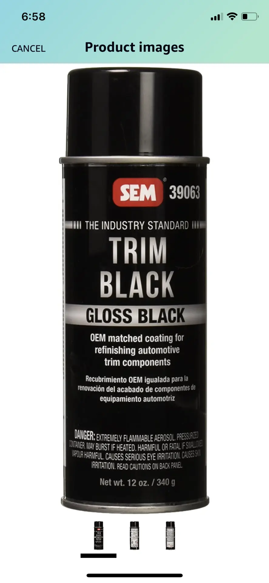

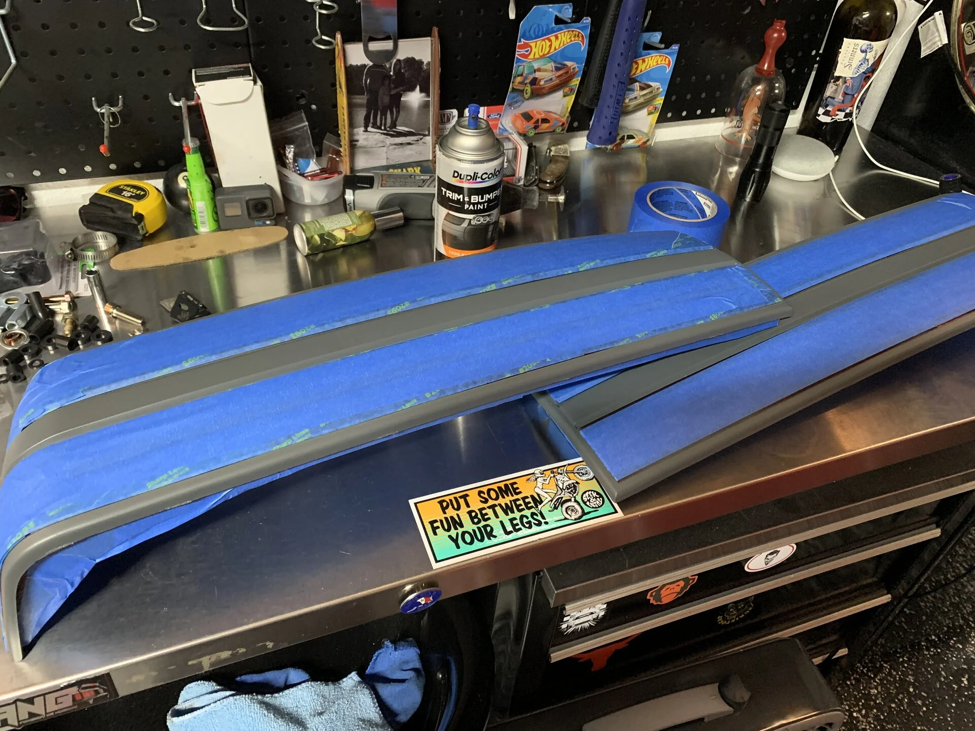

Been wanting to clean up my engine bay for awhile now, and wanted to offset the dark whole it has turned into with a little bit of bling! But nothing crazy! I know I know no ac it’s not for HP reasons!! I just think these engines look clean with a little less of the mess!! Plus I like seeing the front of the heads etc! I don’t care about AC, I don’t drive the car enough on a regular basis that it’s gonna matter, plus I’ve been cruising with windows down for about 10 years. Anyways, I then had my Master Mechanic double check everything and she said all looks well. Also on spraying these after I prepped them now I’m thinking about just spraying the stripes at the same time so might need to re prep, but I have this bumper trim spray, but should I maybe use this SEM black gloss trim spray instead???
