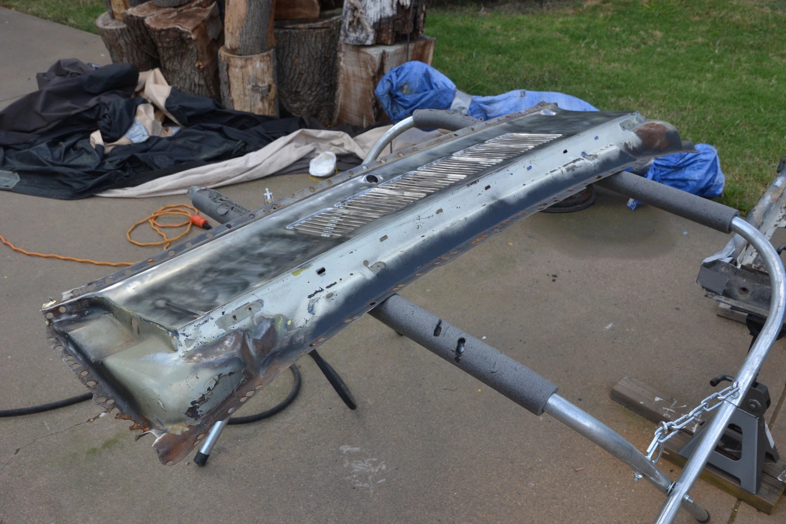

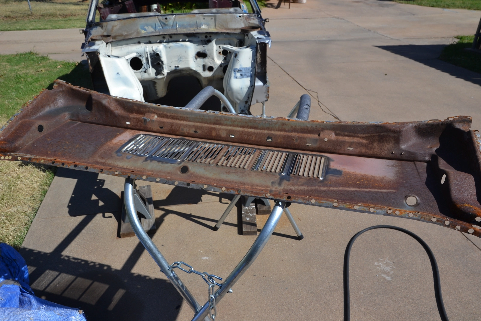

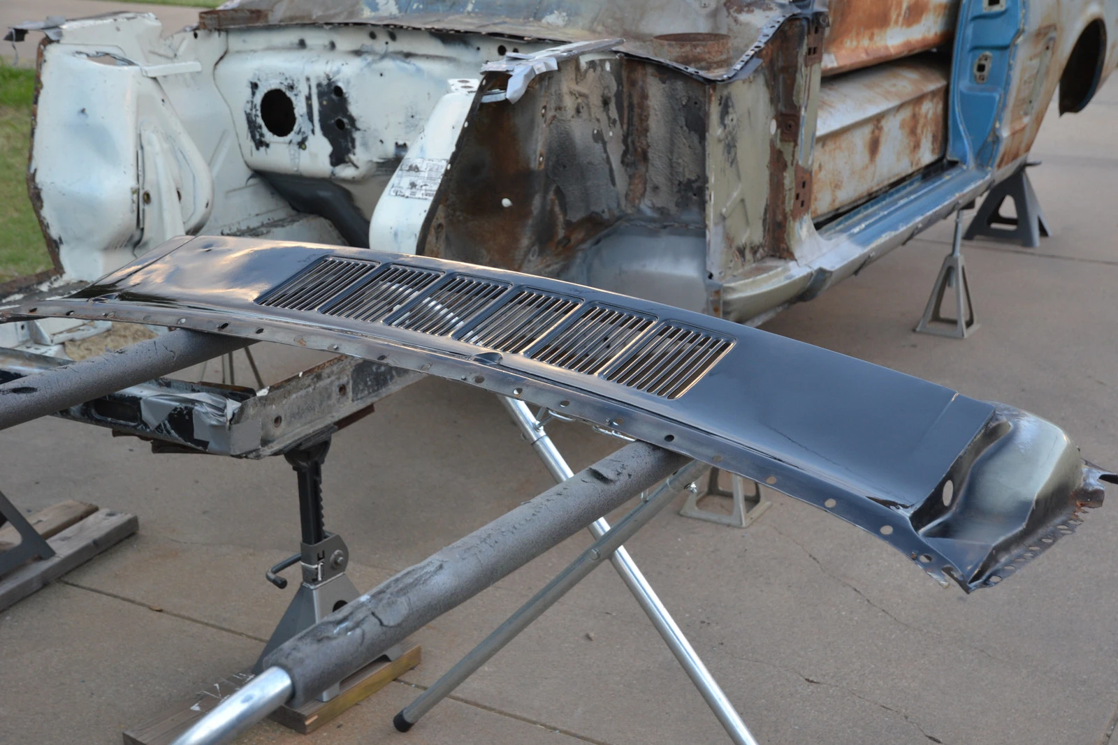

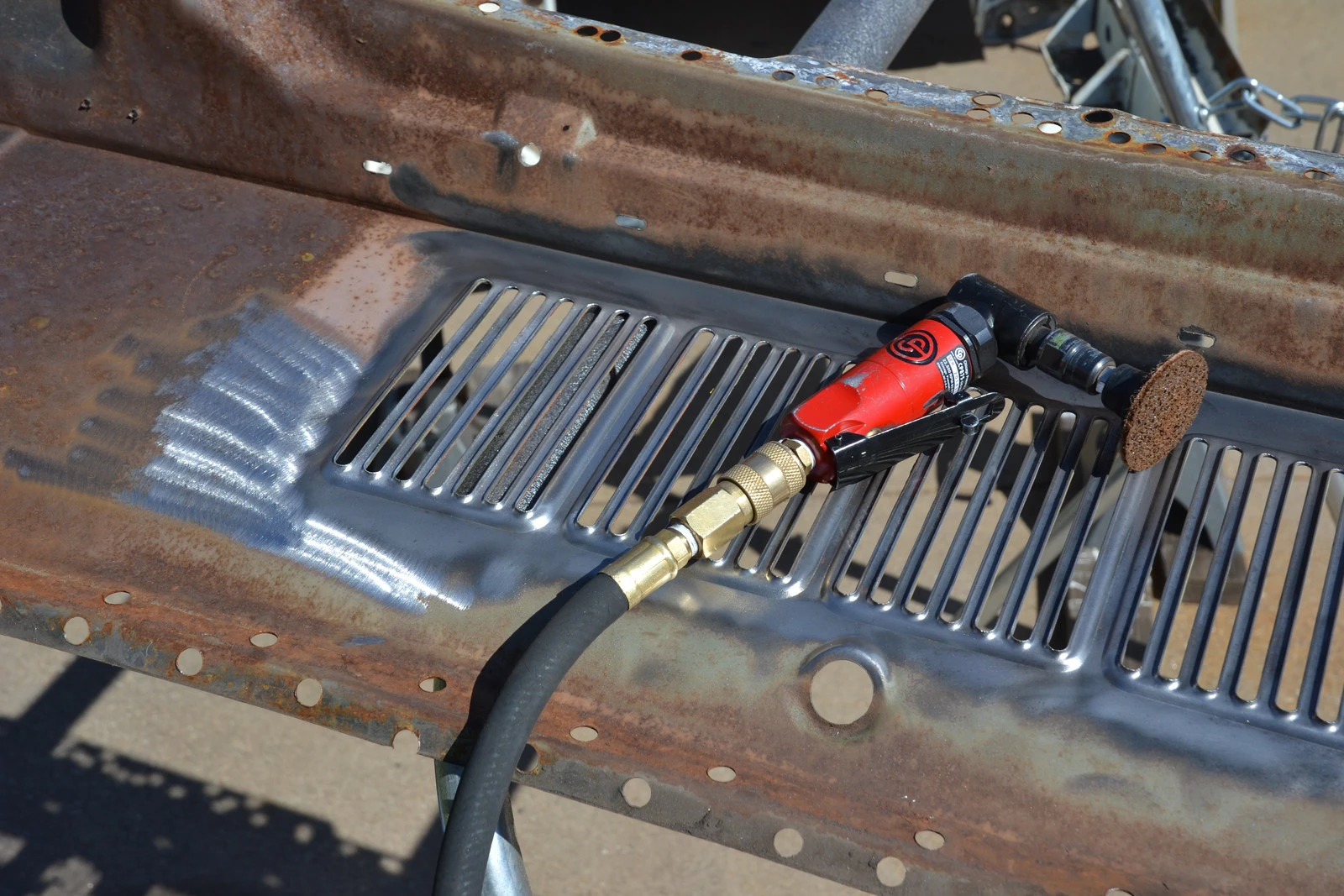

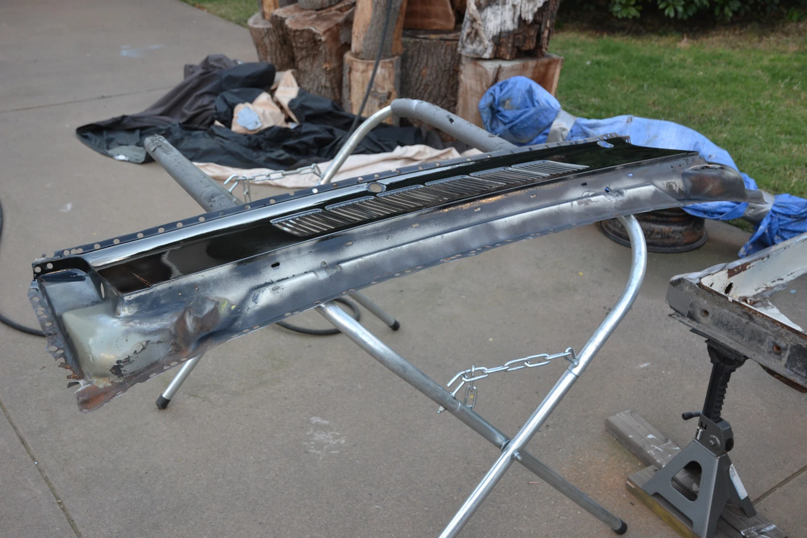

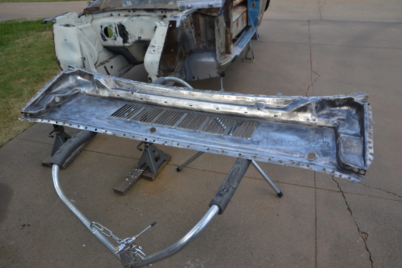

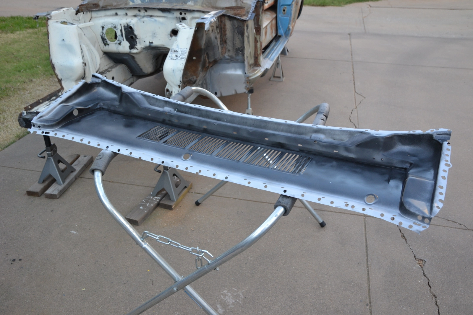

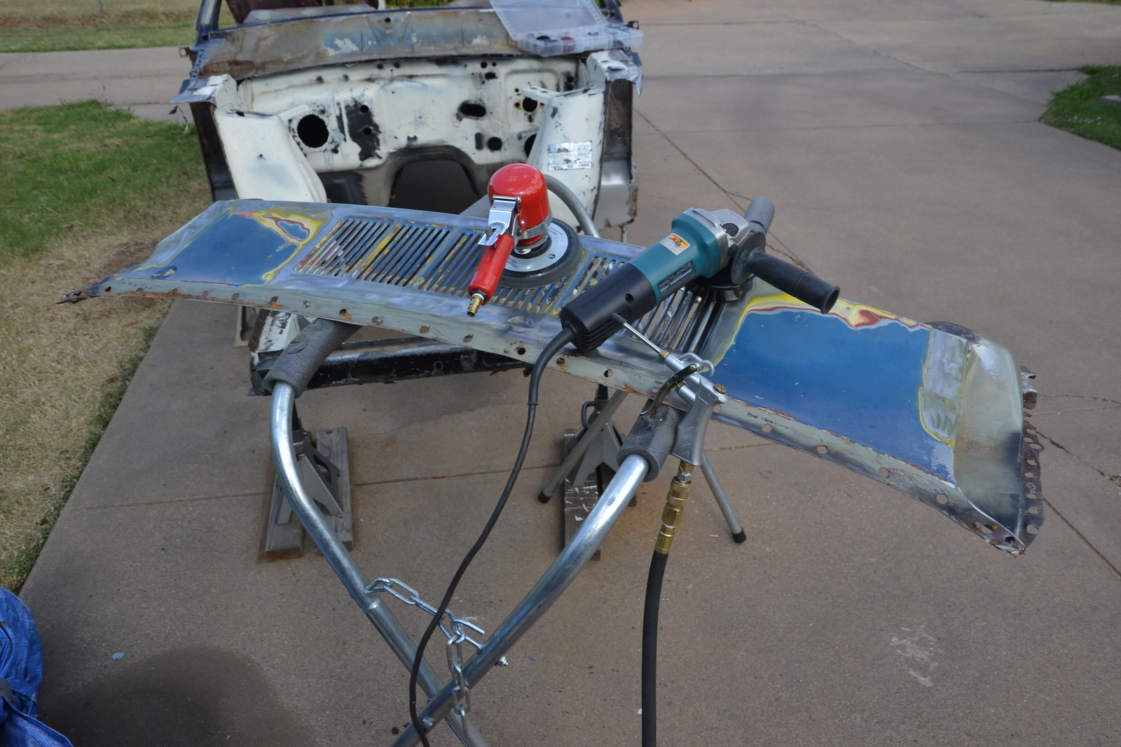

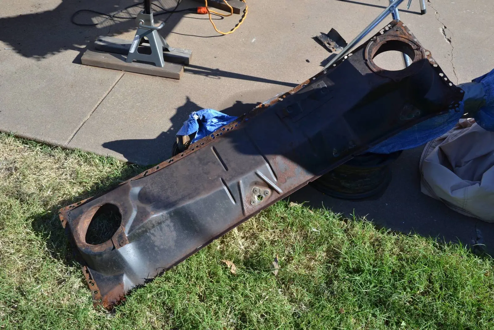

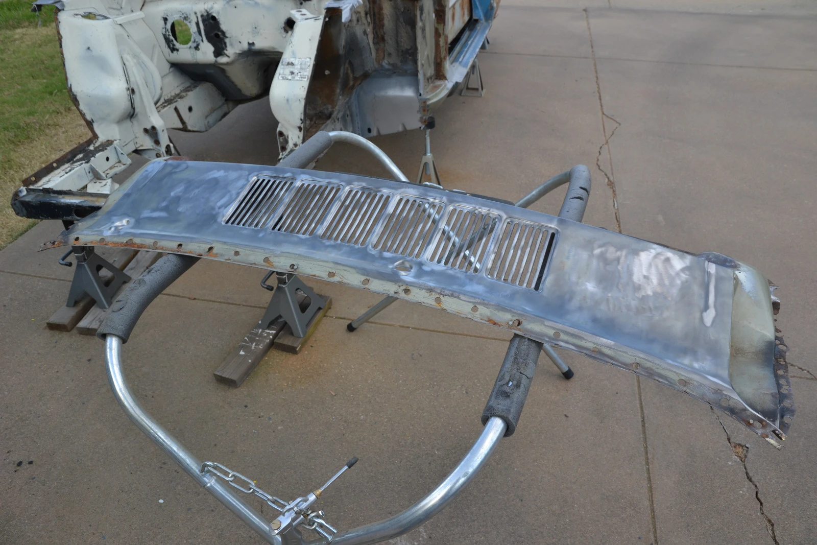

One of the problems with being a lefty is that an angle grinder blows everything toward you. It's discrimination against the southerly-pawed.
Anyway, I got the upper cowl mostly cleaned up today and sprayed some primer and rust-oleum in there for rust prevention.
These little 3M scotch brite roloc discs made quick work of the rust, but didn't last long before they'd get full of rust.
All the rust and scale was confined to the surface. With the underside looking pretty good, I got started on the top since I was sick of looking at that blue paint and yellow primer.
I'm also going to file this under things I never want to do again. This took a lot longer than I thought it would.
Can I get away with sand blasting the rest?
After primer and paint.
There's at least one dent on top I'll need to address eventually.
I also picked this up today. Brand new, never used. Normally goes for $110 at HF. I picked it up for $60.
I'm off vacation as of tomorrow. So work will slow down again. The good news is I'm done with the biggest part of the restoration with the floor installed. Everything else will be smaller projects I should be able to knock out over weekends and evenings after work. Getting the cowl back together is the first priority. I already have the sand blaster, so that shouldn't take too long.

You can blast the rest ,just dont hit the top anymore than you need to
What blasting media do you recommend? It looks like HF only sells glass bead, walnut, and aluminum oxide. Don't see any actual sand.

When we cleaned up the bottom of my car we used glass beads. I put a tarp down to catch as much as possible then used a sieve to get the larger trash out. Worked great.
Thanks. Right now I’m only looking to blast the under dash and firewall area. I plan to get a rotisserie and really clean up the car once we get to Arkansas.

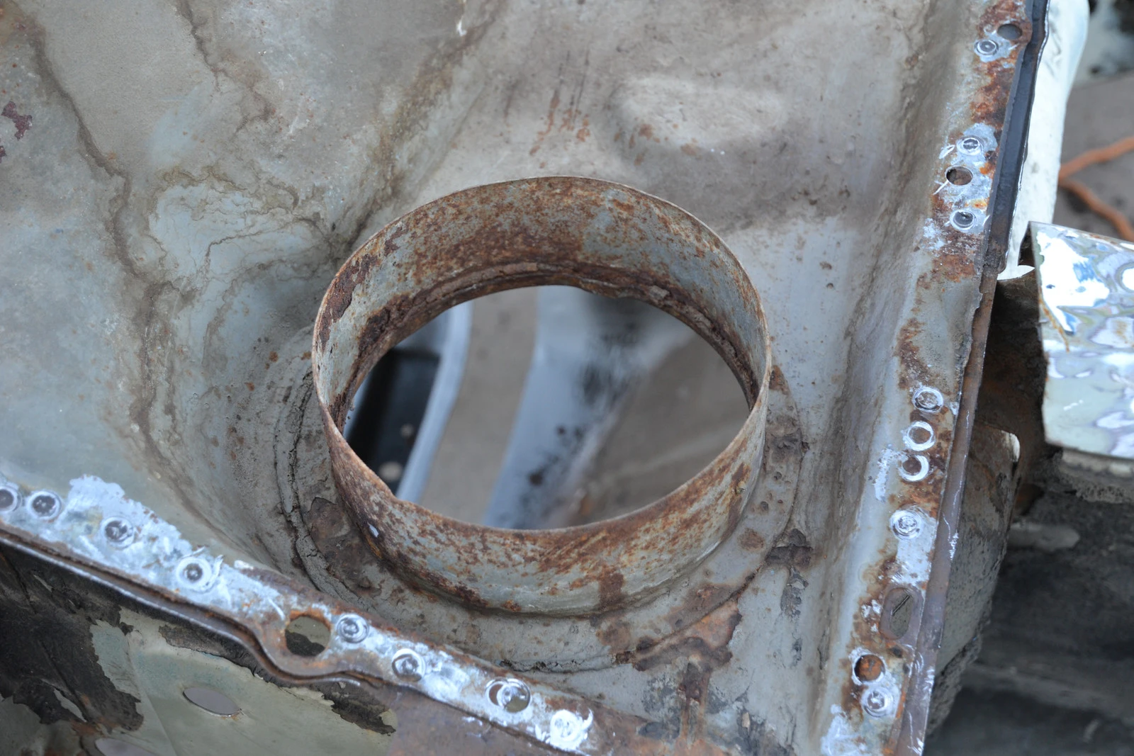

The cowl is in excellent overall shape, however, the vent hats have some small rusted through areas in the vertical sections and the seams where they meet with the lower cowl.
CJ sells these plastic pieces as inserts to "fix" lower cowls that are leaking around the vent hats. I was thinking I might get a set of these and use them to replace the vent hats entirely. Probably use some PBA to attach them.
@horse sence @Davedacarpainter does this sound like a good idea? I was thinking of buying the lower cowl patches just to use the vents off of them, but they're almost $70 each.
