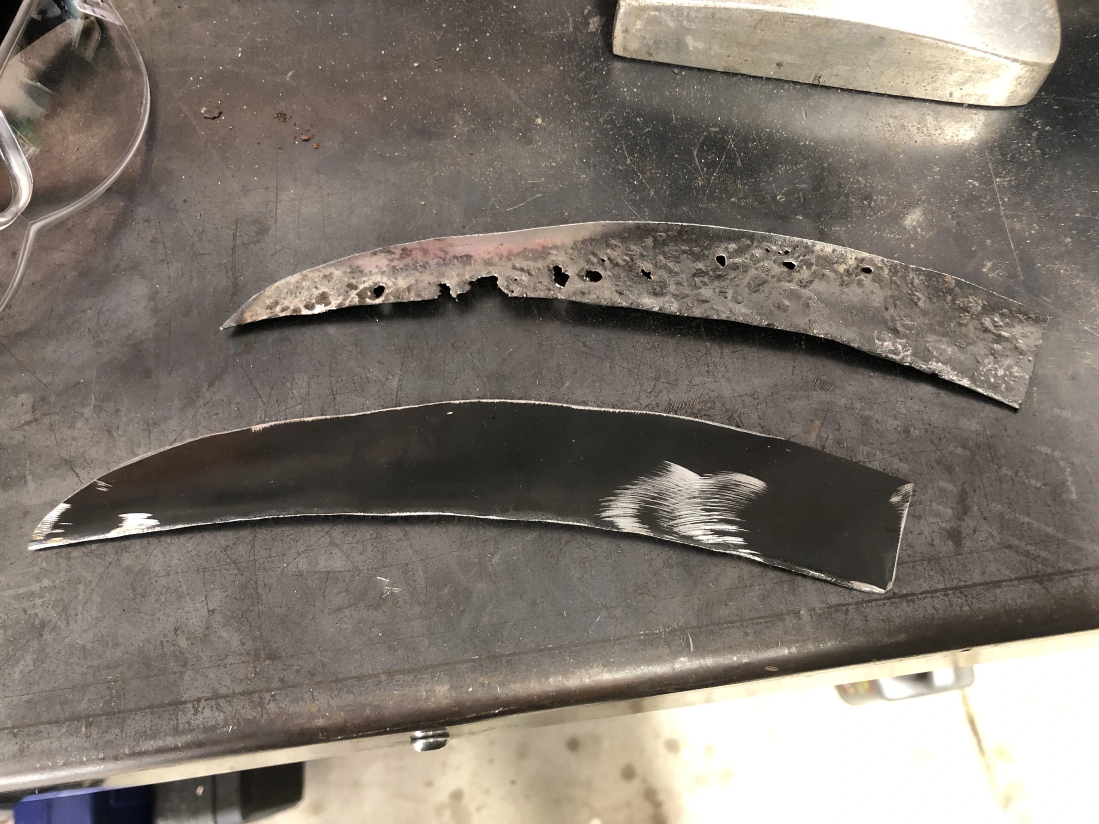

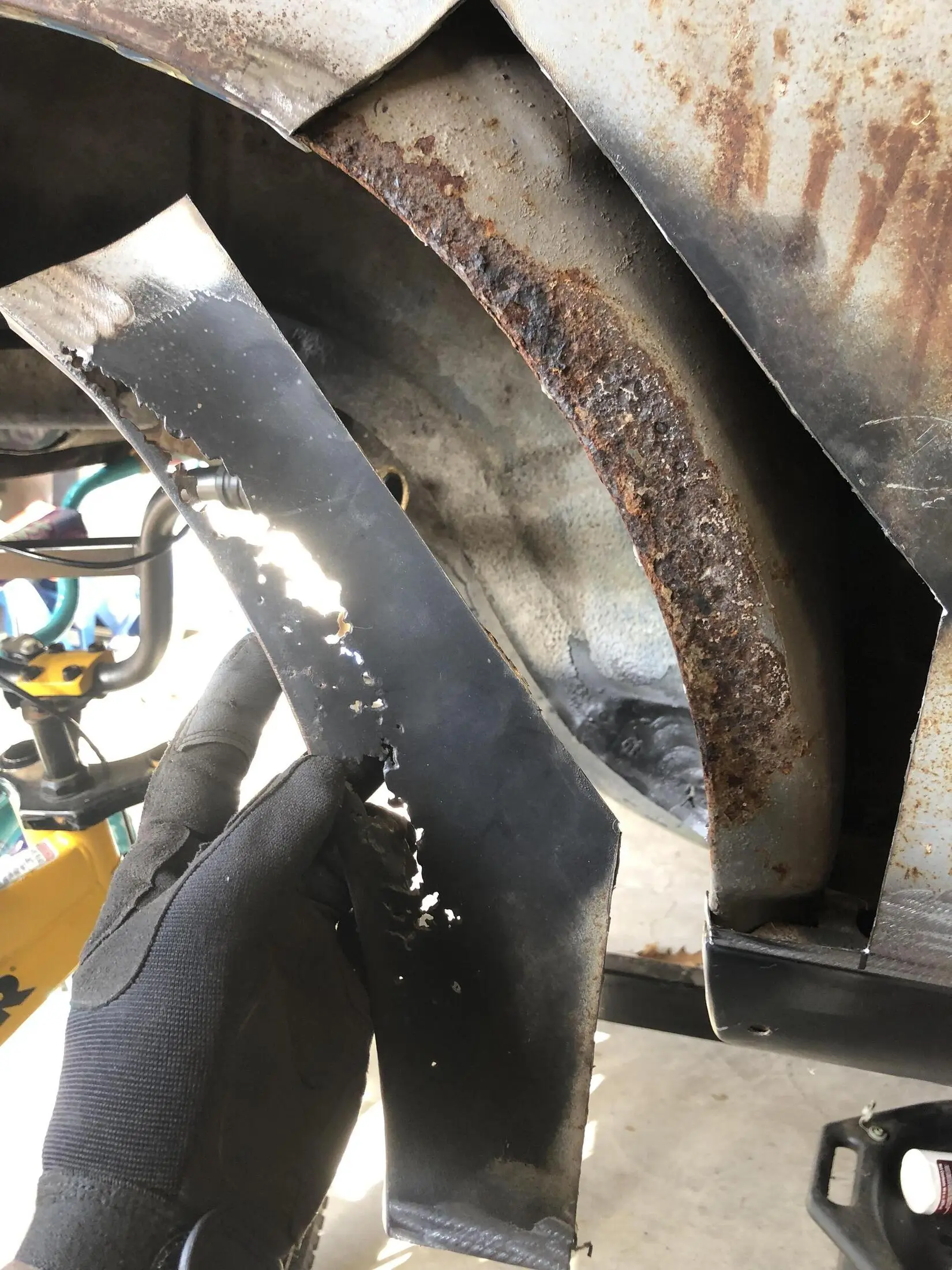

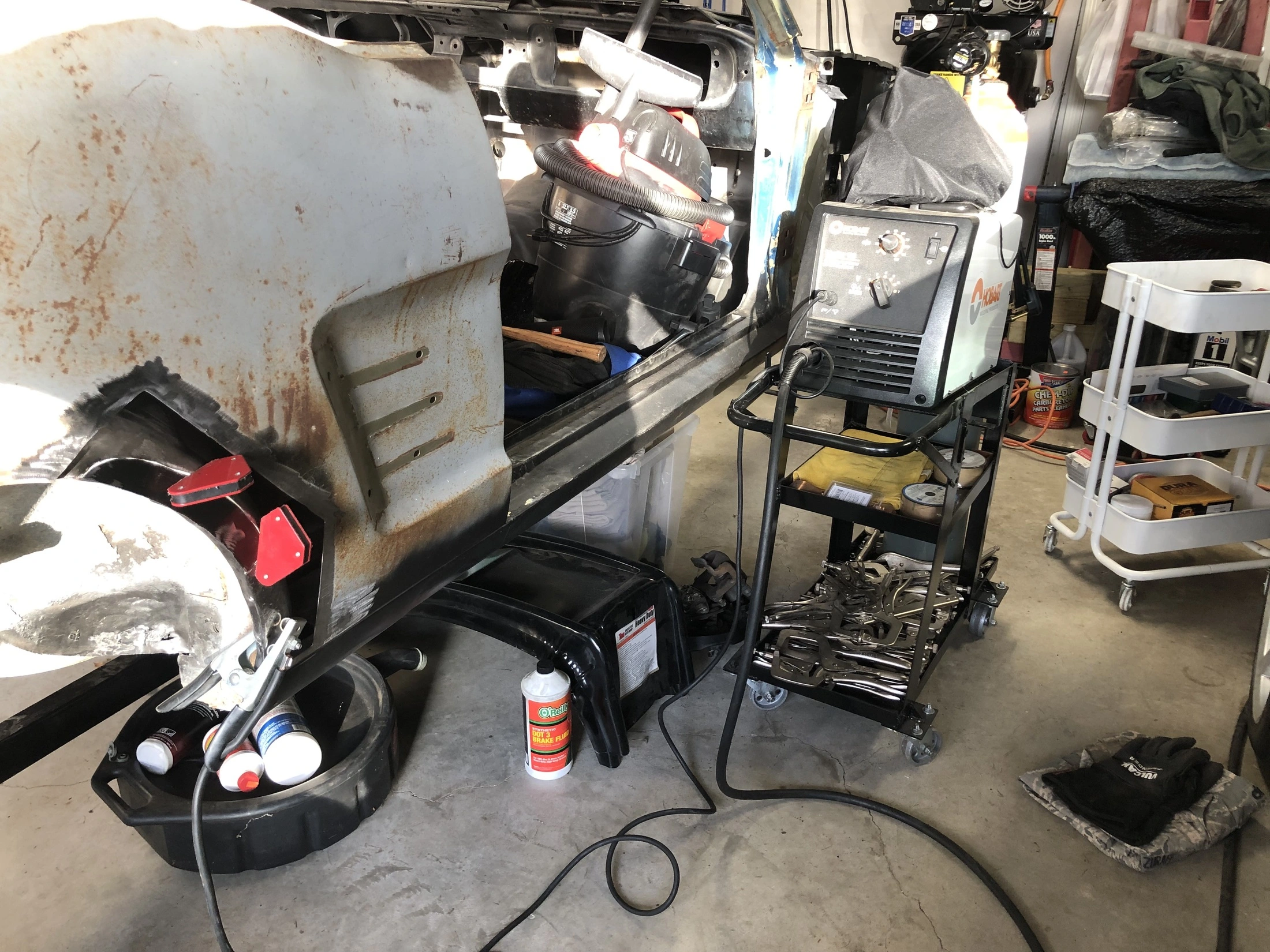

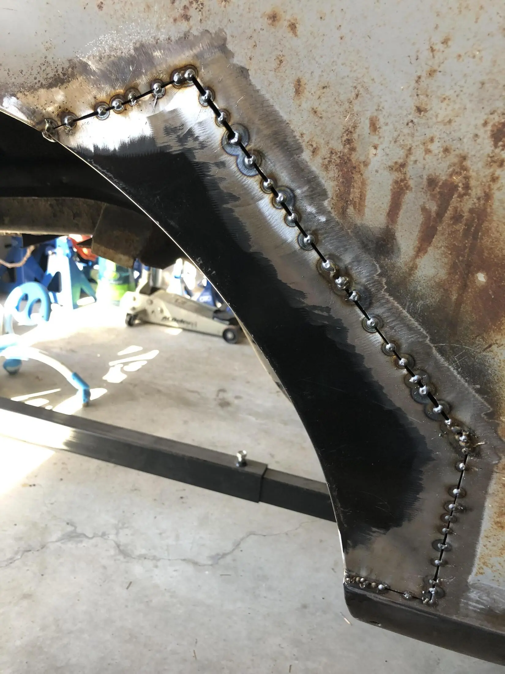

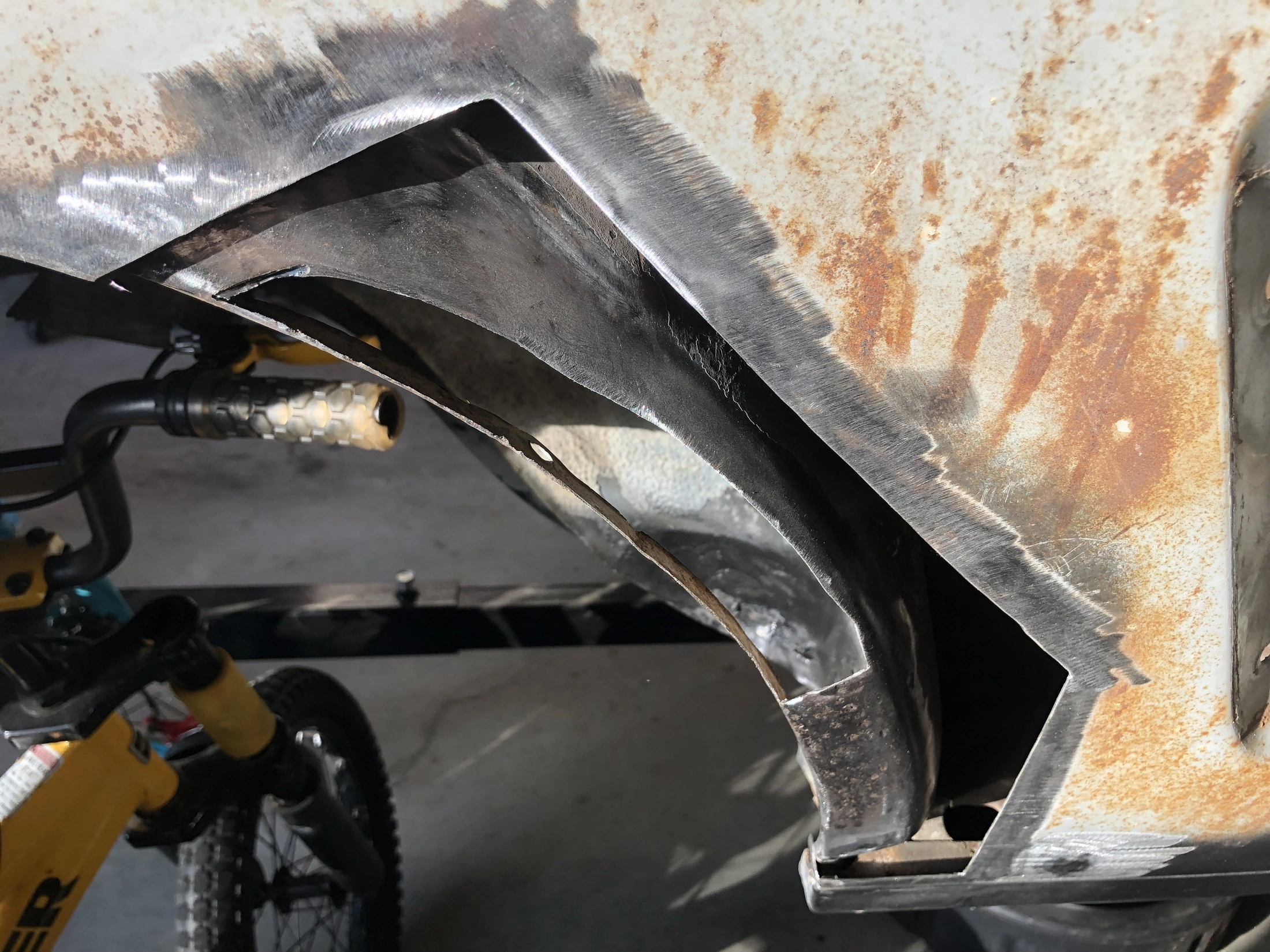

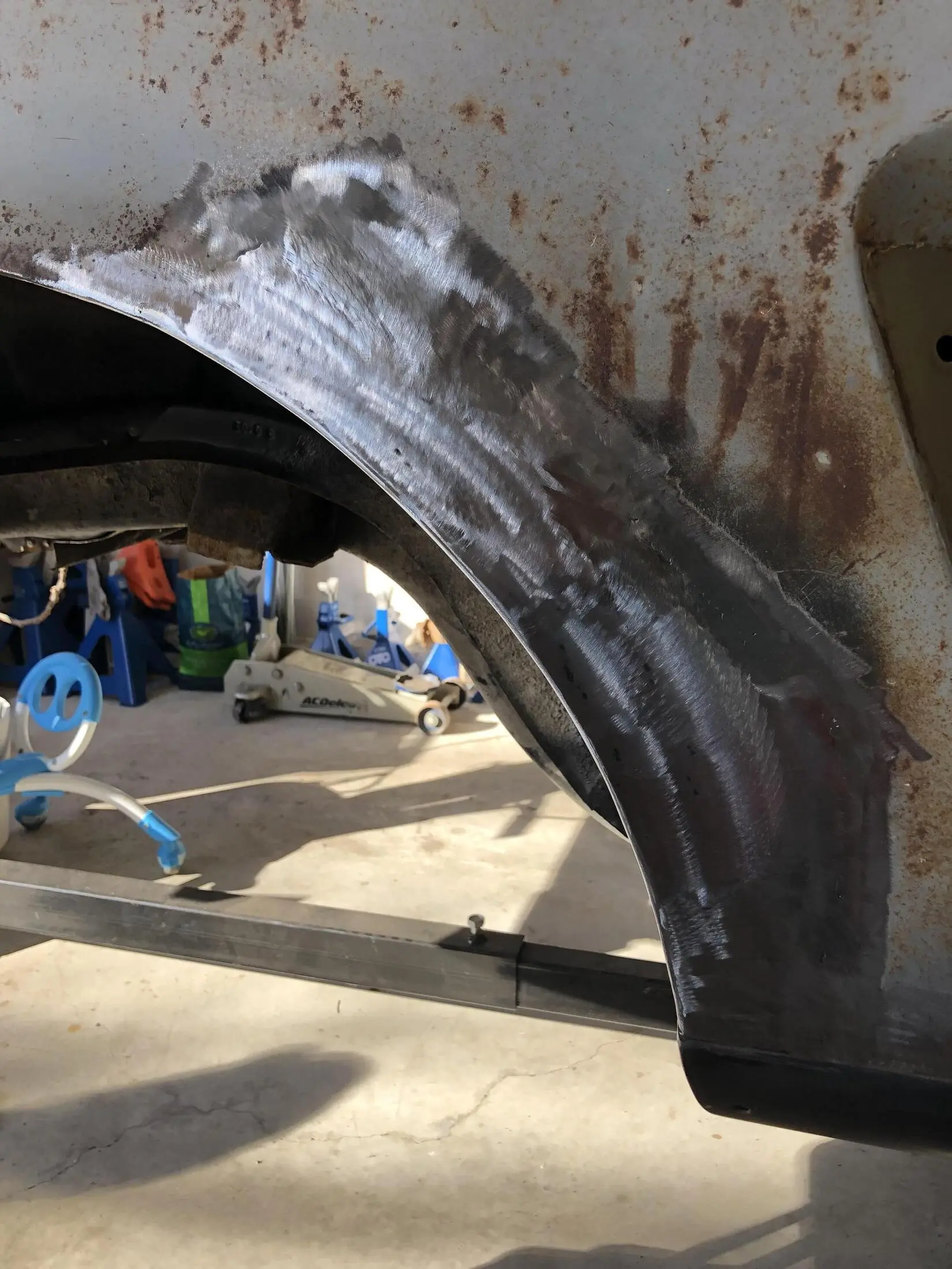

I have been having trouble with the air compressor that made me think the motor or pump was going bad. Turns out it just needed a new belt as the original had become a bit stretched. One new belt later and it starts and runs like new. With my seemingly renewed air compressor running like a top, I decided to do a bit of work. I nearly got the final bit of rust repaired on the passenger quarter.

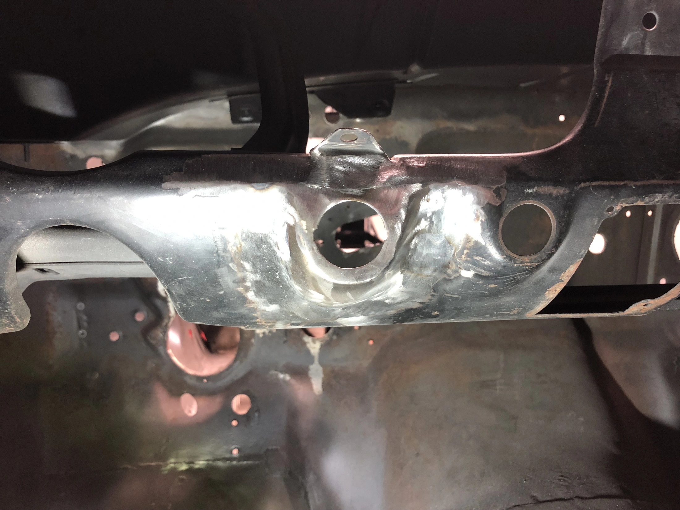

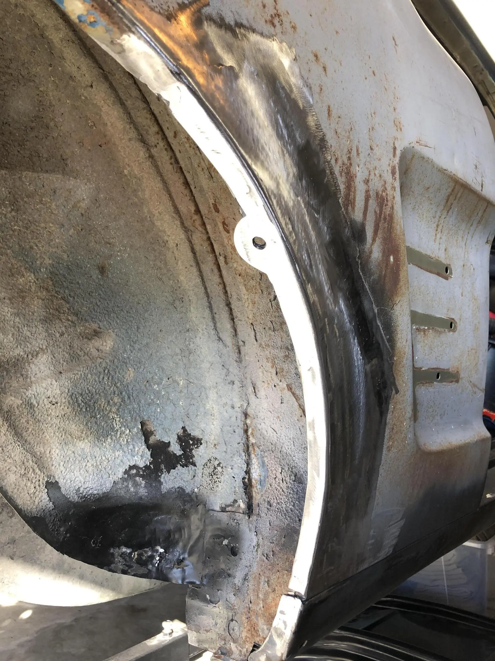

Some of the wheel house was also swiss-cheesed.

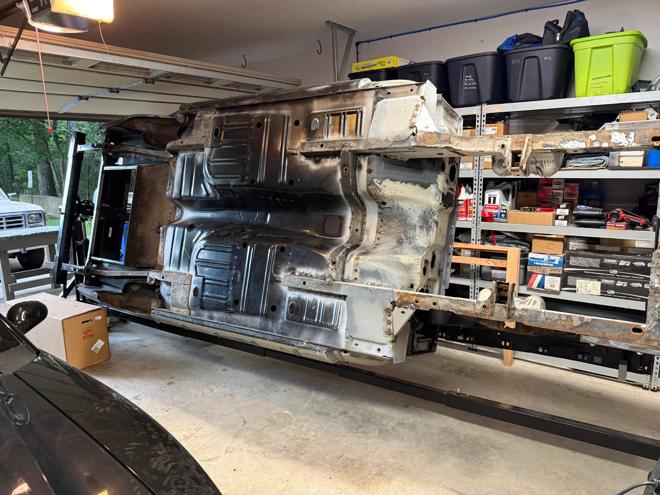

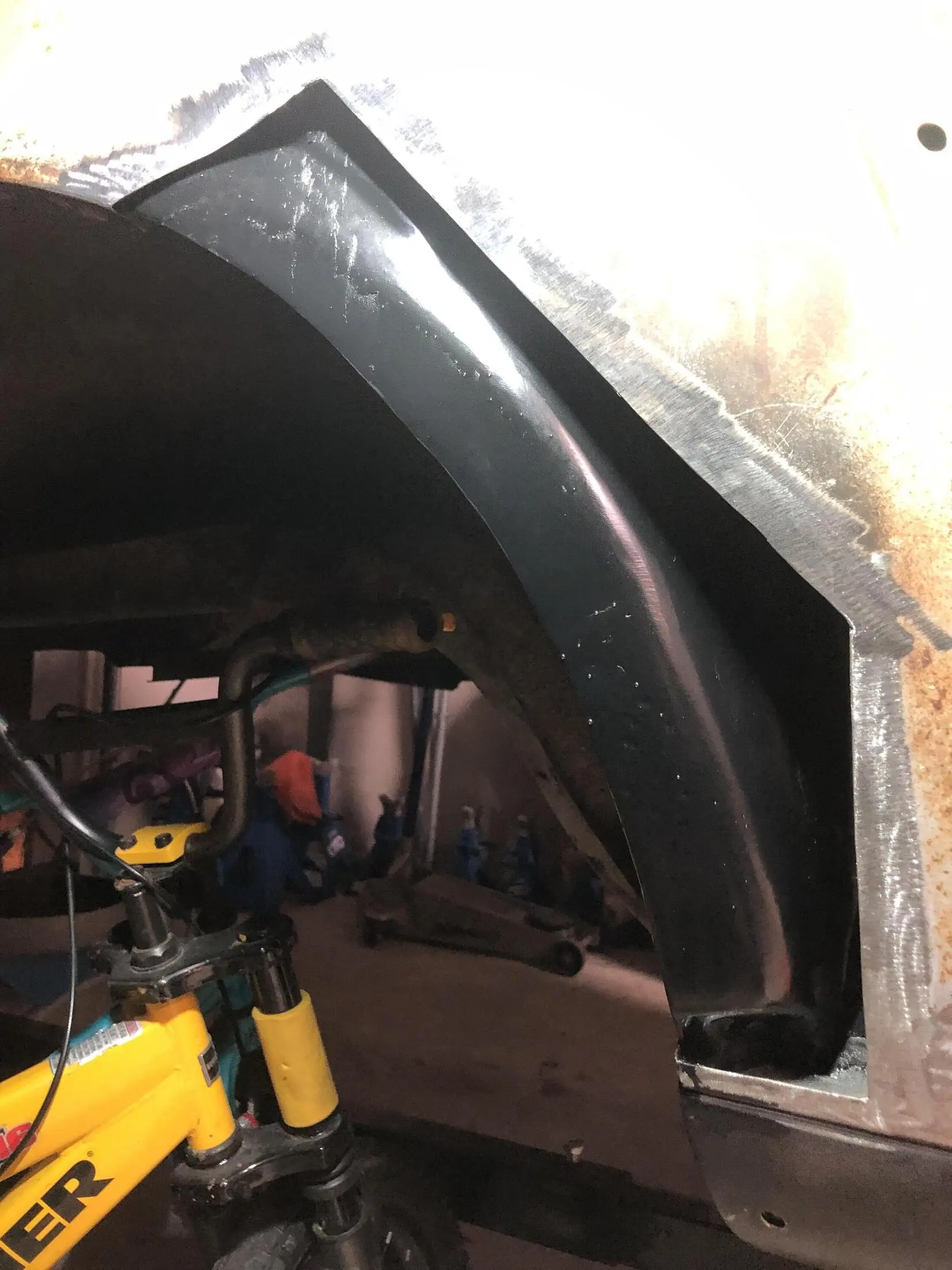

This is where I called it a night. I'll finish this up next weekend, probably. Nice to get some work done.

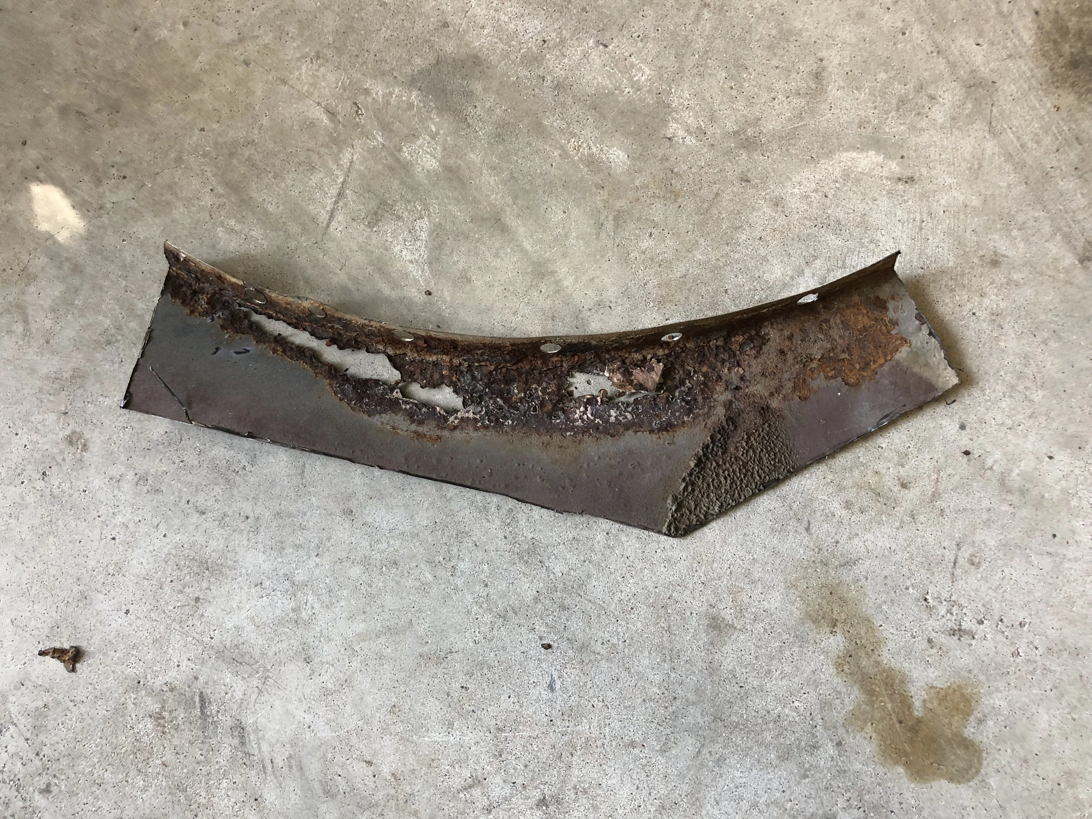

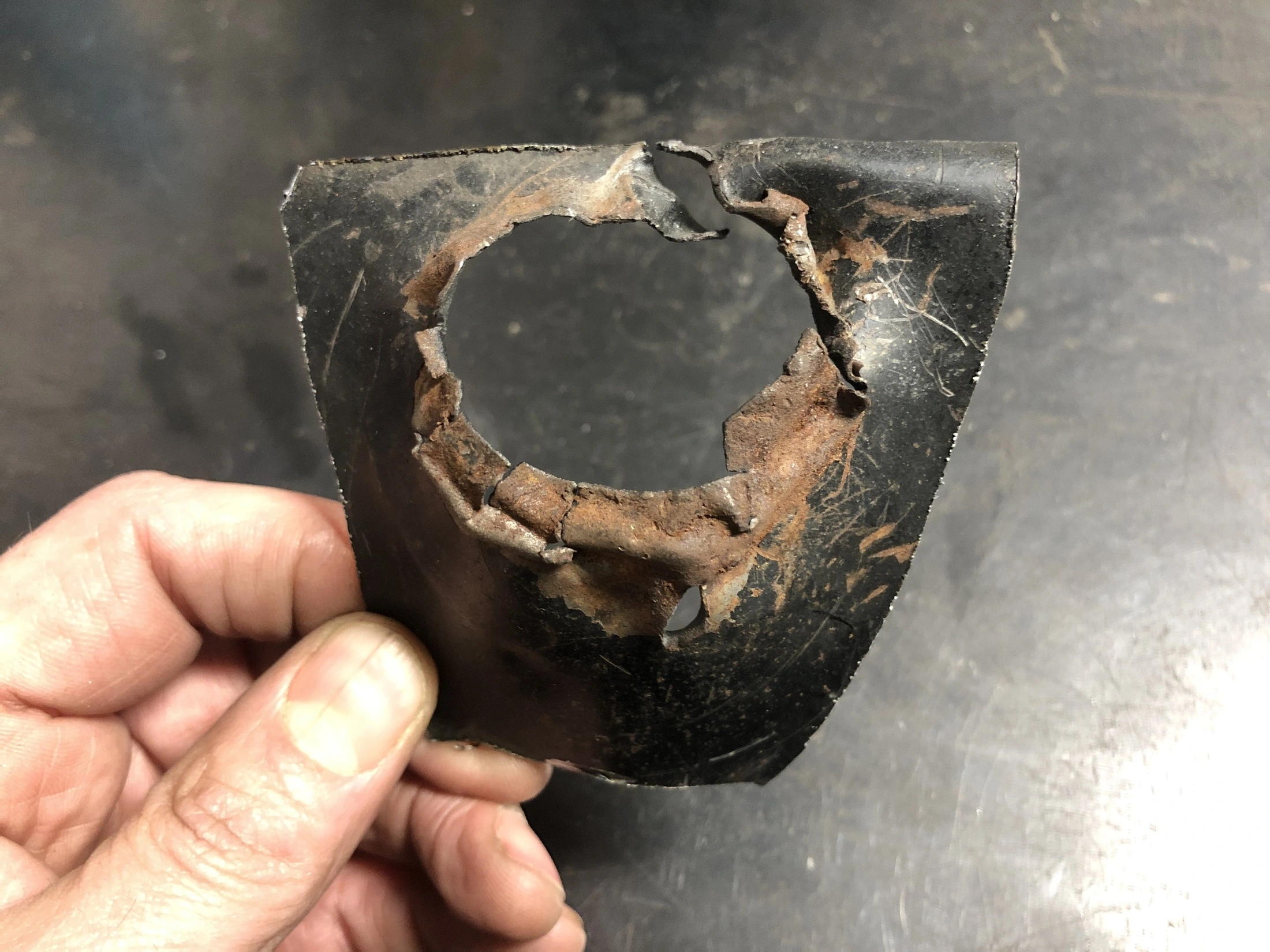

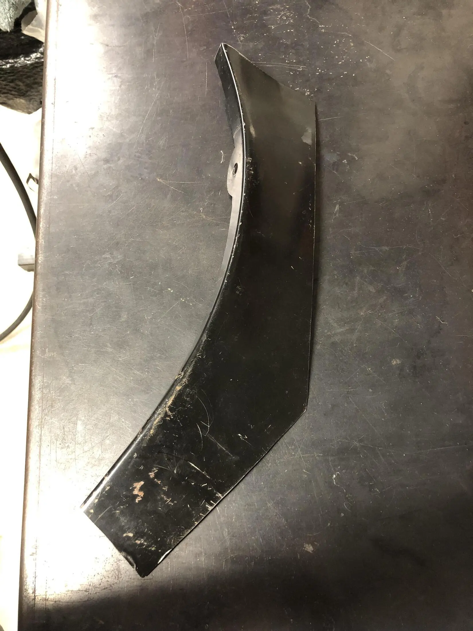

This is the patch that will go in. Sectioned out of a CJ Pony Parts quarter skin.
