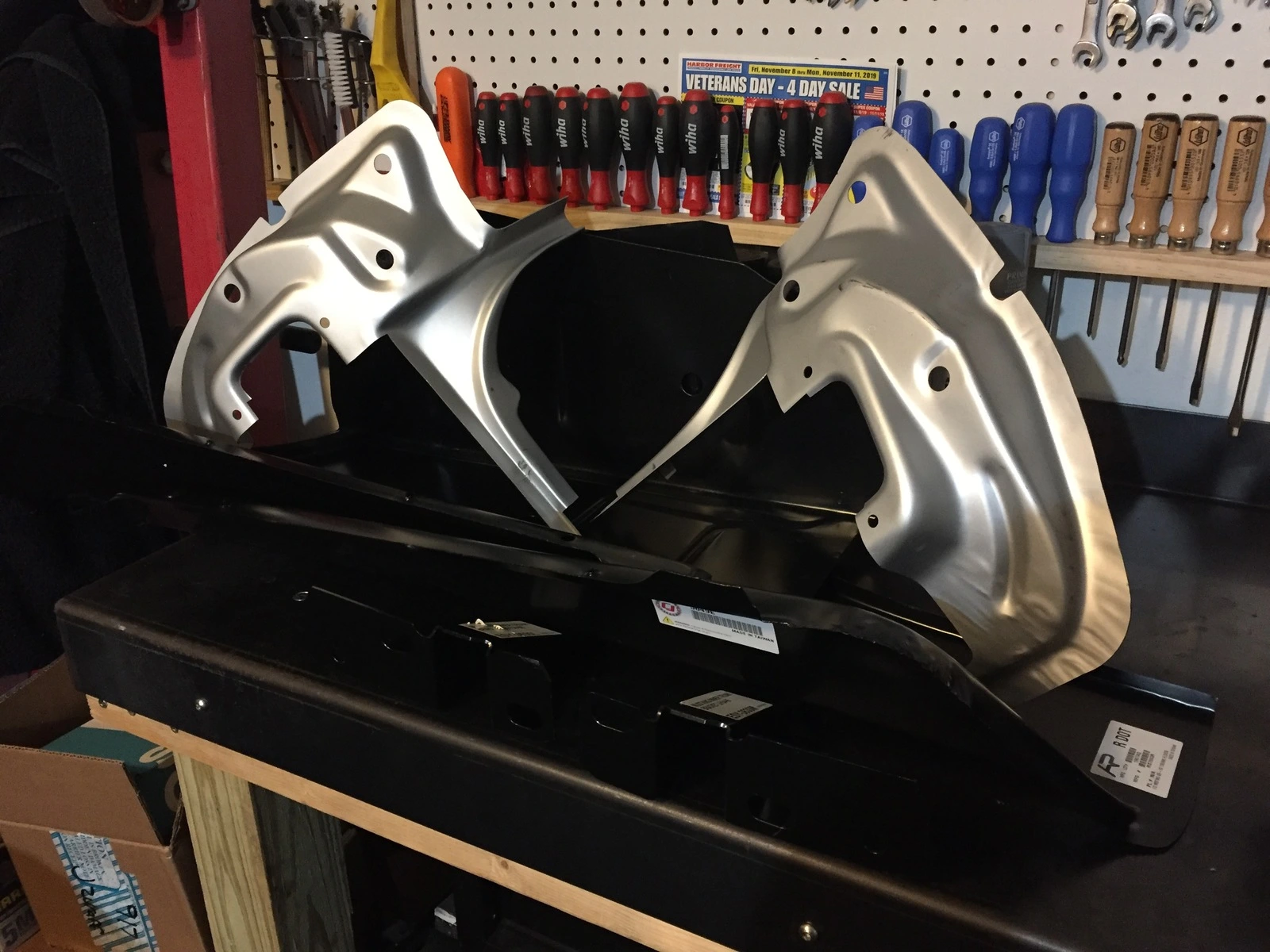

Everything remaining that I needed to rebuild the tail panel area of the car arrived today (extension brackets, trunk floors, bumper brackets, and passenger quarter skin). Not pictured is the passenger quarter panel skin.
I'm thinking I'll start by installing the trunk support. I'll also need to rebuild the flanges for the extension brackets on the driver's side and the upper part of the passenger side (still haven't gotten to that). I'll then do the trunk floors and follow that up with the tail panel. I think it would be best to wait on doing the passenger quarter skin until everything else is put back together to help take some of the guesswork out of making it fit. I'll be sure to bolt the trunk lid back on when I'm working on the tail panel. Can't wait to start getting the exterior of this car back together.

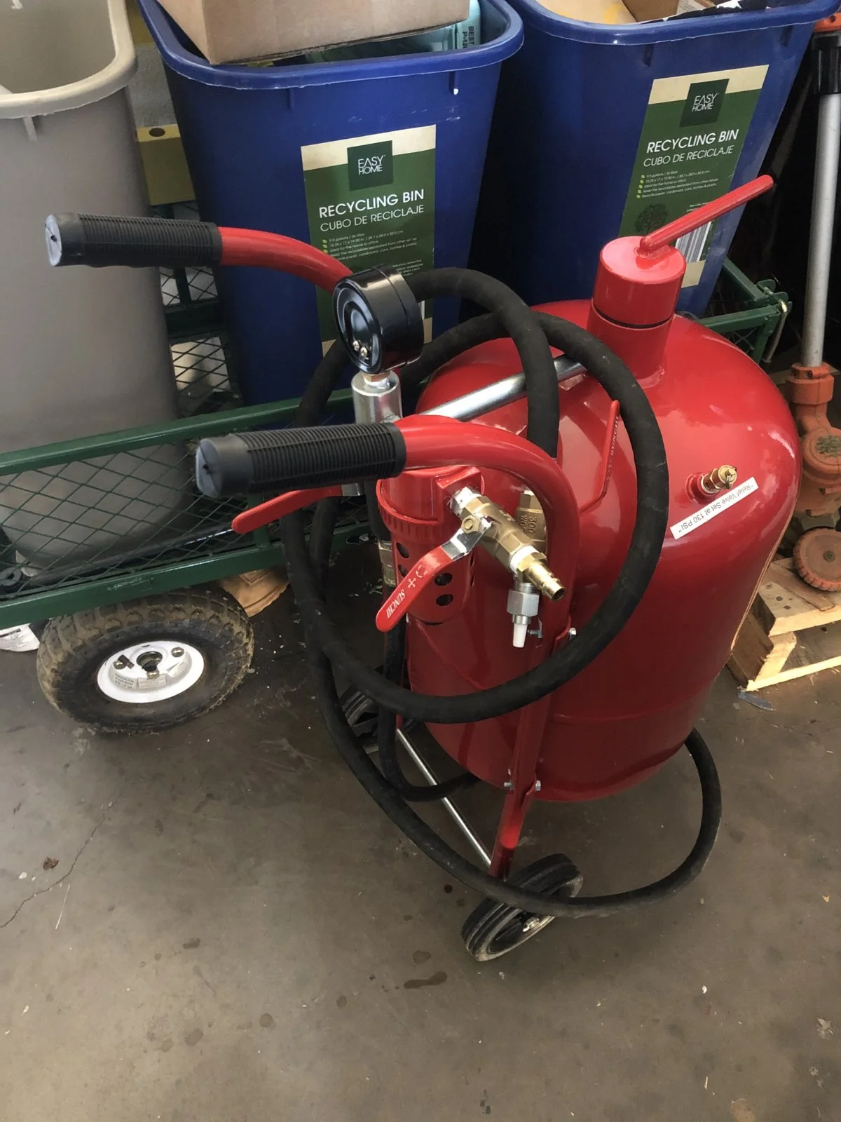

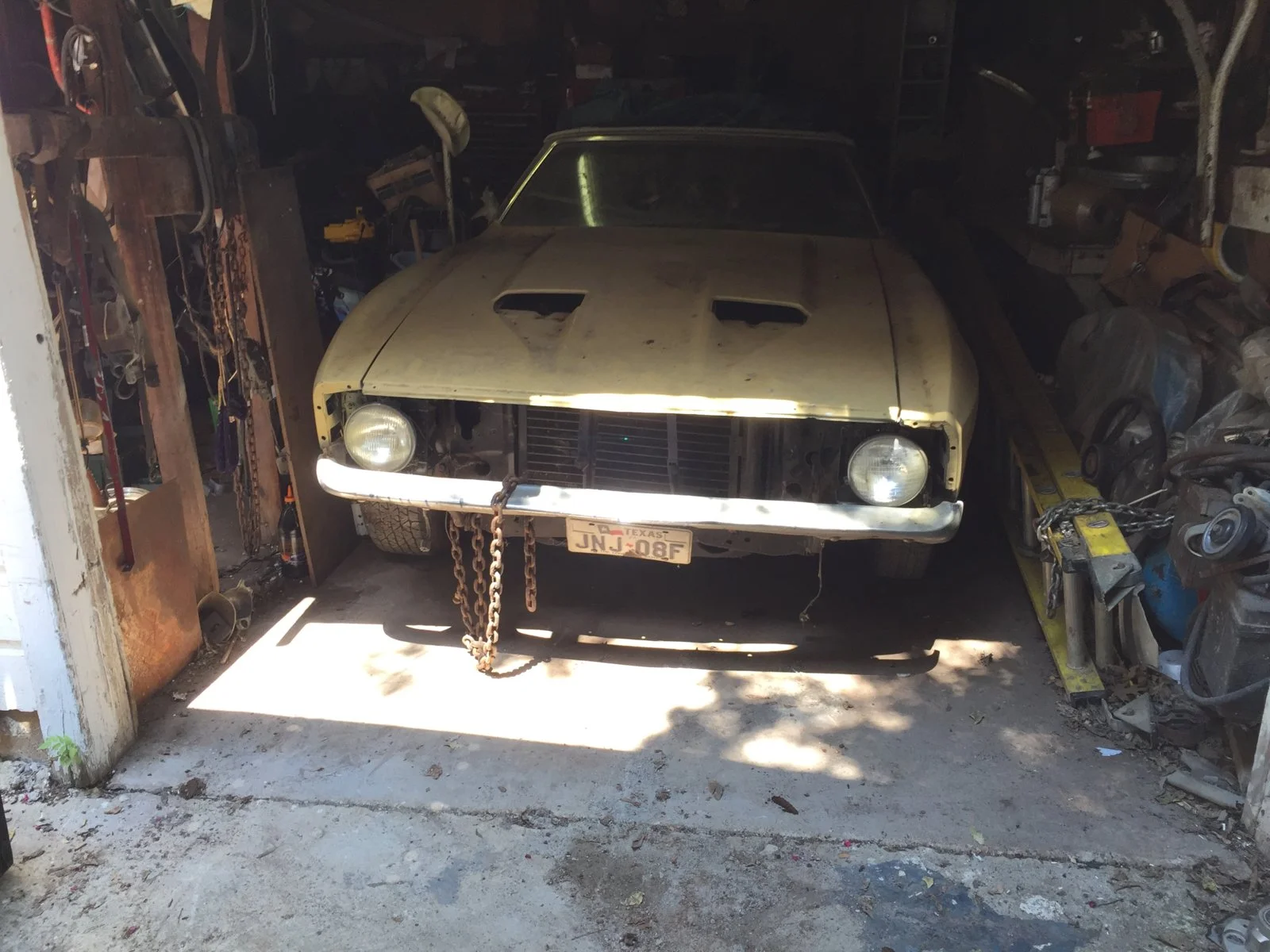

Not related to my car, but I just won an auction for these on eBay!
I'm going to give these to my father-in-law (same one who gave me the '66) in hopes of motivating him to restore the '71 convertible he still has that took the place of the '66 in the same broken down garage.
