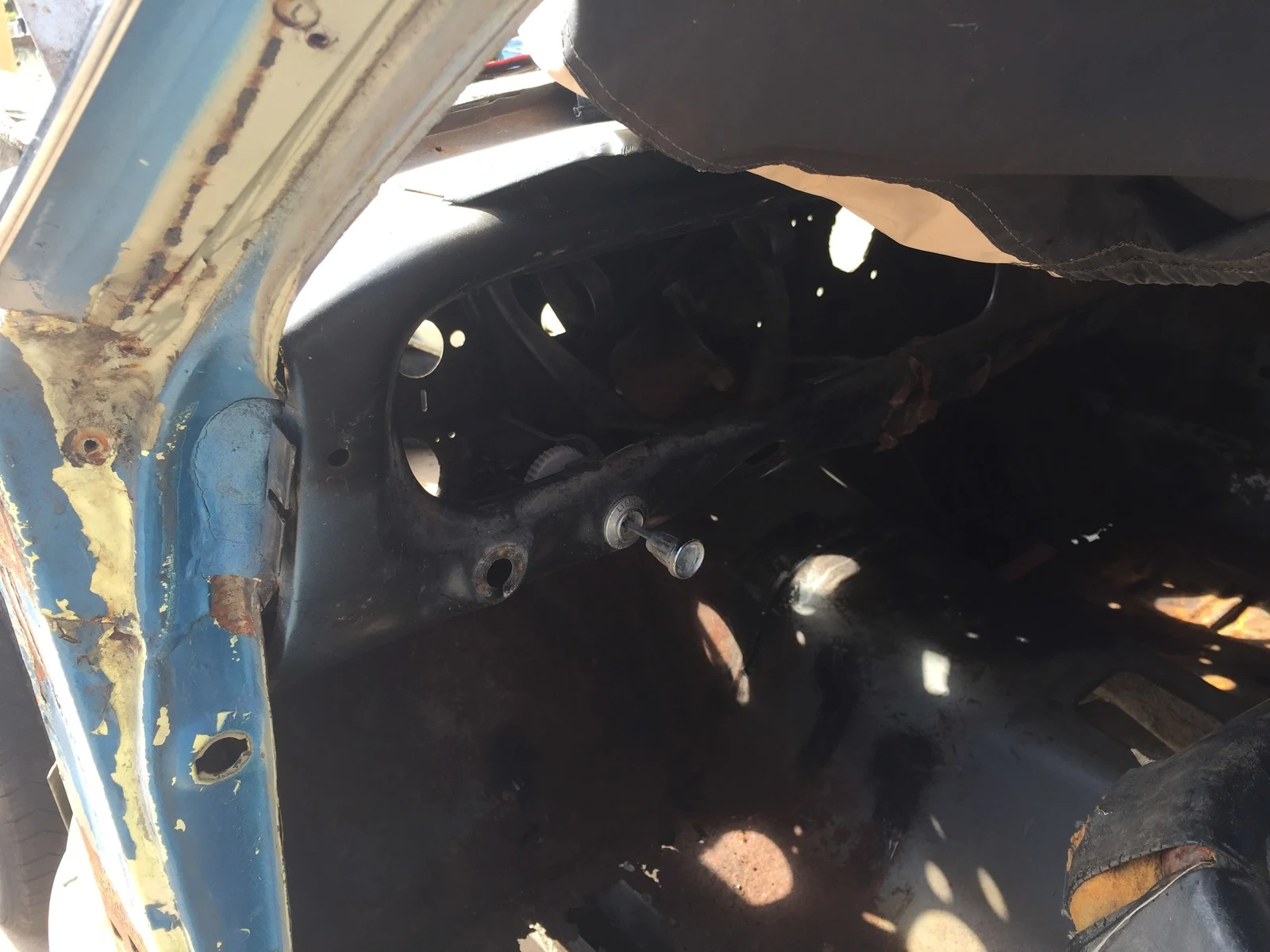

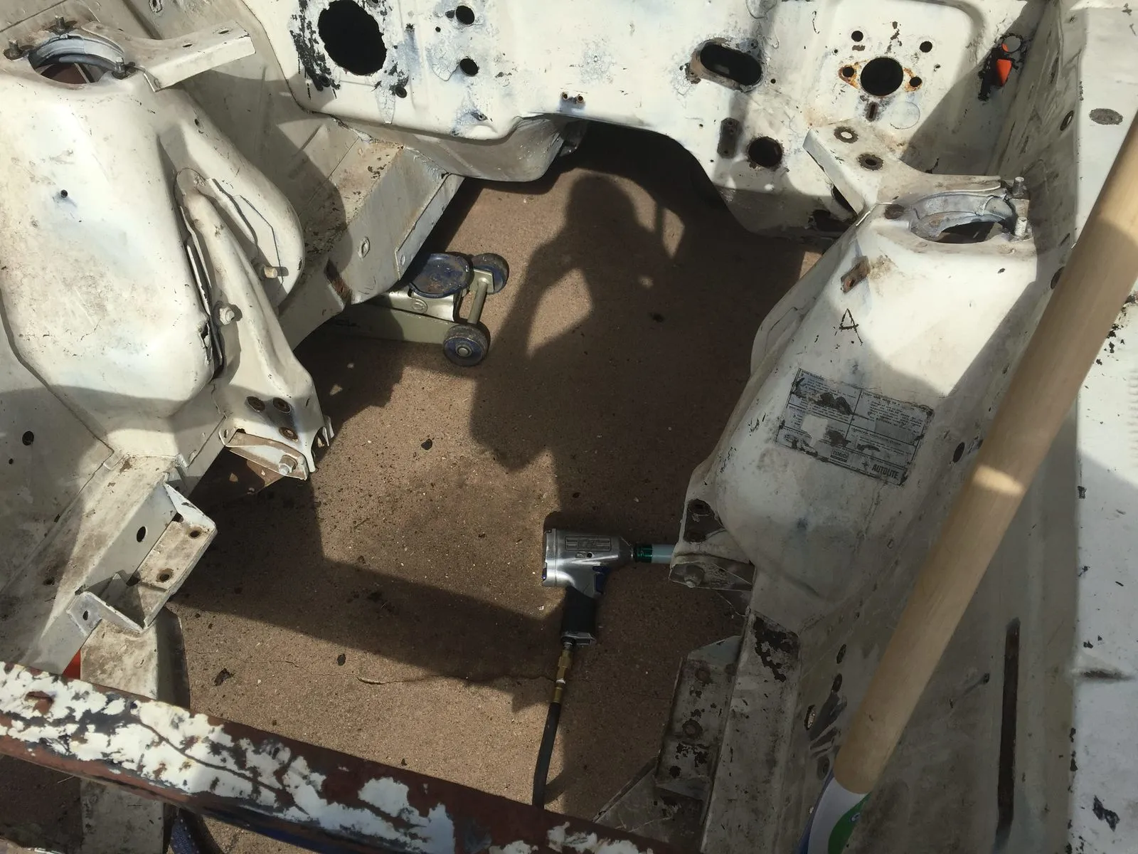

Small progress today. With the exception of the front control arms and rear leaf springs, I've removed everything that can be removed with regular tools.
This one's for you, Dave.
Next plan is to get a bunch of spot weld cutters and an extra set of jackstands so I can start removing the sway bar and torsion bar mounts. In the meantime I'll build my water trap system and get a MIG welder. Hopefully I'll get it blasted no later than next spring.

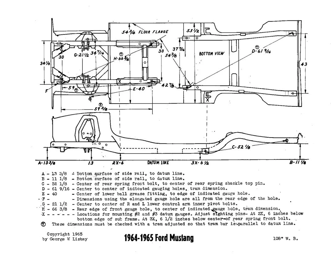

Quick question for @horse sence and @Davedacarpainter
Is there a good shop/body manual you could recommend for this car that includes measurements to ensure the body is square? I was just thinking in the back of my head, what if there is slight frame damage given the evidence of a fender bender and rear end accidents?
Also, should I wait until I get the car media blasted before I get the car level on stands and start removing any sheetmetal? I'm fully expecting to have to replace both quarters with the rust around the taillights and large dents in various areas. I was thinking it might be good to have them off so the blaster can get at the metal underneath.
Snoop around for an old Mitchell manual (s).
Before the dawn of computers we used to have to look things like measurements up in books:eek:!
We’d have our pet dinosaurs fetch them for us.;)
