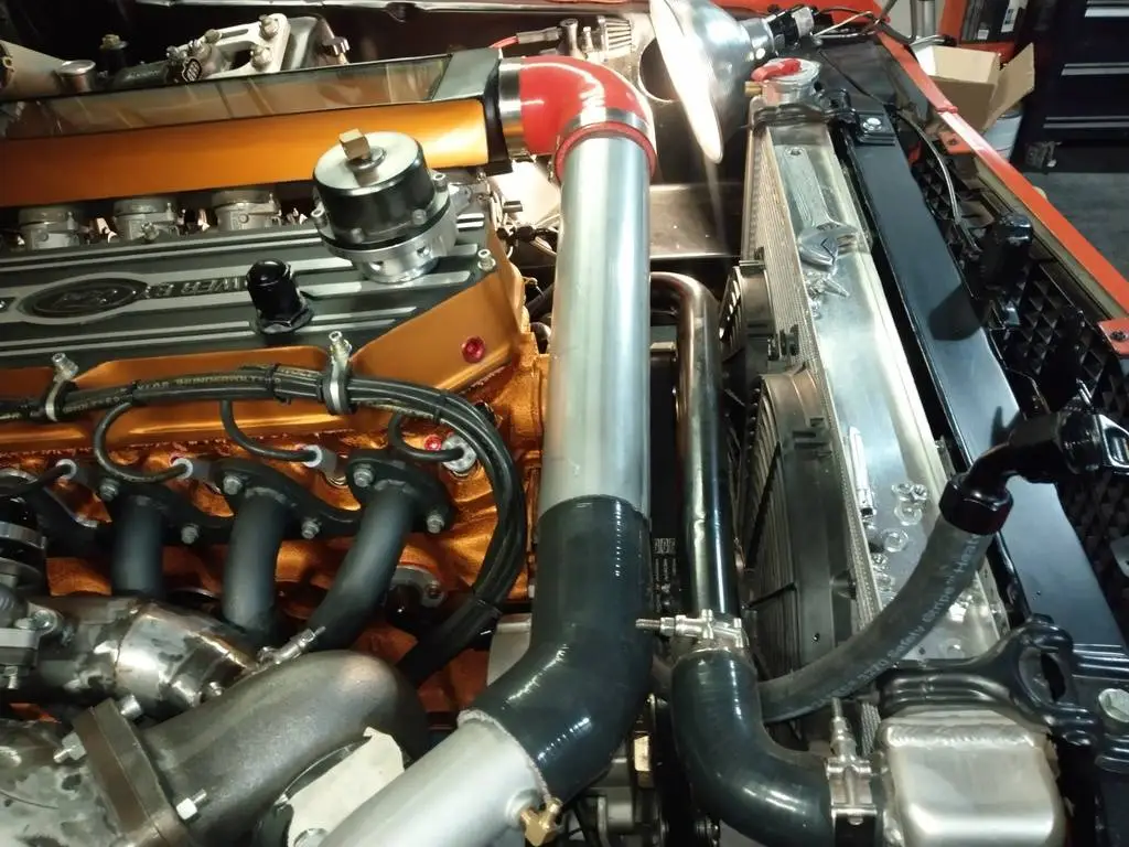

The 10 second falcon that has the aftermarket head measures 273 c.i. and is breathing through one tiny little 450 CFM carb and is still making 423 WHP at 16p.s.i.

Especially Will and Kelly's '63 Falcon, Turbocharged 250, C4, 9", Best ET: 10.64@127mph 11/21/14. This beast started with a 2 bbl 350 or laterly 4-bbl 450 cfm Carb before it went to a similarly restrictive 4150 4-bbl SDS port EFi system.

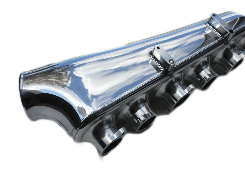

The ITB system works because of reduced air speed, and increase duty time to feed the engine, just like adding long rods, or a wider lobe center cam on an engine. Adding intake runner bends and restrictions always meters an engine, and pefroamce loss is a result. The Aussies found that adding cam duration within certain limits, adding intake volume to the EFI plenumb, and being free to take away or add ignition advance and fuel (witin limits) allows you freedom to get more power with less boost. within limits.
The idea is the same as running 2.5 " pipes instead of 3" to and from the inter/aftercooler. Its the same issue bandied about when you go for Four 2-bbl Weber IDA's on your 302 when you can do and reach the same horspower levels with one 4-bbl carb. Or toing down the came to avoid turbo surge. You change your turbo type, and dodge th turbo surge bullet by doing something better for performance. On a 6 ITB Normally aspirated EFi car, the air intake volume and intakes are made large.

I'm sure a Small block V8 or 460 Lima or whatever runs real nice with a restricted intake, but its not an ITB.
