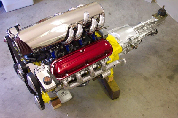

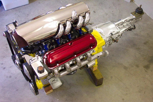

I don't want to hijack what is possibly the greatest SNC thread and project of all time here, but for the record....
He does all of his own fabrication, he's a complete artist at it like you. Just a different type of project is all. Here's a few shots of his work...
IRS
Dash
More
Motor
A link for his posts here on SNC:
http://forums.stangnet.com/search.php?searchid=664976
