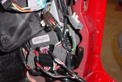

Also, another wiring item I can't figure out is the use of two grey, two prong plugs in the under dash wiring harness. They are located to the far right and the far left among all the connections right at the kick panels. Any ideas???
Just a guess but, speaker connections? I remember my old 79 had gray 2 prong plugs for speakers. Without looking at the harness, hard telling. I'd try and get a look at a manual at a dealer. Just about everything else is grouped in a larger connector. Afterthought, maybe courtesy lights? I'm just guessing here.

I was thinking the same thing as RacerX, either speaker wires (should be easy to tell by their color), or courtesy lights, which would be easy to check with the dome light.

Here is a photo of the connector in question. It is the grey one in the upper right. There is one of these on both sides of the car.

I parted out a 95GT a few months ago, I seem to remember those being for the lighted vanity mirrors in the visors. I could be wrong because I wasn't paying much attention to them during teardown. I will check my parts when i get home.

Power side view mirrors??

Are you guys sure that isn't for the Airbags? I remember having to use somthing like that to reset the airbag computer.
restraint and air bag related connections are most always yellow, my guess would be if they are grey, they are for speakers, but then again most all of the connections on my mountaineer are grey

The connector that I have on the passenger side of the dash is grey and has two metal connections in it that you jump together to clear the Airbag computer. When not in use it is just hanging there. Still not saying that is what you are looking at, but that is what it reminds me of from looking at the picture.
