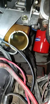

Finally got the car out of the garage this afternoon and took it around the block. I've got to get it to a shop for an alignment. The brakes are soft so I need to bleed the system. Thought I had it sorted out, but obviously needs more work. The temp shot up just going around the block but if figured it would have air in the system. It did. Got the air out and it ran nice and cool. Considering all the things that have been changed or replaced since it last moved under it's own power it's no surprise that it's not ready to go cruising. The power steering was kinda whiny and jerky at first but it smoothed out pretty quick.
I did not use the Ford power steering fluid when I put everything back together. Since doing that I've read on here that the stuff at the parts store doesn't always work well in the older Fords. If it gives me trouble I guess I'll try flushing the system and putting Ford fluid in.
Everything in the power steering system is new except the pump. I rebuilt the pump. When I put the new fluid in it was almost clear. After just running it to work the fluid in I noticed that the fluid changed to a gray color. Is this normal or do i need to flush it?
I used O'reillys brand power steering fluid. The hoses all came from LMR along with the rebuild kit. The rack came from Rock Auto.

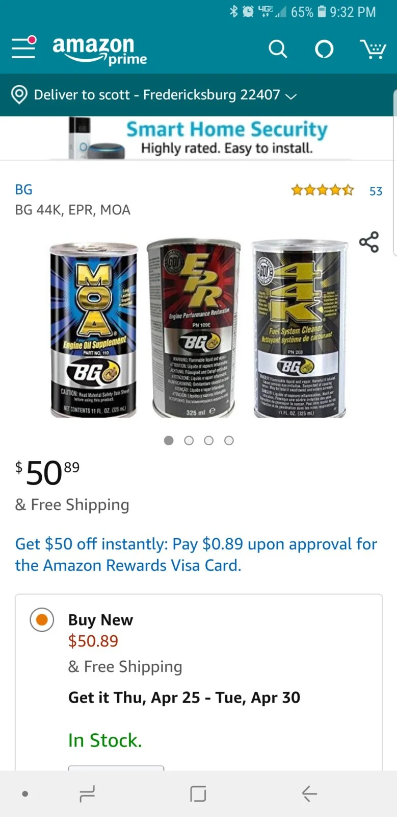

The only thing I've actually seen take a lifter tap out of anything is the BG engine treatment.
I don't really believe in additives though. If it was my car I'd pull it apart and replace all the lifters.

Finally got the car out of the garage this afternoon and took it around the block. I've got to get it to a shop for an alignment. The breaks are soft so I need to bleed the system. Thought I had it sorted out, but obviously needs more work. The temp shot up just going around the block but if figured it would have air in the system. It did. Got the air out and it ran nice and cool. Considering all the things that have been changed or replaced since it last moved under it's own power it's no surprise that it's not ready to go cruising. The power steering was kinda whiny and jerky at first but it smoothed out pretty quick.
I believe it calls for Type F ATF in the power steering system.
Thanks for the advice! I'm with you on the break it down and replace the lifters approach. I've had the car for almost a year now and put, for me, a lot of time and money in it. Really just want to get a little fun time in! Then break it apart this fall/winter. What's the worst case scenario if I wait to replace the lifters for awhile and it gets worse?
Yeah with ya on that one too. The stuff I put in it claims it's good for all domestic and import cars. Wasn't sure if these cars are a little pickier! After running it a little more it seems better. If it doesn't clear up I'll hunt down some genuine Ford type F and flush the system! Thanks for the reply!
NP ...... I recently replaced some PS hoses and topped off with the F/ATF. Not sure if that’s what was in it. It’s on the list to flush it and get all new in there. But for now, my leak has stopped!
