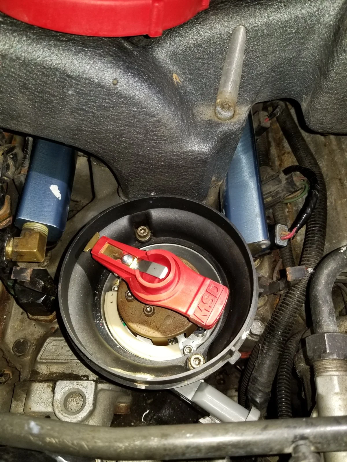

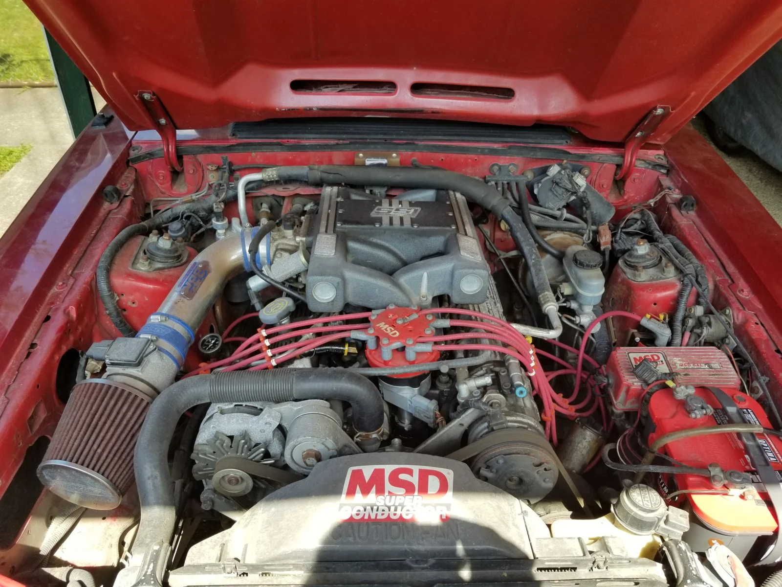

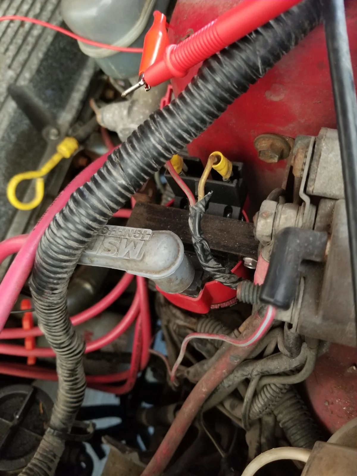

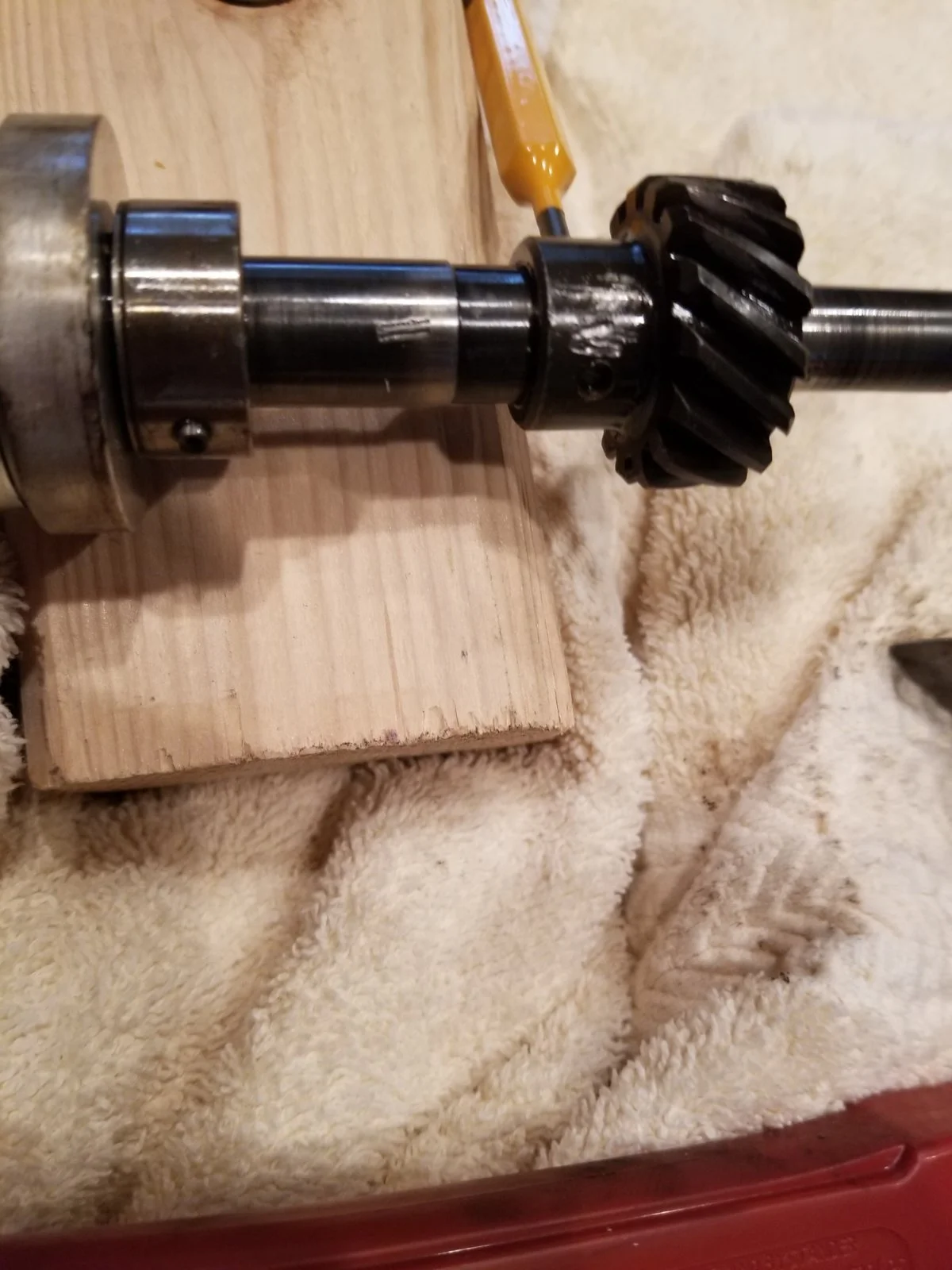

The first thing I wanted to do was get the car running. No reason to spend a lot of money on other stuff if it had a blown motor or something just as bad. I've never owned an Optima battery, but the car came with a red one. It is date marked 2013 so I figured it was trash, but put a charger on it anyway. After letting it charge over night I hit the key. Sure enough it turned over strong. Not to drag out the battery thing, I still have it on the car and it seems to be awesome. The car turned over and would hit about once every few revolutions. There is a pressure gauge on the inlet fuel line and I was getting 40# of pressure. At this point I came to the forum for help. You can read the details of that story here: https://www.stangnet.com/mustang-forums/threads/1990-lx-5-0-not-starting.903806/
After a lot of help and trouble shooting. I ended up changing the plugs along with a new MSD cap and rotor. The major culprit was the pickup in the MDS distributor. I know that thing cost someone a lot of money, but I haven't read a lot of good things about them. I pulled it out, knocked off the drive gear, pulled everything apart and installed the new Motorcraft pickup. In the picture of the engine above you can see and MSD 6 AL ignition. I thought it was hooked up. Turns out it had been disconnected at some point and was just mounted there. After I got the distributor back in the car it did fire up and run, old gas and all!

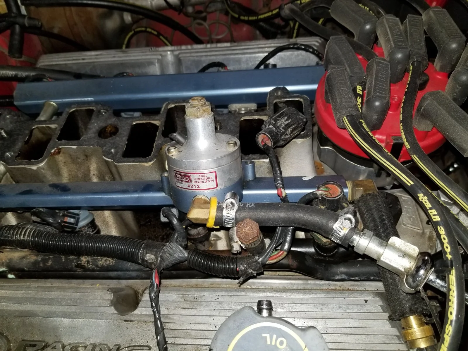

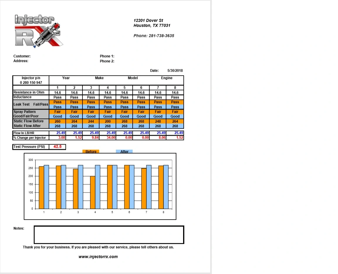

I don't have a good picture of the injectors, but they are blue 24# injectors. Just as a precautionary measure I pulled them all and sent them to a place in Houston called InjectorRX. They cleaned, refurbished them, and flow tested. I've attached the report. This is a good point to mention that the fuel hose on the supply and return going to the fuel rails both started leaking and had to be replaced. you can see the new hoses in the picture.
96pushrod
Advanced Member
May 15, 2018
828
499
73
28
Savannah
How much do they charge for this service?
Olivethefet
Slap me as well as point and laugh
May 17, 2018
1,788
1,199
123
39
Enterprise AL
$155. You can break it down by injector. This might not have been the most economical option for these injectors, but I believe the cost is relatively flat for most injectors. Nice people and easy to work with.

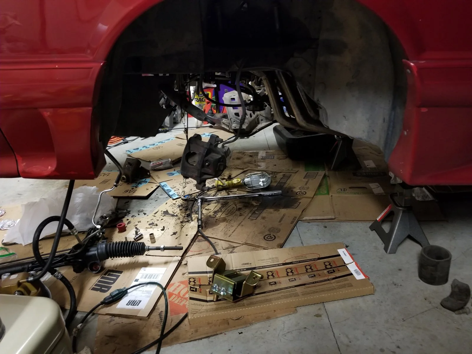

Well at this point I'm just trying to put together the narrative of what I have done so far. At the moment I'm redoing the front suspension and replacing the oil pan gasket and front main seal. The K member and everything is off the car at the moment.

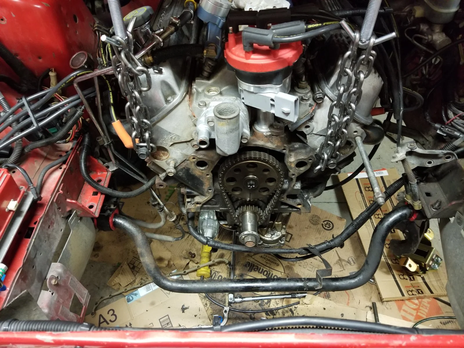

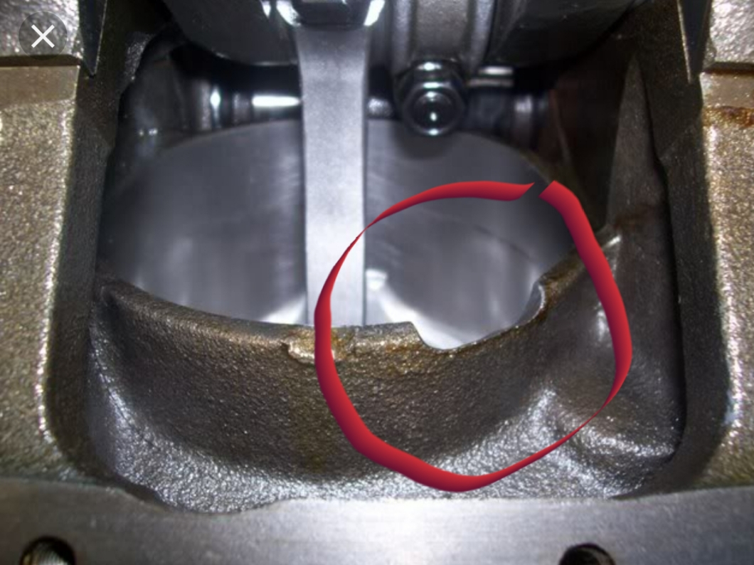

That's awesome man. Now you can see if it really is a stroker engine. If the bottom of the cylinders have been notched then it's a stroker.

That is awesome! I'm glad the pan is still off. I'll get under there tonight and take some pics. Getting into engine internals is out of my wheelhouse.

This is what your looking for...
This is not my pic....

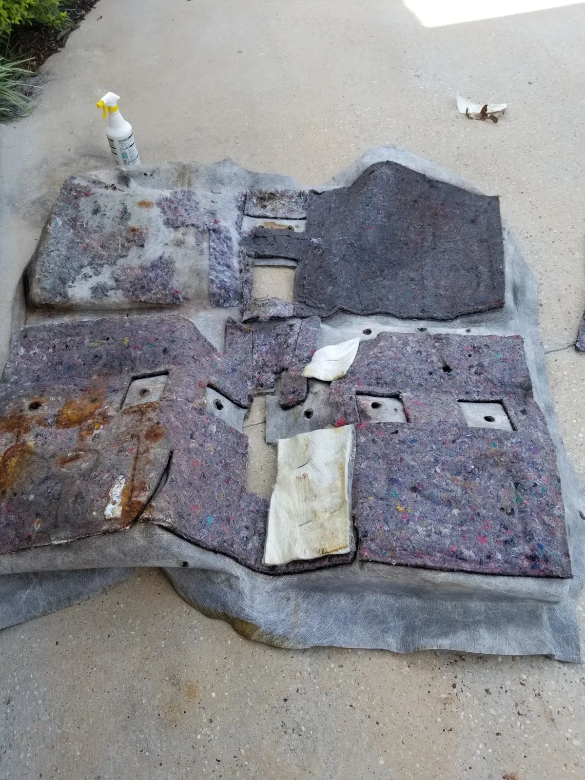

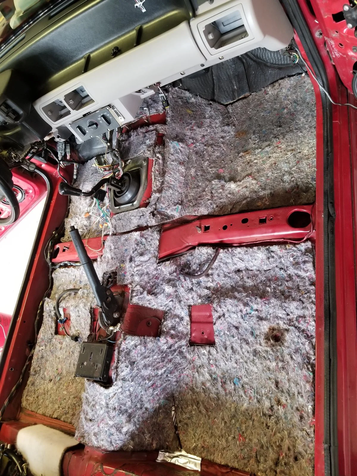

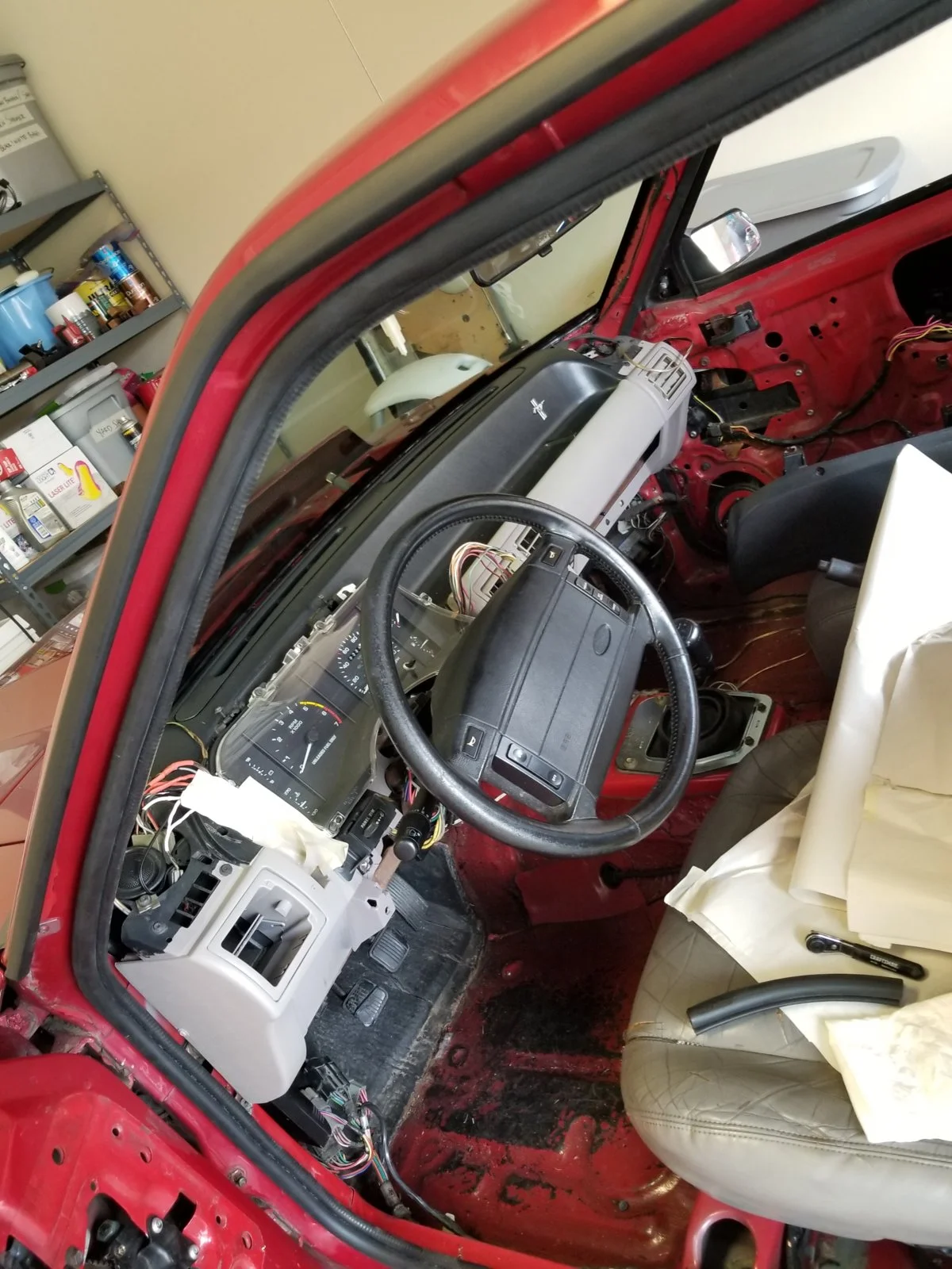

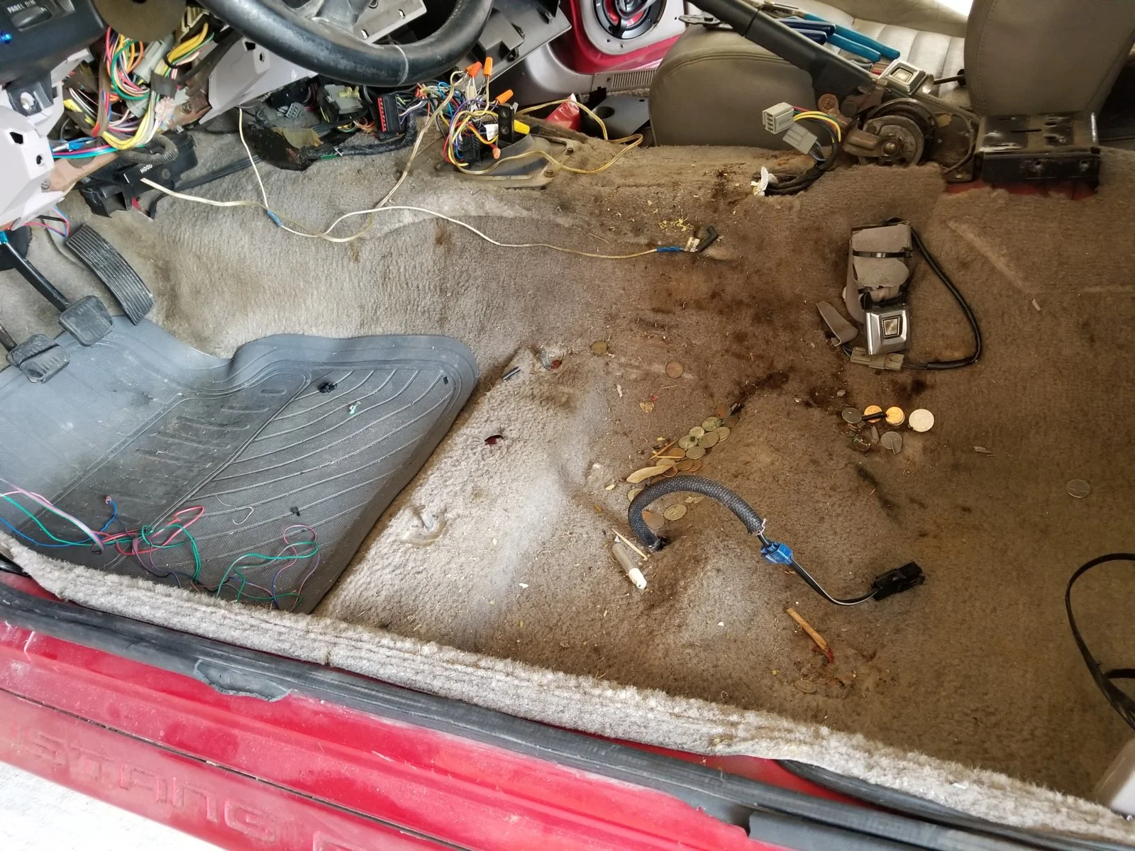

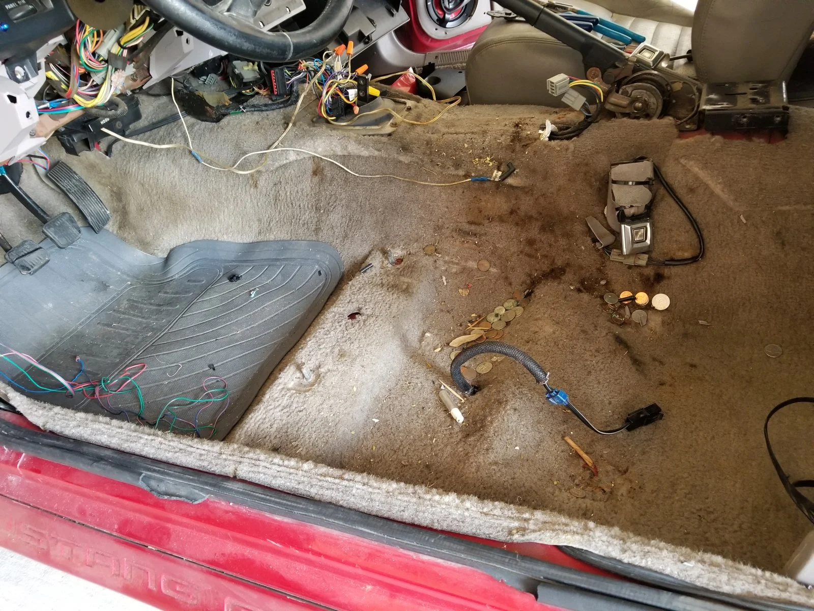

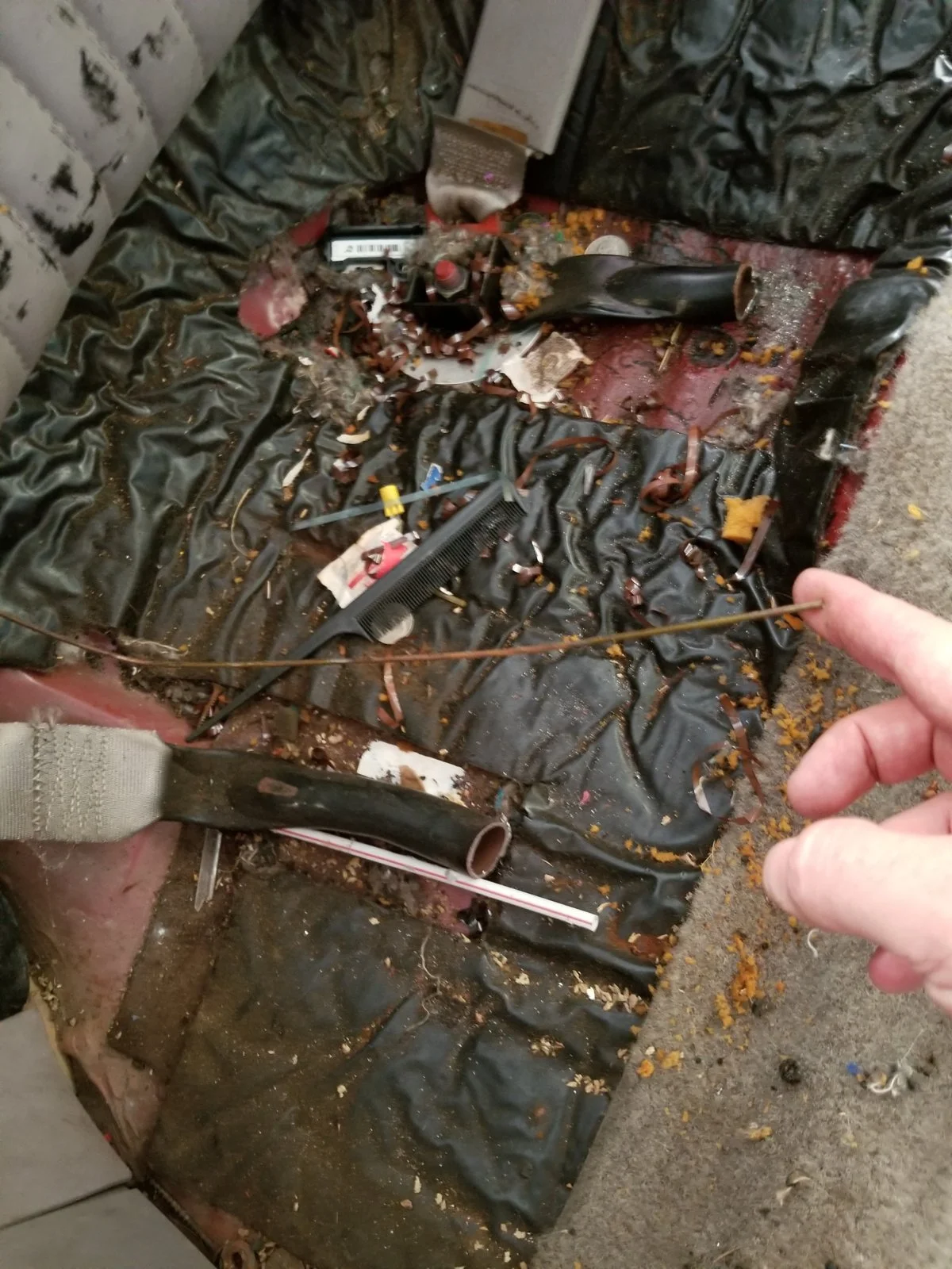

Once I got the car running the first time. I started working on the interior of the car. I went ahead and pulled everything out of the car except for the dash. The door locks didn't work, so I replaced the door actuators and the truck release actuator. This kinda got everything working. Someone at some point had the great idea to shave the door locks off and the truck lock off... A really crappy aftermarket alarm had been installed that worked as a key-less entry. All the relays had gone bad. After a lot of wire chasing I got it back to stock configuration and the doors and trunk lock as normal. Dont lock the doors and get out though. You cant get back in. I've got to reinstall a key-less entry at some point down the road.
The inside of the car was just gross. I ended up washing and de-greasing everything. It makes it easy when everything is out of the car and you dont have to worry about getting something wet. I ordered all new door gaskets and seal, truck seals, sunroof seals, carpet, armrest pads, center console pad, trunk carpet, rear seat carpet, door handle cups, window belting, and tons of other little things here and there. I also had a new headliner made.
All the plastic was washed, and degreased. I pulled everything out of the car. The black stuff was painted back SEM trim black. Everything else was painted SEM Ladera (kinda gray). The car was titanium, but it looked terrible and I just liked this color.
I washed the factory carpet pad multiple times as it was much thicker than the one on the back of the replacement carpet. When I installed the new carpet I put the old pad down first. Then slowly reinstalled all the plastic bits and the rest of the interior. I'll post some pics later.
Ok thank you. Yeah that’s over half the cost of buying a new set of 24lb ones. I’m sure it would be worth it if you buy a spendier used set though.
