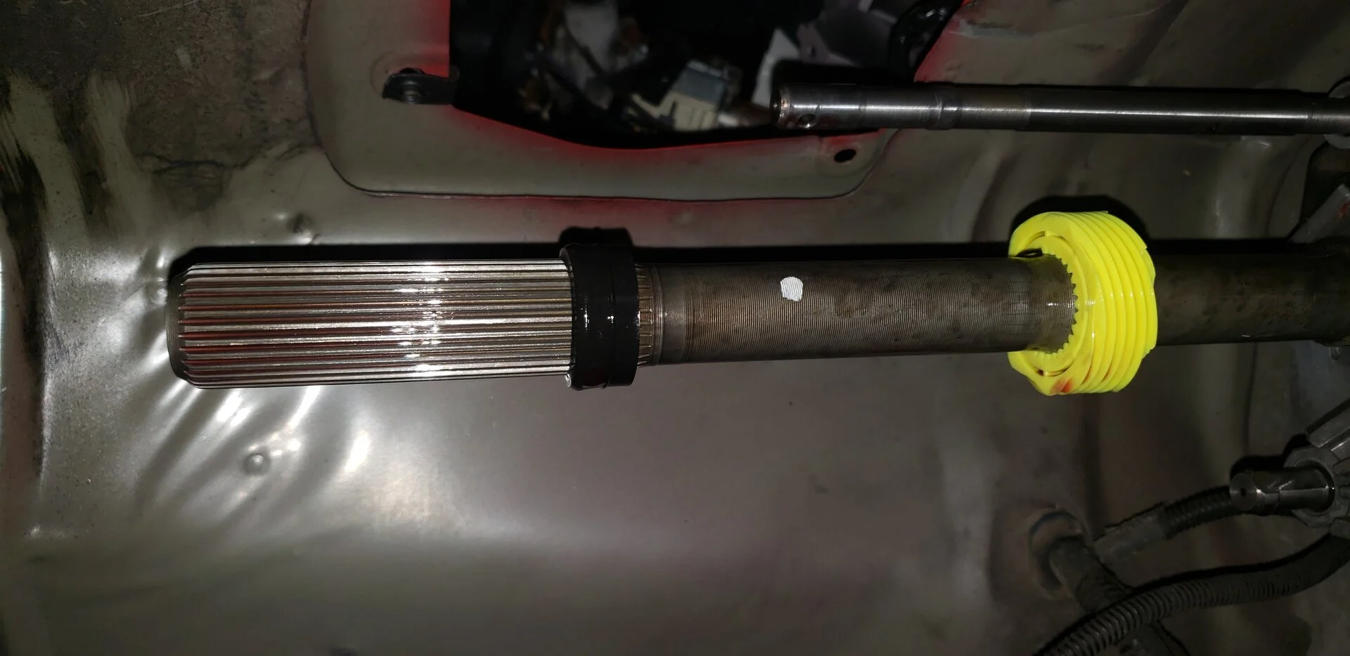

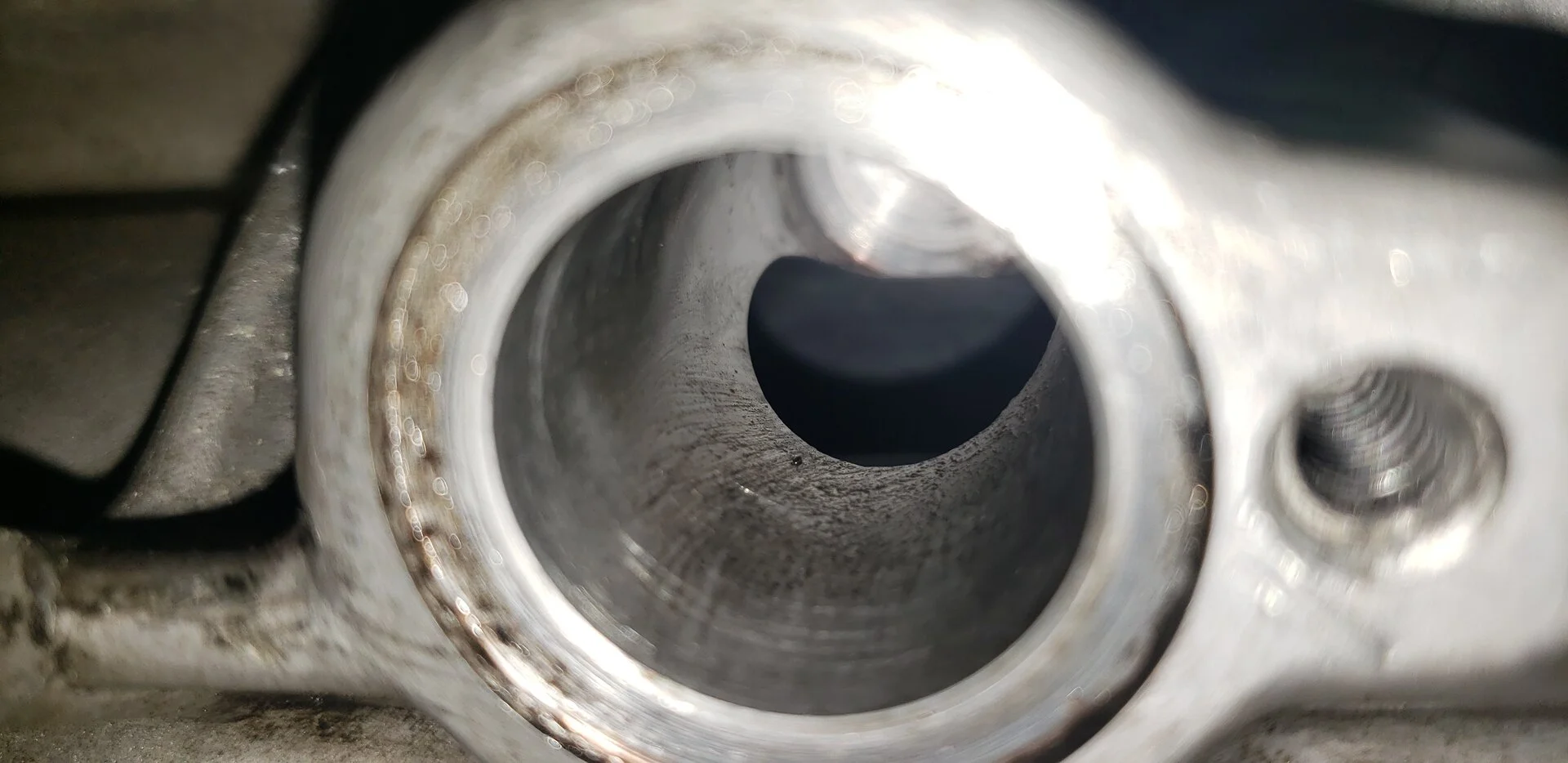

The new retainer for the drive gear came today. I got it installed. There is a black rubber donut thing on the output shaft. What does it do and how is it supposed to be installed?

I found no reference to the 'donut thing' on the output shaft, I looked all through the pages in the resources where it show the disassembly of the t5, maybe another member can help.
Reactions: Olivethefet

That donut thing acts almost like a seal. Should be on the splines near the bushing. I always slide them towards the rear and let it slide back when installing the tail housing. Not sure if there is a spot for it inside the tail housing. I can't remember.

Was the output shaft replaced? On my TKO,it had that on the output to prevent any residual oil from leaking, You could remove it OR push it inside the trans with no worries.

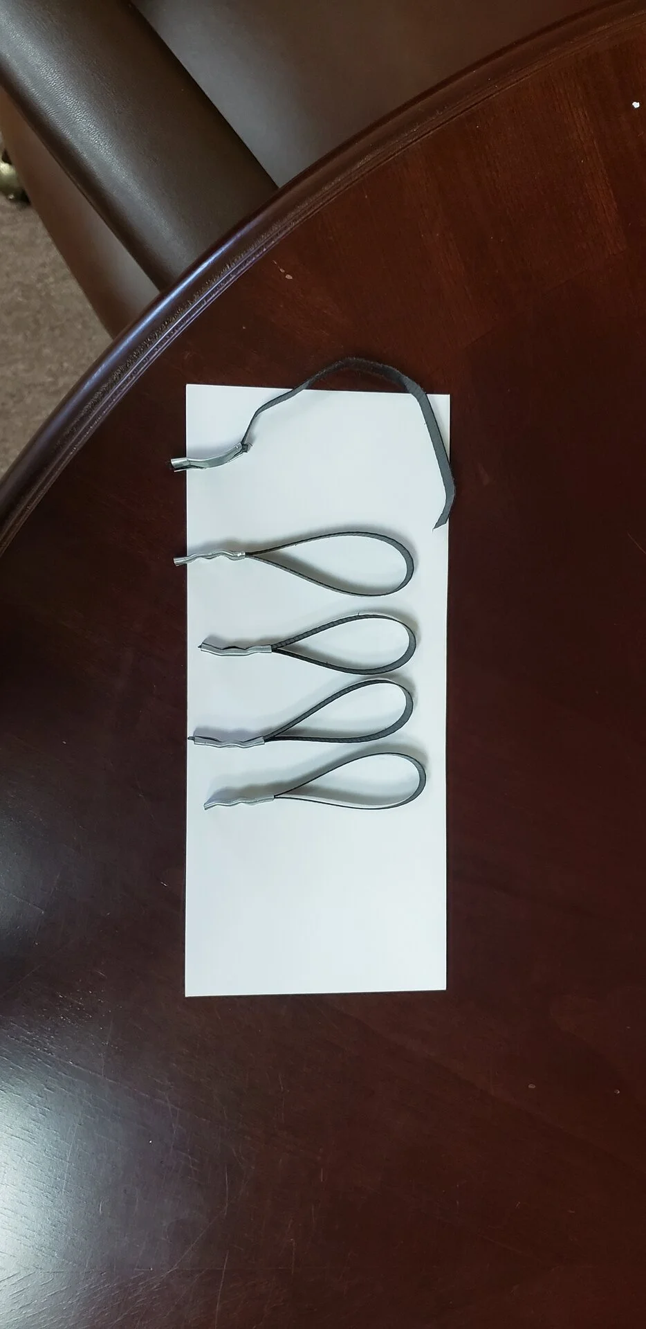

It's going back together! I got the tailshaft housing back on tonight. The little straps I make make this process pretty easy to do by yourself. Hit me up if you ever need one. The speedometer gear is in the proper place with a new retainer. I need some more automatic transmission fluid to top of the transmission, but that's it.

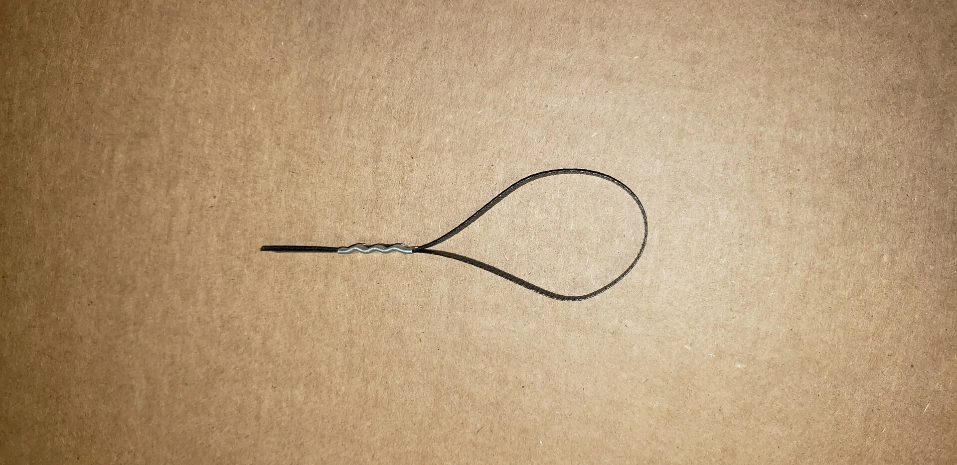

So as everyone knows the issue with doing this by yourself is trying to get the shifter shuttle back onto the transmission shifter rod while simultaneously getting the tail housing onto the transmission. The work around that I came up with was to fashion a flexible loop to hold the spring and detent ball in the shifter during installation. The material that I use is plastic banding. The stuff that you see boxes bound in to keep lids and stuff from opening during shipping. I secure it using a metal clamp that is put on using a specialty clamping tool. All this stuff is available to me through work. We have to ship boxes of material and use this stuff. The band doesn't have to be made out of this though. The goal is to hold the spring and ball in the shuttle while you do the install. It has to be wide enough to cover the ball and hole and strong enough to not rip under pressure. If that ball gets loose under pressure it will shoot out like a cannon ball never to be seen again. Here is a picture of the strap and tools I use to fashions these things.

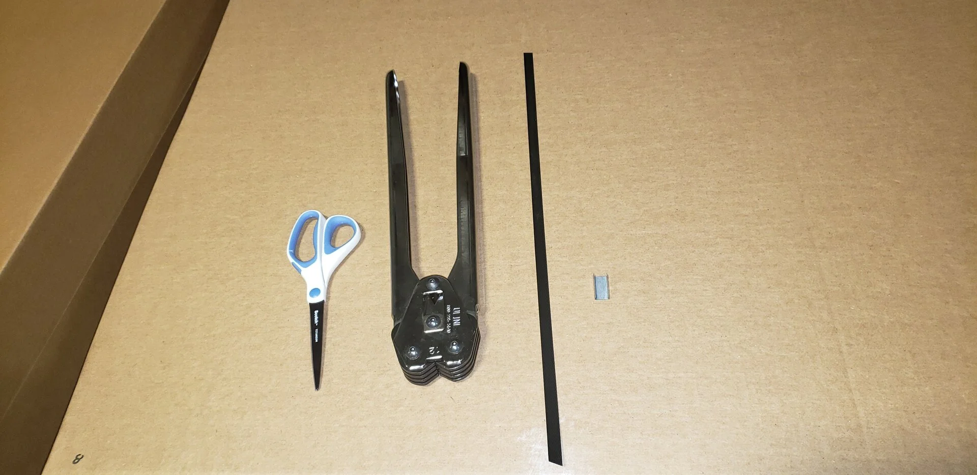

This is an area I would have taken more pictures.

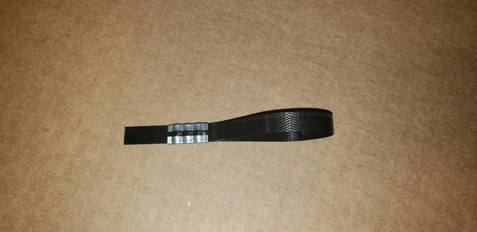

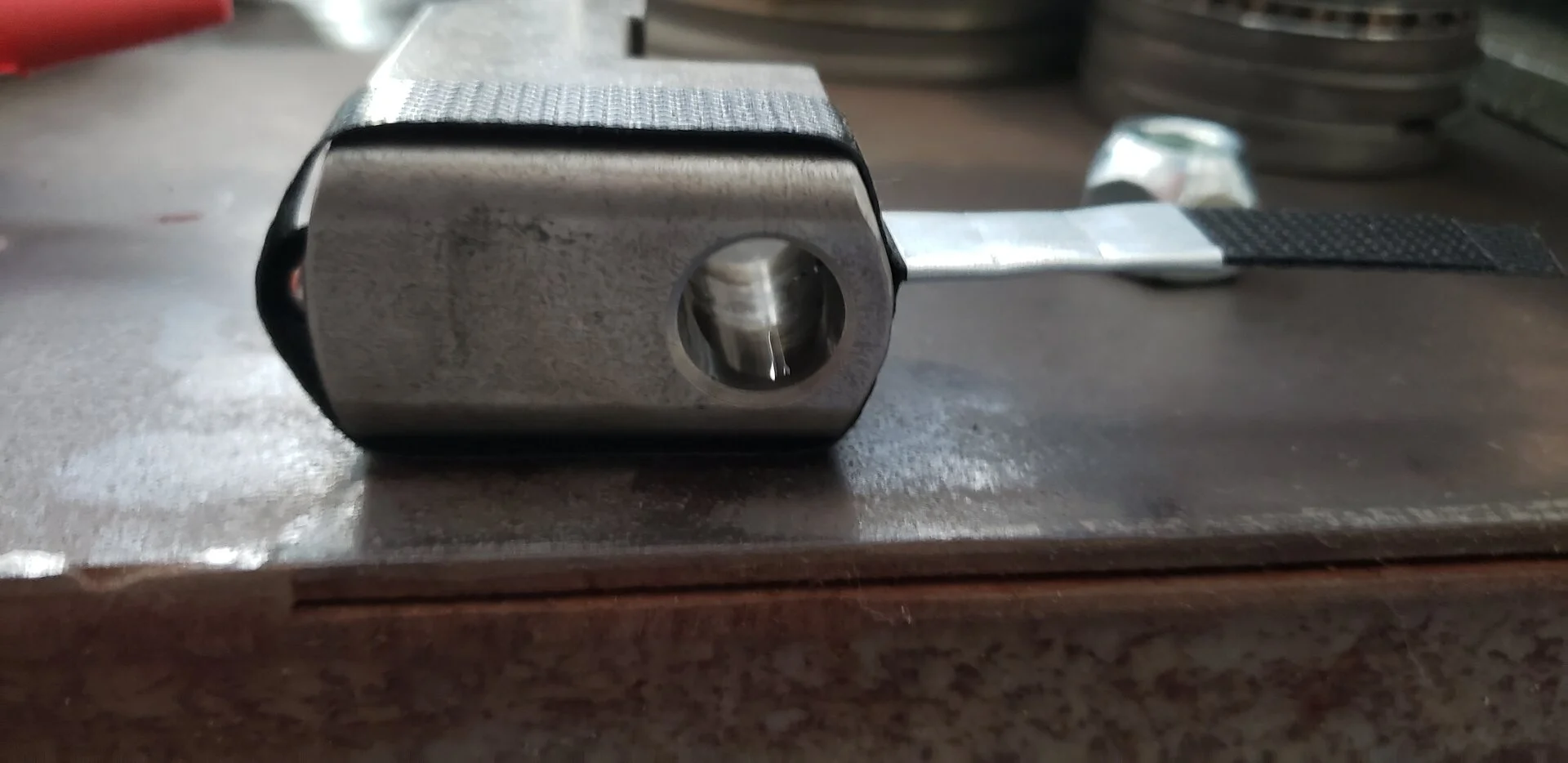

With the spring and ball out of the shuttle I wrap the strap around the shuttle tightly and then slid it off the shuttle. Holding it in place I use the metal clamp and clamping tool to clamp it in place. Then trim the excess.
This is the widget that I will make for you if you need one. I have to guess at the size though, so if you get one from me you will most likely get 4 or more of varying sizes. You get to pick the one that works. If none work I'll make more!
The goal is to make it as tight as possible so that the detent ball isn't pushing against the floor of the tail housing as you are trying to put everything together.

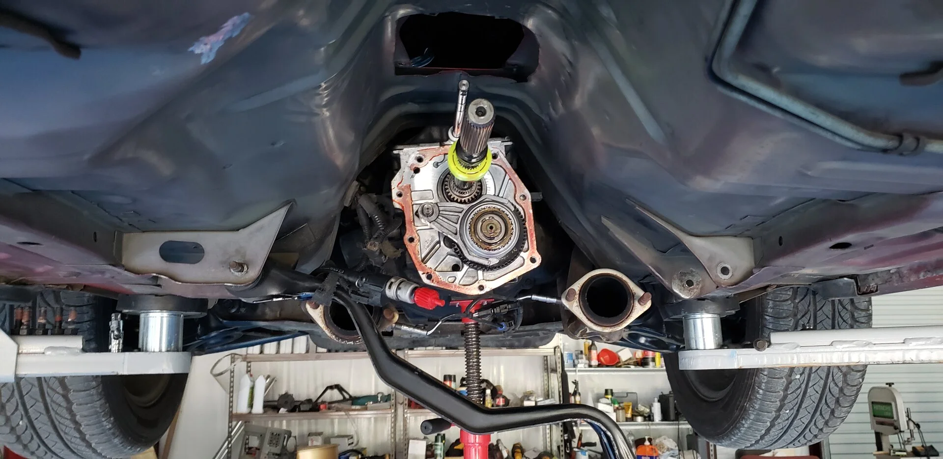

With the tail housing removed this is what your transmission is going to look like. You don't have to completely remove the transmission cross member if you don't want to.

Using the strap that I made I get it, the shuttle, spring, and detent ball and find a hard surface. I use a metal table that I have in my shop, but a counter top would also work. Now put the spring in the shuttle and put the detent ball close to the edge of the table. Push the shuttle down over the ball capturing it in the shuttle. It is now under pressure and if you rotate the shuttle it will shoot off never to be seen again. While holding the shuttle down over the ball get the strap and work it under and around the shuttle. Once the strap is centered over the ball you can slowly let up the pressure and let the strap catch the spring and ball. Again, this thing is like a loaded gun. Be careful not to knock the strap off the ball.
Put that thing down in a safe place and grab the tail housing. Get under the car and slid the housing over the output shaft to the point where the shifter rod is just sticking into the pocket were the shuttle will go. The shifter rod only needs to be in the pocket about a 1/4". Get out from under the car and go get the shuttle.
Place the shuttle in the pocket. You should be able to get the shuttle to start sliding onto the shifter rod. Depending on how tight the band is holding the detent you might have to press down on the shuttle to get the detent to compress enough to allow the shuttle to start sliding onto the shifter rod.
With the shuttle started get back under the car. Reaching up with one hand get a hold of the shuttle. Now push the housing forward with the other hand. This is the tricky part. I have to get under and push and get back in the car and pull on the housing while working the shuttle onto the shifter rod. Be patient and dont try to force anything. It will work it's way all the way on eventually. You might have to push down on the shuttle to compress the detent again.
Once the housing is fully seated against the transmission chances are the shifter rod will not be in the exact position to allow you to install the roll pin. It should be close enough that you can use a punch or small screw driver to line things up. After you get the hole in the shifter rod lined up with the hold in the shuttle you can install the roll pin.
Using a hammer tap the roll pin into the shuttle to get it started then use a punch to drive it down until the top of the pin is flush with the top of the shuttle. If you drive this pin down too far it will not allow the shuttle to move and you will have to pull the housing back off to correct the issue. Dont do that.
Once the shuttle is in place you will have to cut the band holding the detent loose. You can not slide it off as the part of the shuttle that rides in the shift gates block it from coming off the end of the shuttle. You will need to use a knife or razor to cut the band then just pull it out. At this point the detent is trapped and can not come out, so you dont have to worry about being careful.

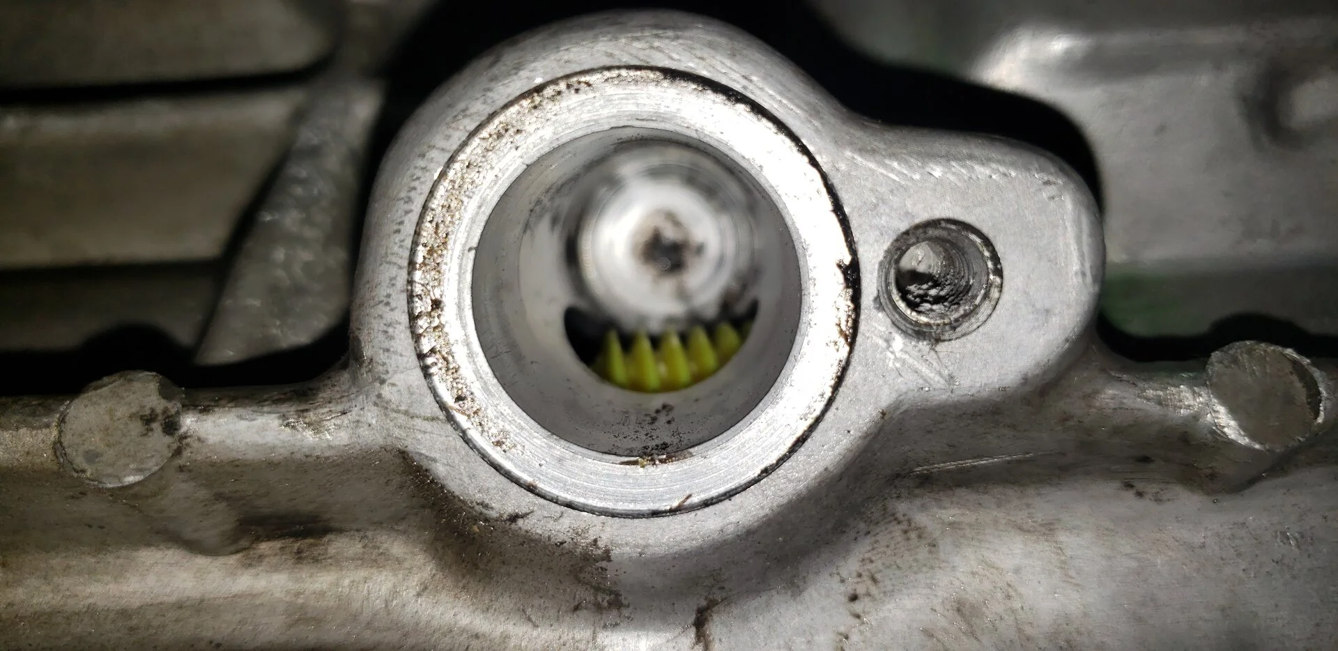

Well I confirmed it. The speedometer drive gear has walked off again. Not sure why, but if I want to know how fast I'm going I will have to pull the housing again and see if I can fix the issue.
