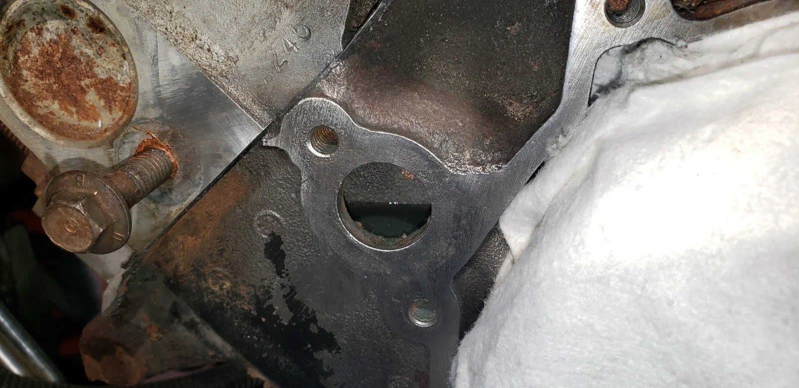

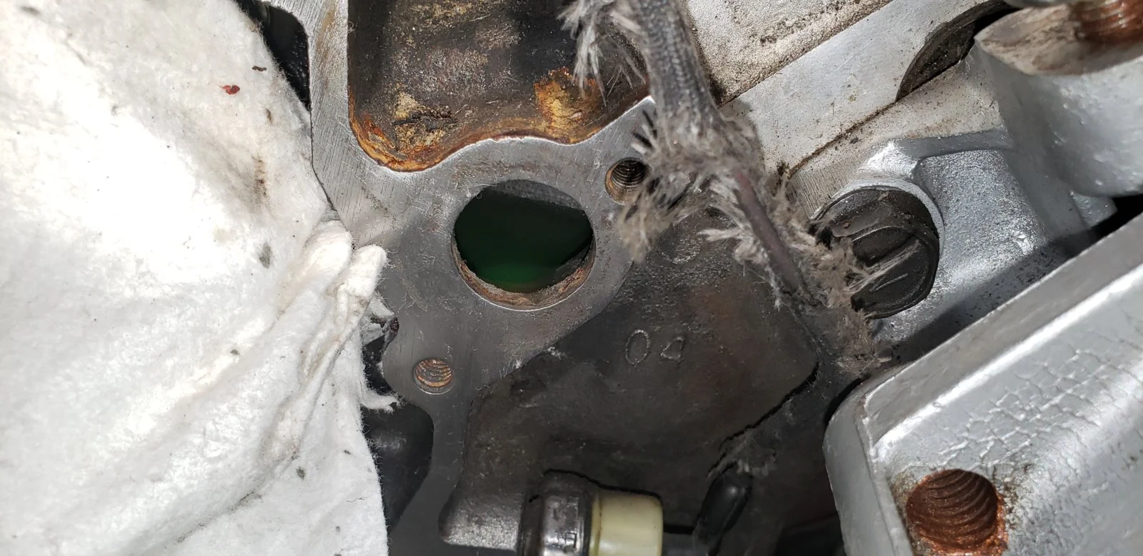

I haven't given up on the car! With everything going on in the world I haven't had the time to mess with it much. I've been spending a little time here and there trying to get the matting surface on the engine where the timing chain cover goes as spotlessly clean as possible. I dont have a pic handy, but there is some stuff that is stuck to it that absolutely will not come off. I can tell if its just discoloration of the metal or very thin old gasket material. My plan is to get some fine grit, 600+, sandpaper and attach it to a piece of wood. I'll use that to lightly sand the surface until it is bright metal. I'm using the wood to keep the pressure even and avoid creating dips. Is this a bad idea? I've used a scotch bright pad and wire wheel with little success. There are towels stuck in the oil pan and around the timing chain to keep everything as clean as possible.
