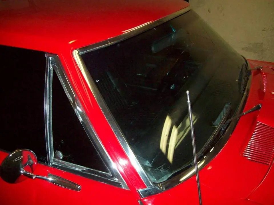

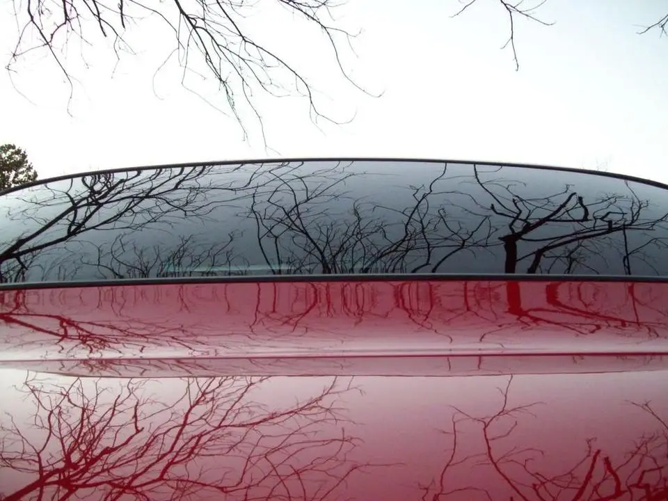

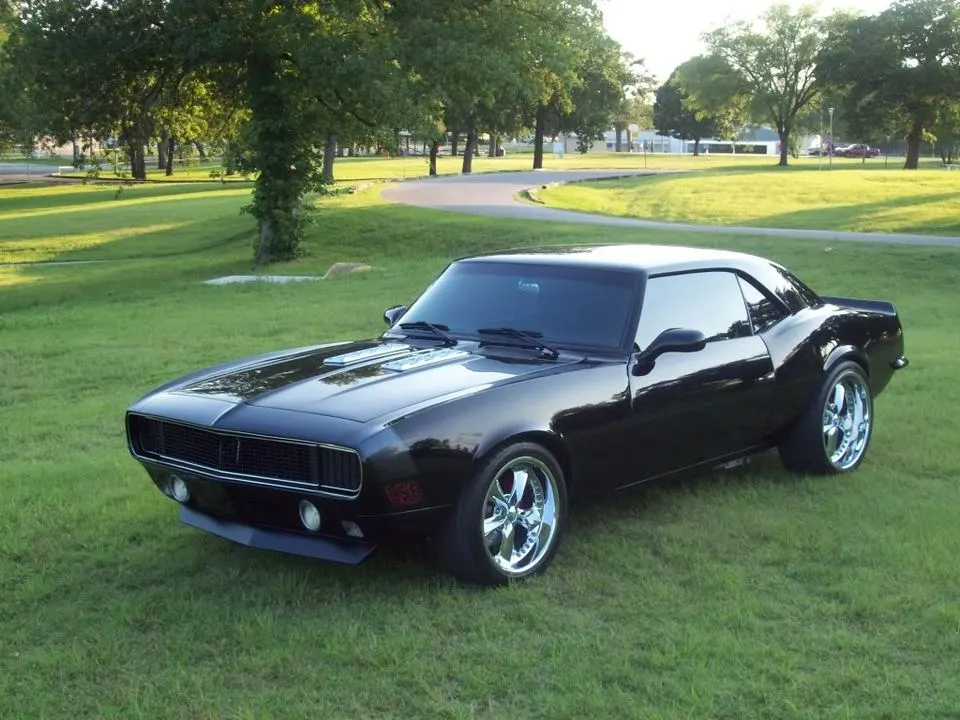

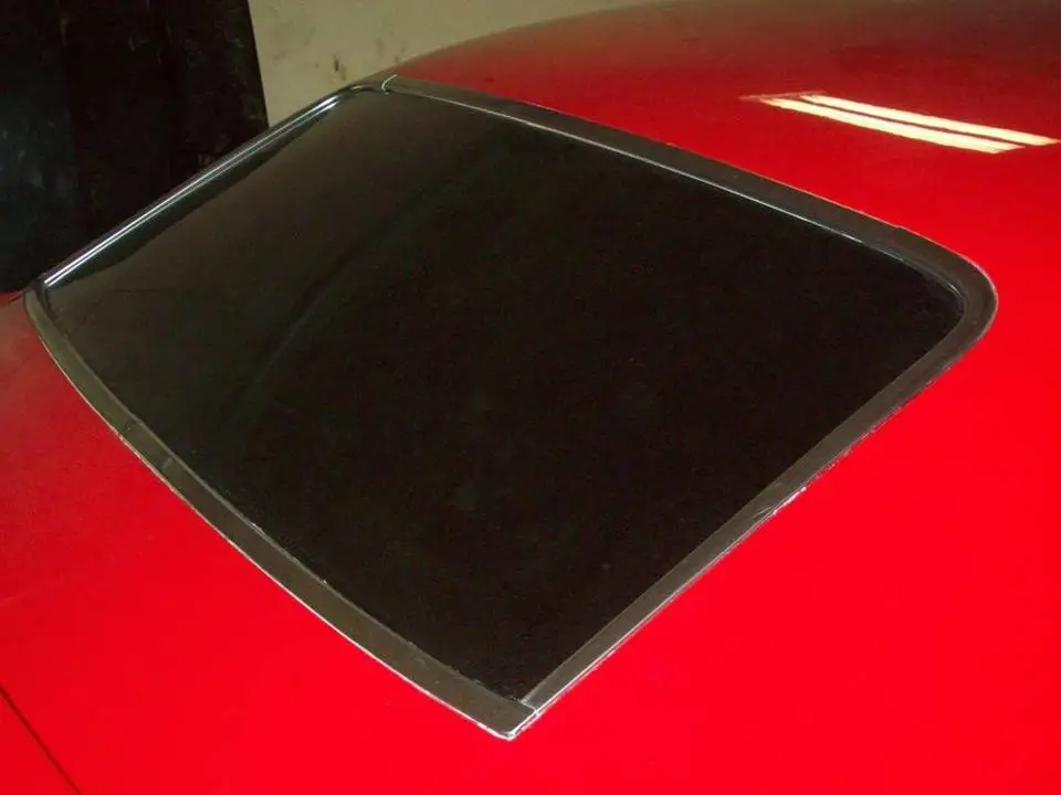

not looking to make a "rat rod" unfinished car, just smoothing some things out on the car, and limiting the chrome. Anyways I put the glass in just to have a look, not happy with the front, but the back looks pretty good. The car is far from perfect, it was a learning project for me (and still is).
mtaqua
Oct 7, 2006
345
Dec 31, 2010
  • Dec 31, 2010
more pics
http://www.hfrfab.com/RickLane.html this was the car I got the idea from (the link); I emailed the guy to ask what he did.

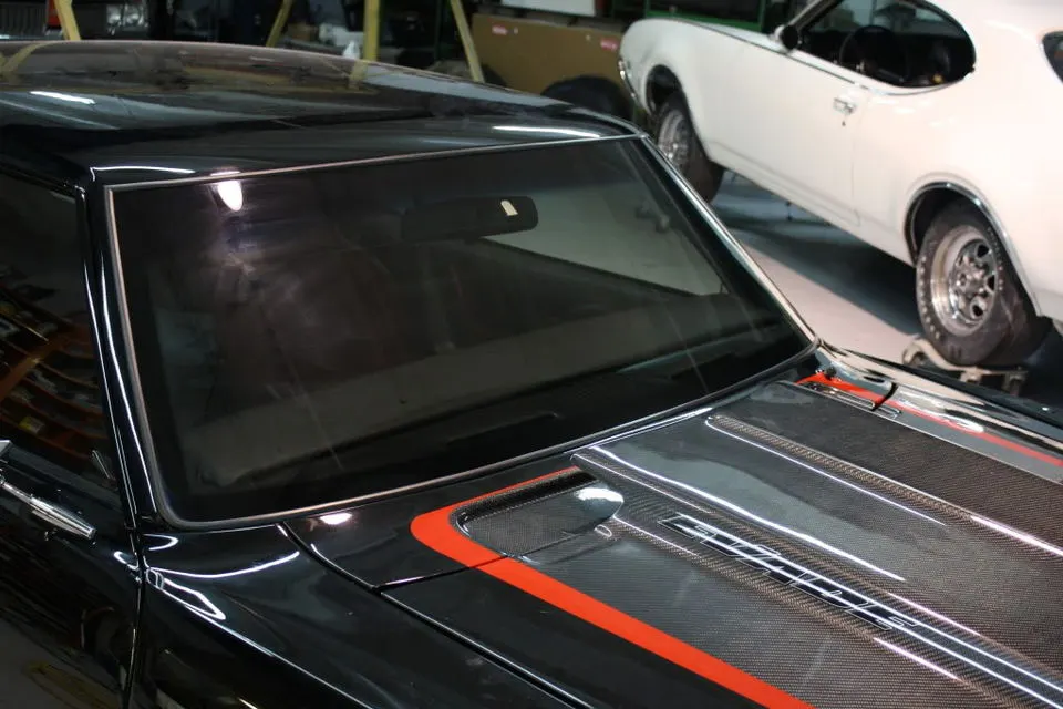

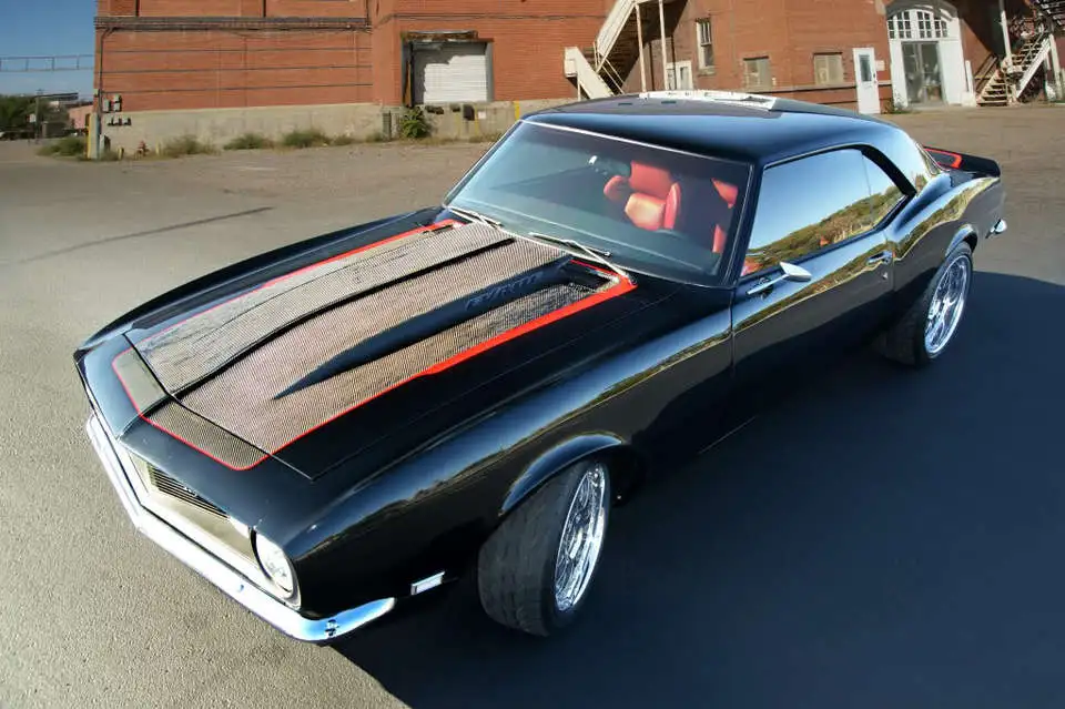

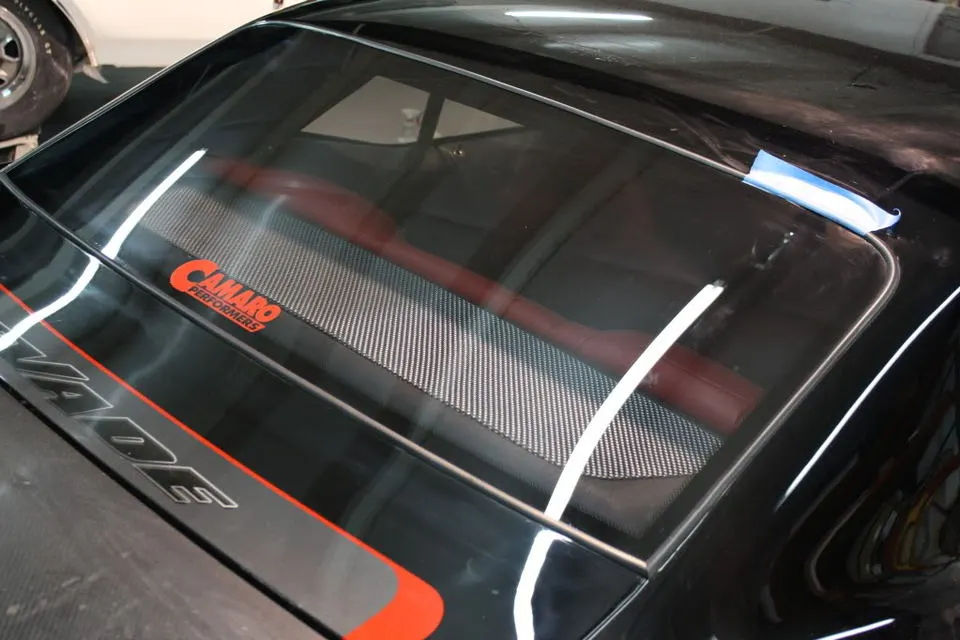

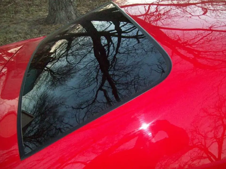

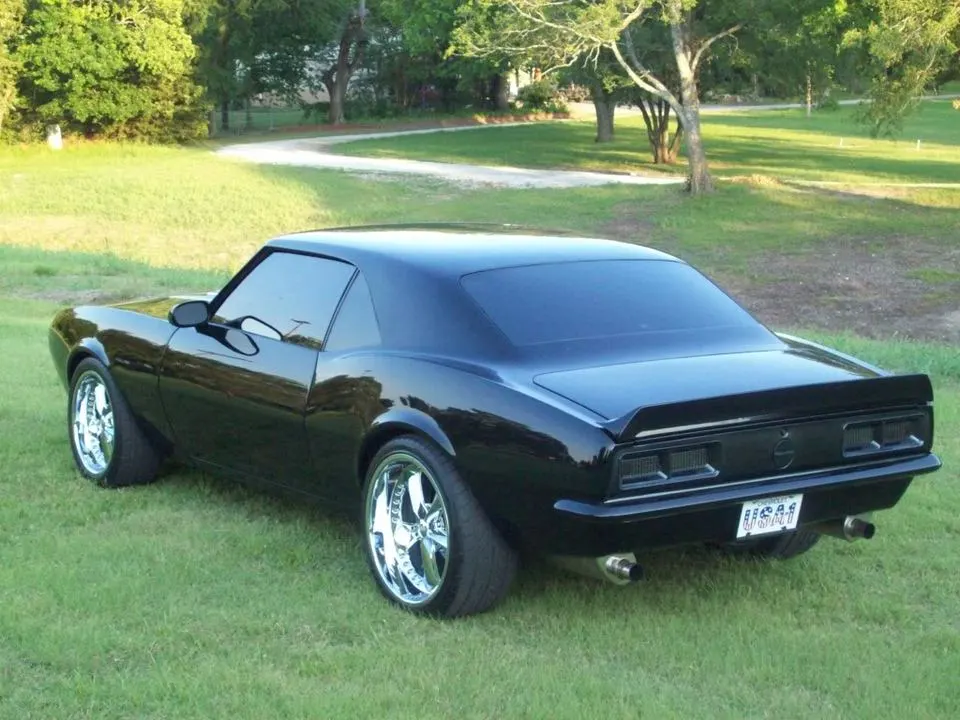

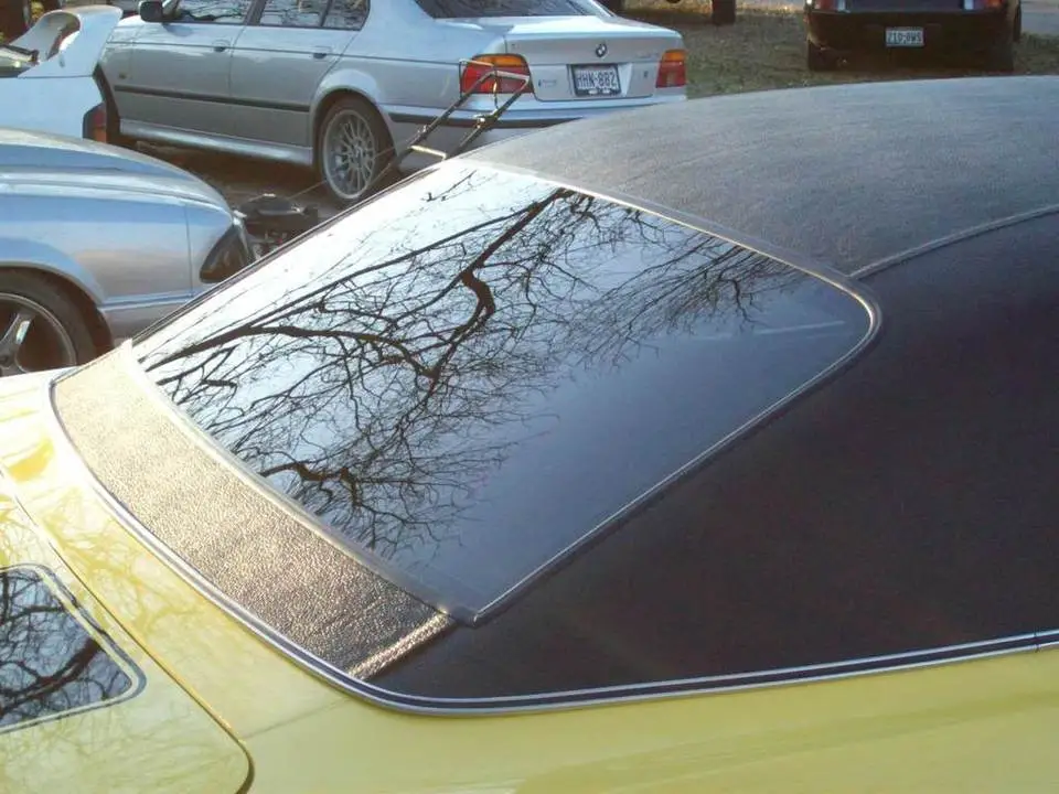

We actually have a Flush Mount Glass kit coming out for the 64-70 Mustang fastbacks and coupes.. Hopefully they will be coming out in the late spring and we are currently taking names for a waiting list.. Below are some pictures of our 1st gen Camaro kits, the Mustang kits will have similar style..
With these kits, there are NO Body Mods, so they will fit in completed cars and are completely reversible at anytime. Please feel free to contact me off of my website at anytime for questions.. We have some very notable builds that we are sponsoring, so there will be plenty of coverage coming up..
The weatherstrip is completely optional on the rear glass, these glass kits put the actual windshield and rear glass at sheetmetal height.. The rear glass comes in smoked options along with clear, and also comes with a nice rounded edge that allows it to be installed with out weatherstrip. The windshields come with an intergrated antenna built in the tint band, so it is complete hidden from sight, and will allow the elimination of the fender mast antenna... We will also have a Quarter Glass option for the fastbacks, that will work perfectly with out rear glasses...

Our current kits Retail 1999 dollars plus shipping through Classic Industries and other retailers, but we offer promotional pricing at 1500 dollars plus shipping for the complete set. I figure The Mustang will be the same price, and I am taking names for a contact list on my website email if you want to qualify for the promotional pricing.
Some may say this is high, but sales hasnt been a problem.. All you have to consider is the amount of body modding that would have to be done to get the same look. The amount of welding and finish work, isnt cheap at all, and your car will cost even more to reverse if you ever decided too.. Also, when people weld up the window channels, there tends to be cracking at the flex points of the body at the corners of the window opening.
Our kits come complete with New redesigned glass (winshield, rear glass, and quarter windows), the necessary Urethane, primers, and cleaning agent, weatherstrip. These kits install in a matter of a couple of hours, and is completely reversible in the same time frame.
Again, NO BODY Mods. Unlike other cars that you may have seen that narrow the window openings or add large and bulky weatherstrip, we Relplace your current weather strip and trim with Actual Glass... This gives you a look that could have been factory, so it gives that subtle but very noticable mod.
With the Rear Glass, the weatherstrip is Optional.. The red Camaro Below, was painted already and had to have the weatherstrip to cover the window channel edges to hide the chip and rub throughs that the stainless steel trim left behind. The black car above, had the glass installed after paint, so it wasnt necessary to cover anything and did not need the weatherstrip. THE REAR GLASS KIT WORKS GREAT WITH VINYL TOP CARS ALSO...
