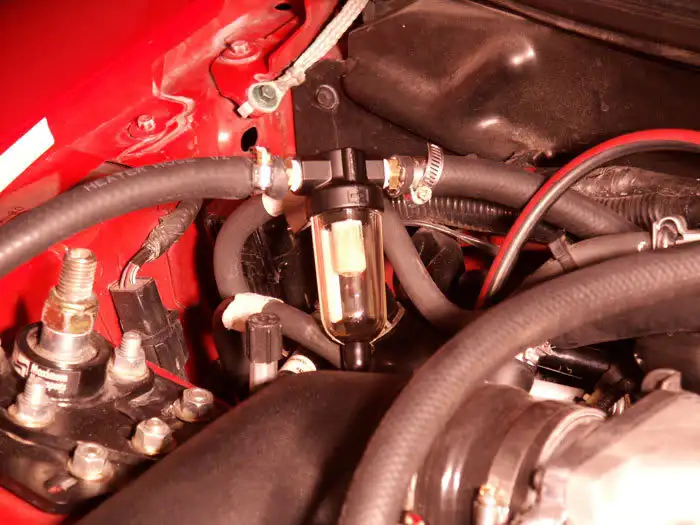

You can make your own oil separator from air compressor parts at a home improvement store. I have one for my blower. It cost me less than $20 to make. I get slight blow by...
Hmmmm... maybe it's time to replace the filter....
Btw, in this photo, the hose on the left from pcv to intake is a heater hose... NOOOOO... I need to update the photo with the current one on there that doesn't sweat.

Would I put it in line with the pcv valve, or the breather thats actually sucking up the oil?
