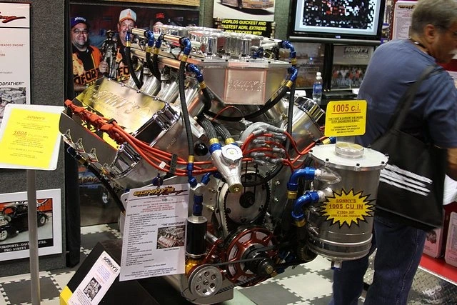

Here you go drop a mountain motor in your car I'm sure you will be king of the streets with it lololol
