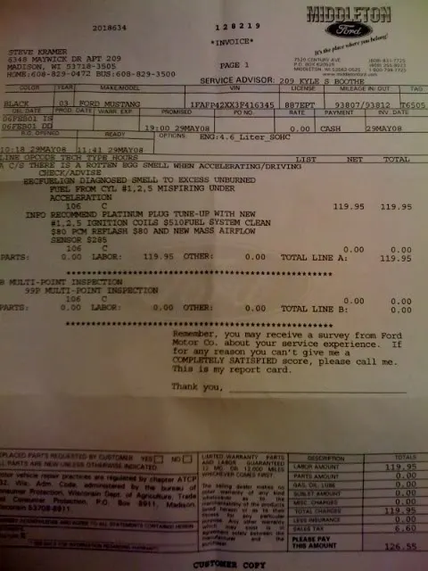

Its been a while!.. well anyway I was wondering if I could get some insight or thoughts to some problems that have arrising after taking my stang to the shop today.
So to being I have been smelling a rotten egg smell under accel. So i took it into the shop to have it diagnosed and after a 130 bucks here is the outcome.
Cylinders 1,2,5 are showing 25% misfire, the car does have NGK iridium plugs in that were added a year ago, probably going to go back to motorcraft double platinum
Needs new coil packs. How about the MSD?? or any others??
Computer retune
New MAF sensor as it was reading out of range.. Recomendations?? Fords is 300.00 bucks.. i figured there would be a better aftermarket one.
Complete tune up
Fuel system cleanse as they say
And the grand total would be 1100.00 to have all this work done, now my question is would it make sense to buy the parts and have them put it on?? as far as retuning the ECM would it make more sense to just order a SCT device and do it myself??
More or less just wondering how some of you would handle this situation as its not what you would say in the budget, so im trying to do it as cheap as possible but get quality parts.

Diag sounds funny. Did u take it to the dealer? Sounds like someones trying to throw parts at your car because they dont know whats really wrong. Plugs AND coils? MAF and "retune" ? I would take a closer look at the MAF sensor, see if it really is out of range. No way does your car need all that. If the maf doesn't check out ok, try cleaning it. If it does check out ok the next thing i would check is the plugs. Does this shop have an ignition scope? Who installed the plugs and if they are the type that need to be gapped (unlike plat.) then were they gapped properly?
Im a ford tech and heres what i would do. First thing i probably would check is the MAF. bad maf reading = improper mixture = possible misfires. I would look at the other cylinders or run a cylinder power balance test. if they all are pretty even with cylinder P/B and misfire count, i would probably replace the MAF. Look at it this way, bad plugs wont cause a MAF out of range. Make the shop diag the ROOT CAUSE and not just toss parts at your car on your dime. Chances are if the MAF's too far out you'll be replacing those plugs anyway. Only go with motorcraft, as if ford heads dont already have a bad enough time holding spark plugs in aftermarket plugs only magnify the problem.
I can also get the work shop manual diagnostic pinpoint test if u have any DTC's, which u should. year/model/engine/DTC

what the hell is a 25% misfire
test the resistance of the coils and slap some new plugs in that bich. If you don't have an ohm meter, wait till night time and spray some water over the coils and look for sparks.
Then get some CRC MAF cleaner and call it a day
I'm not aware of any ford re flash of the ECM that fixes a misfire, or a 'rotten egg' smelling car. I don't know about ford, but at the VW dealer, Reflashes are free of charge, and are preformed without the customers consent.

Hey guys,
thanks for the input, i was a little confused on the whole diag as well. i have attached the actual paper work from today for you guys to check out.
But i will try cleaning the MAF and see what happens, the car does have a CAI on it which is why they were telling me it was out of range, They also explained the reflash as like a software upgrade for a computer.. Which being a network engineer i would like they could and should be done for free if that is how they work.
What did you mean by TDC??

a 25% misfire sounds hoaky to me.
3 coils bad on your car at 93,000 hmmm.
A bad maf would cause multiple misfires that would be random, not the same three cyls.
You would have PO301,302 & 305 codes stored.
I would say clean MAF, new fuel filter if it hasn't been changed recently and some new plugs.
Diagnosis is weak at best. Without being able to look at short term f/t and maf volt, 02 readings it's hard to say.
Do you even have a check engine light on?
