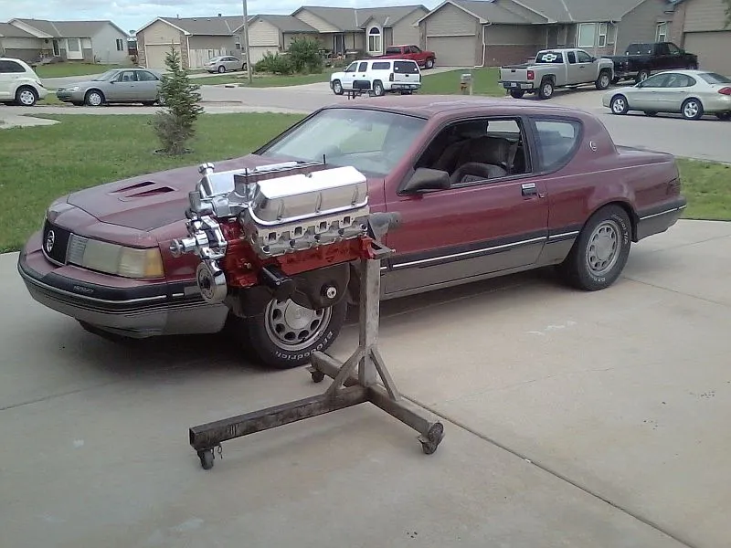

1st. The car I'm working on is an '87 Cougar XR-7. This car has been my Dad's since '96 and it has gone through many engine/tranny transplants each one becoming more aggressive. The car was given the HO 5.0 guts, wiring and mass air from a '89 GT about 9 years ago or so. Cams, heads, intakes, fuel pumps etc. have come and gone and the car has always ran really well. About two months ago we installed a 347 from Coast with Pro comp 2.02 heads, 10.88 CR, Comp XE282 Cam, Trick Flow intake, 75 TB etc.

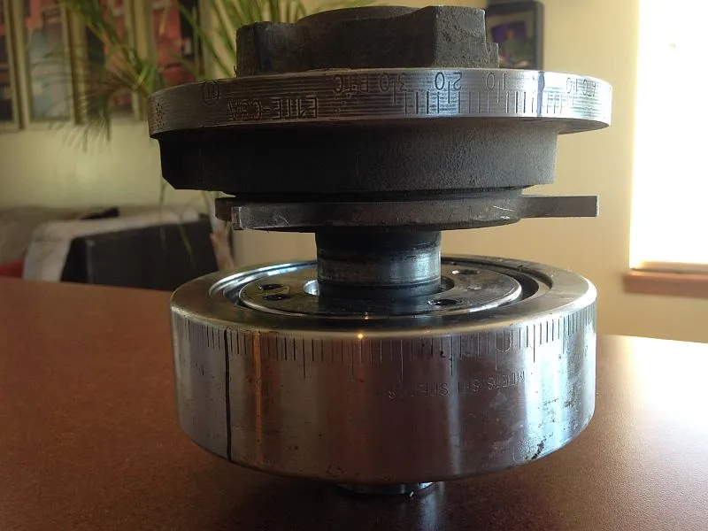

So the difference between "0" marks on the two balancers is seventy degrees. That means that by setting the timing at the "ahem" 14 degrees initial was actually setting it at 84 initial!! Pinging problems indeed!! The CORRECT balancer is on its way and THEN should be able to tune it......
