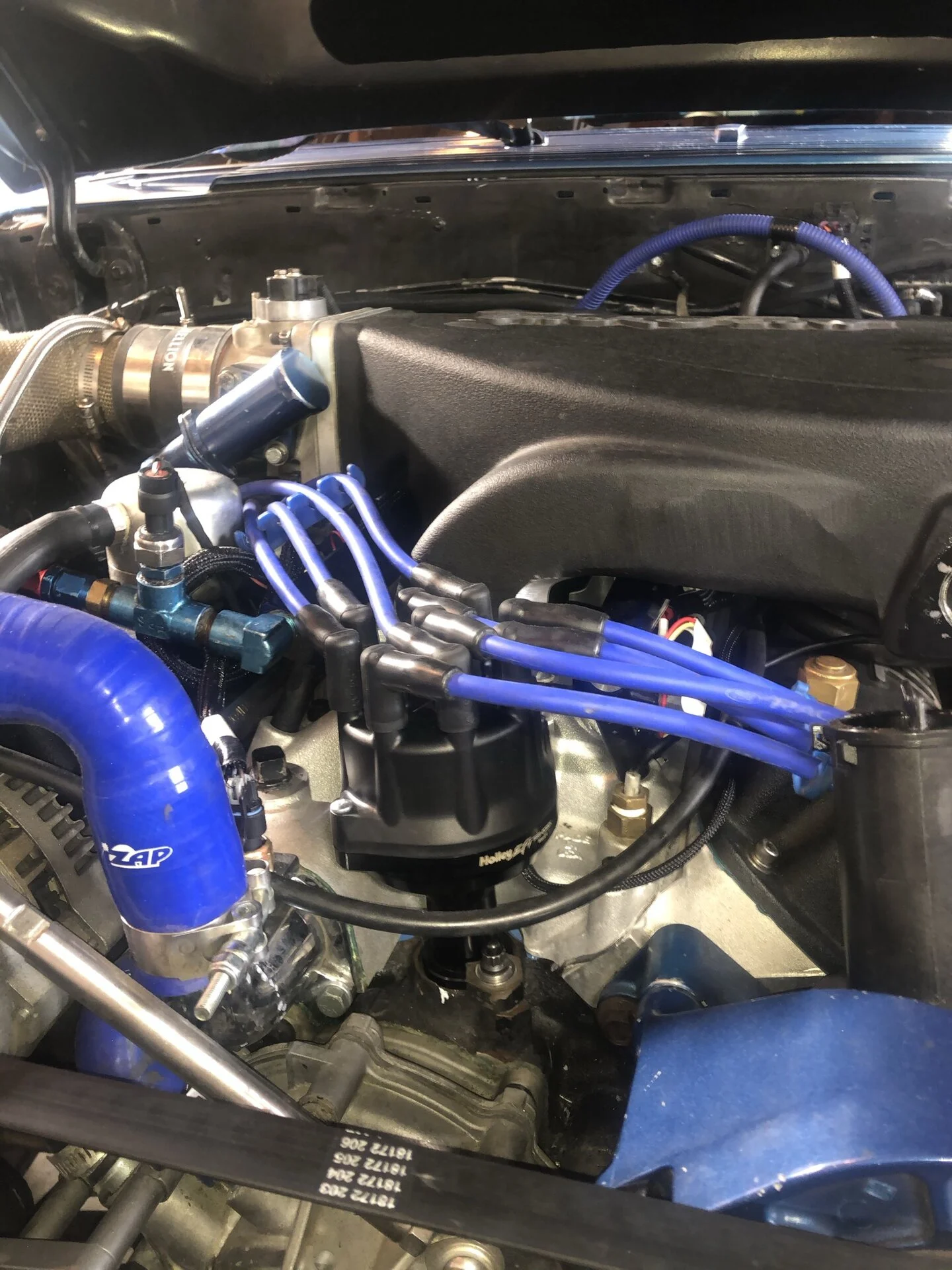

Yeah I got it installed along with a dual sync distributor a couple weeks ago, the car literally runs like butter its crazy how much the updated electronics are helping
