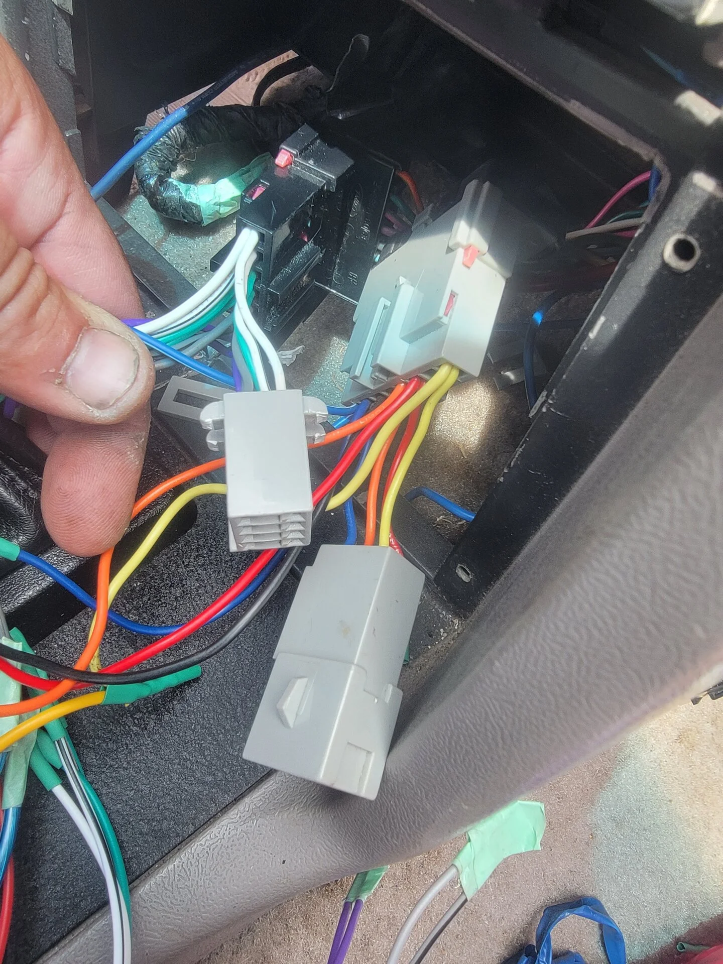

I got a aftermarket deck and the new plugs for the harness but I only get sound from the doors how do I get the others to work so if it been said how to already I just wanna put the deck and amp and subs in but I need more sound then door speakers

Did they work prior? Did you remove the amp?
Couple different ways to answer this but essentially it comes down to the body wiring. Doors and dash are wired in parallel on all 1990+. SO if oyu ditch the amp wiring and plug your new radio right into the body harness, all 6 speakers should work.
If oyu are missing some then perhaps you crossed a few wires accidentally?

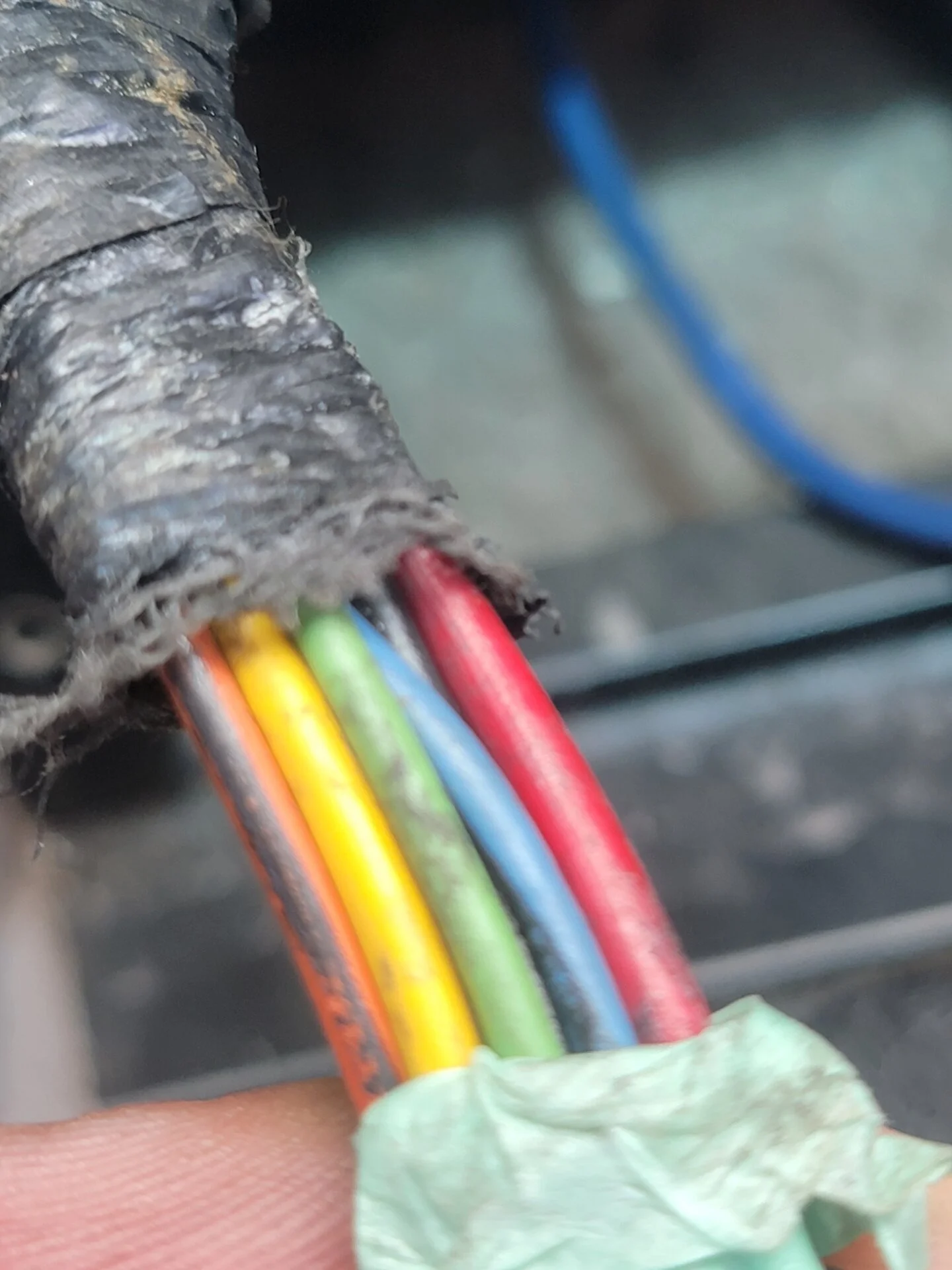

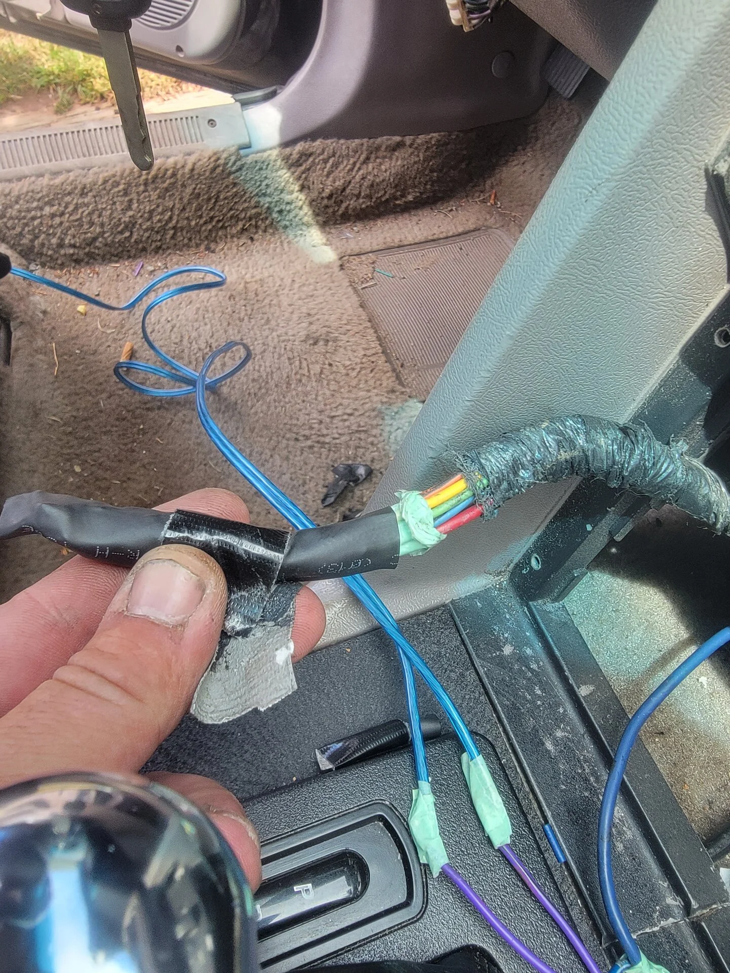

when I got the car it had no deck they had a aftermarket and this bunch of wires and it has 6 speakers all infinity kappa so speaker wire is under the dash and to the back speakers just got the back to work both are blown and I've only got the door speakers to work and what harness do I have

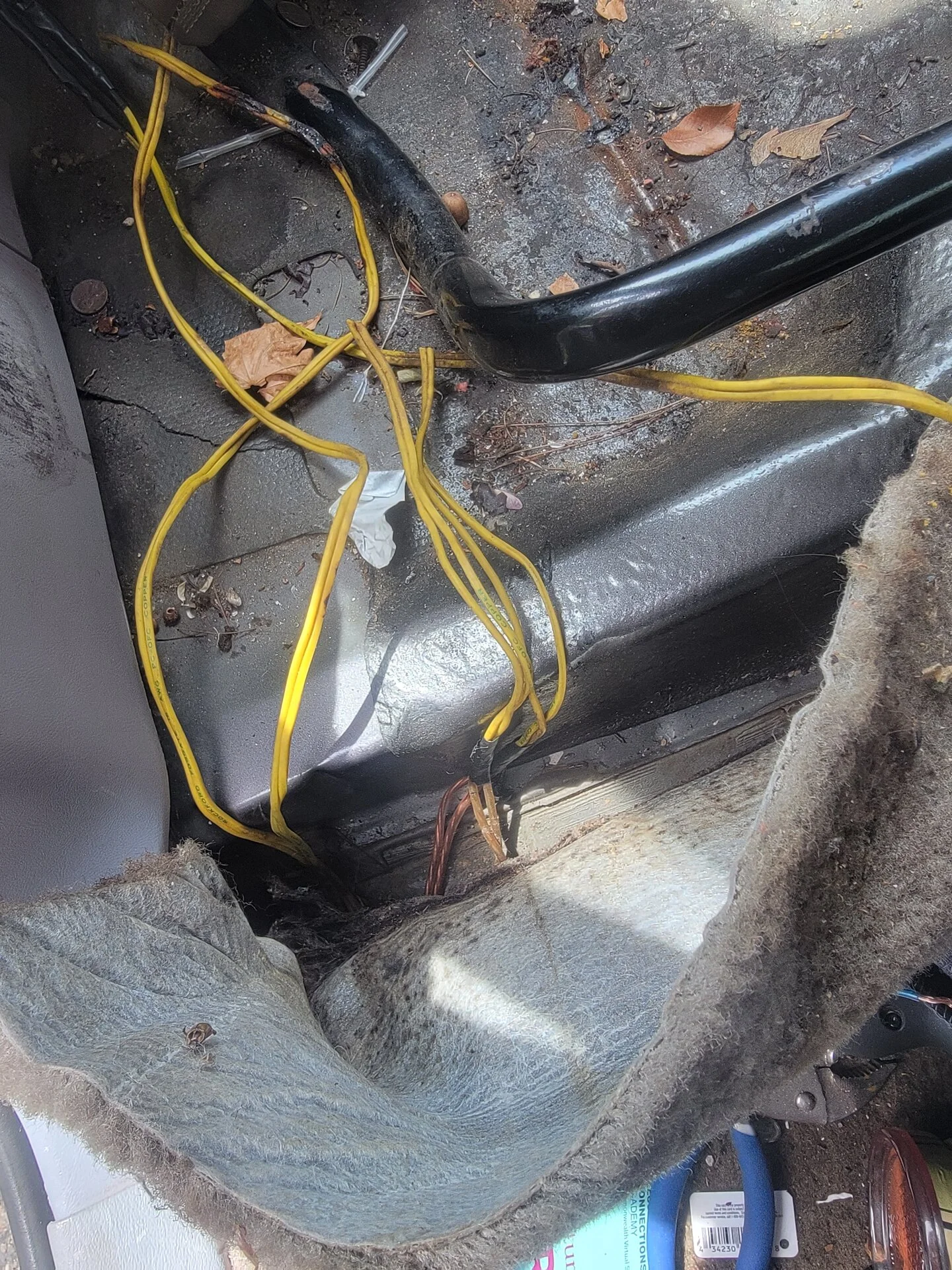

and it looks like he had a 4 channel amp running the speakers and I've never seen these box things on a rear 6x9 is it a blocker I'll have to reach it
