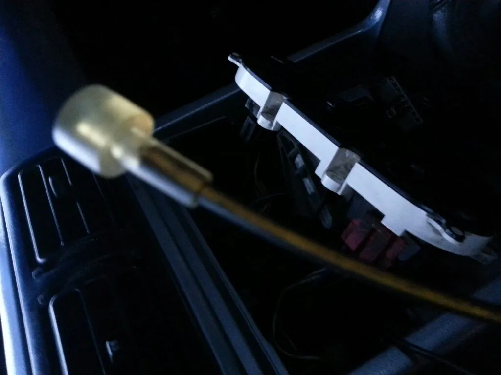

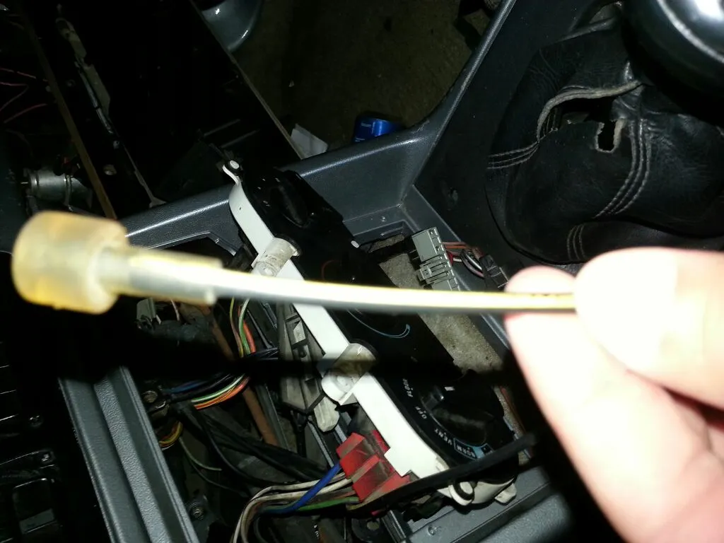

I just replaced my heater core on my 87 GT so I robed the dash and now I can't figure out where this line goes? Any help would be great I've searched and found many threads but I just can't figure it out thanks

I've seen that diagram and I've tried to follow it... Should I be under the impression that the yellow line would be the black and yellow one showed in the picture?

Look up under the dash toward the heater box above the accelerator pedal and you should see a gold colored vacuum cannister, that is where that vacuum line should attach.

Your a good man sir....Everything working perfect nice warm air for me during the winter
