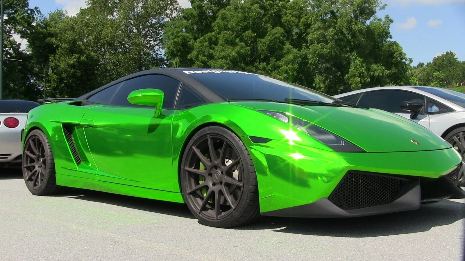

Green chrome

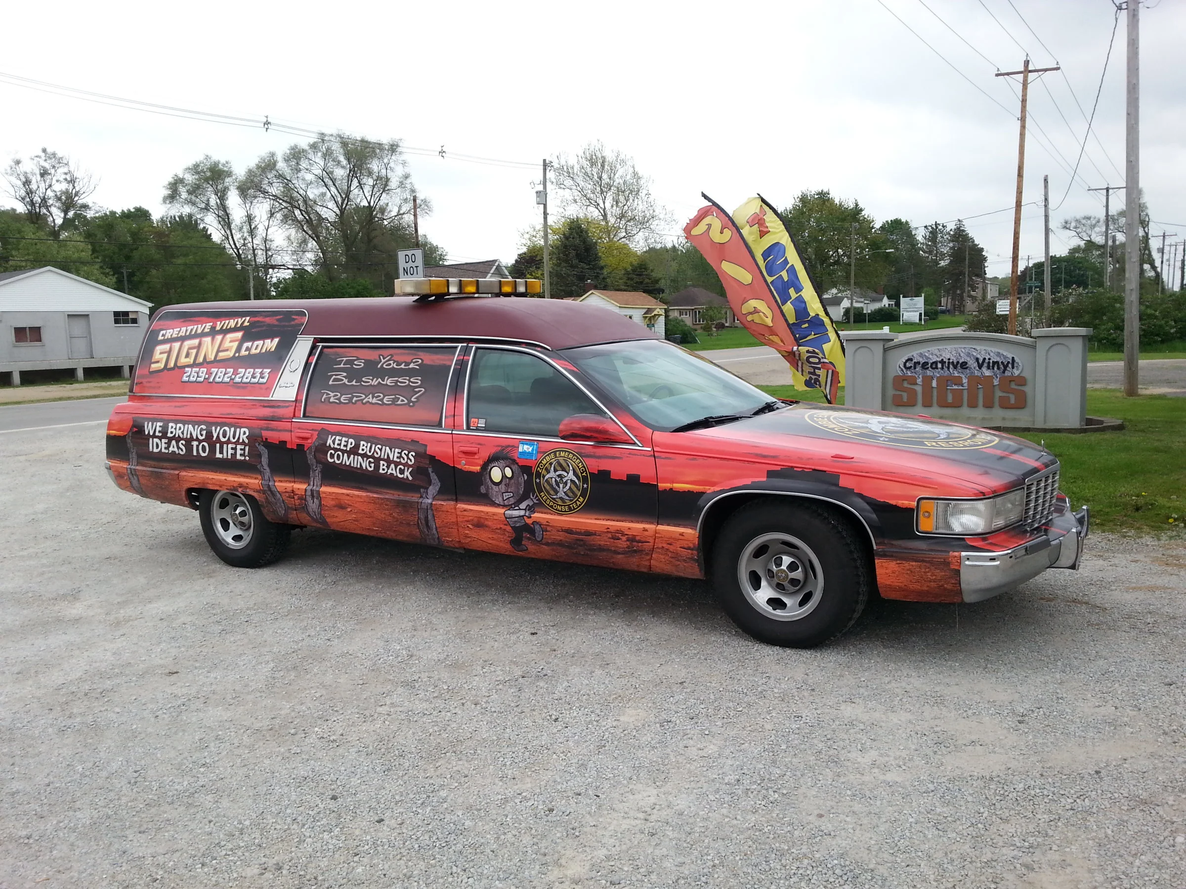

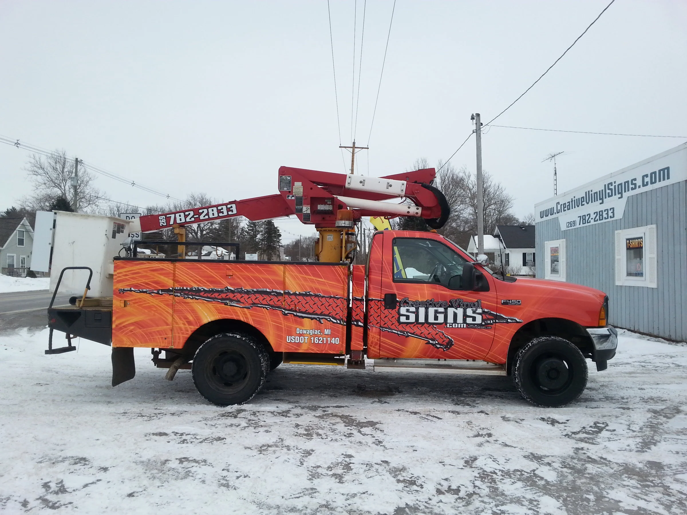

Body work is super important! Every flaw will be visiable. The only way to get around that is to use a very "busy" background so you don't notice the imperfections. With the new vinyls, bubbles aren't an issue, just don't be cheap about what vinyl you buy. Seams will be noticeable though, if you are going with a solid color.
That being said, I'm pretty sure I'm going to wrap my fox this winter. My cheap paint job is already showing its age, and it is much easier for me to wrap it, then to paint it! For us to wrap a whole car, it would be $2k and up. It takes a long time!
The bucket truck was "road commision yellow" and the hearse was white. Notice how busy the backgrounds are. This hides flaws / seams!
