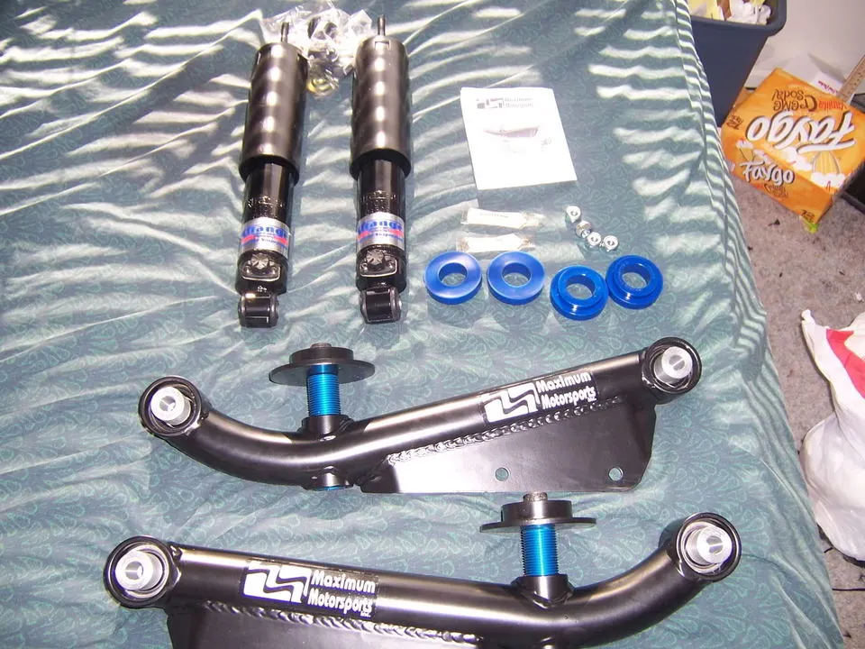

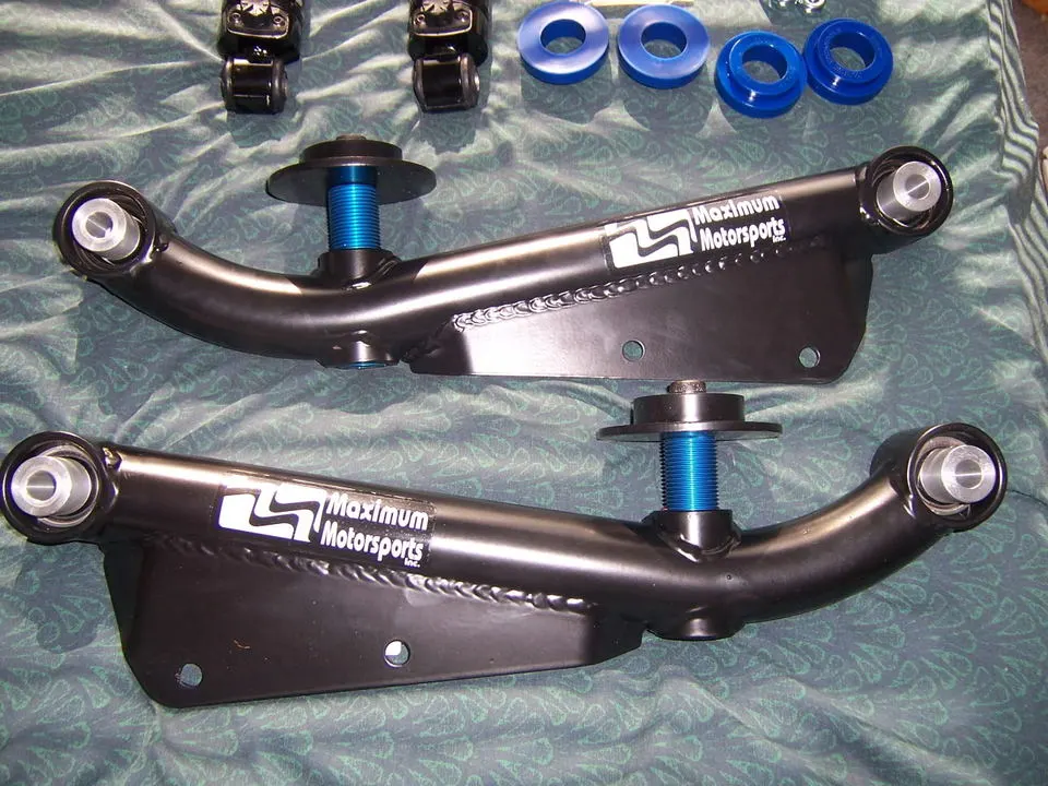

I know the crab walk feeling that you're talking about. It's pretty scary at times! That's why I bought these bad boys!

Yeah when you break something I could see the car crab walking...or when a car has had it's frame/suspension so bent that it can no longer trac straight...I know what crab walking is. But still don't equate that to rear wheel torque steer. I could make up a term and call it whatever I like too...but it doesn't make it accurate. (I've got all kinds of terms you never hear of too)
Shiroelex - nice pics, nice parts...I'm jealous.

What is your main purpose for the adjustable control arms. I'm just trying to find the value in getting those. That is almost the exact setup that I am going to buy once I get the cash.
I bought those exact ones because I hit the strip often, and run slicks occasionally. I like my car slammed when cruising, and wanted the adjustable spring perches so I could crank the rear end up to run tall slicks. On a set of stock 'stang springs and the perches all the way up, I cleared a 28x10x15 slick with no issues. I liked the extreme duty arms because they have spherical bushings on either end of the arm as well. The only downside I've found with them is that they have a tendency to chirp on rough terrain. I just need to get my fatass back under the car to grease them up again. Here's a shot of the car with them at about 3/4 of the way down. It can go lower in the back than this!
