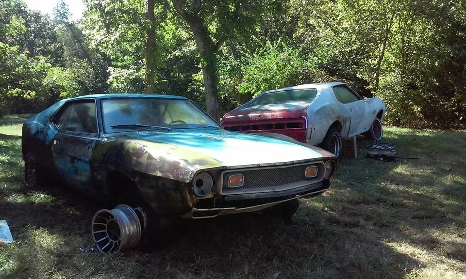

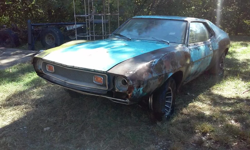

Ok, first off i just want to say I'm probably going to confuse the daylights out of both you AND me. So follow me down the rabbit hole.
Secondly I don't own a stang. I own an amc javelin.
Now you may then wonder why I'm posting questions in a stang forum. Rightly so.
Thirdly here's why. The javelin unlike the stang has a verry small aftermarket. Both in body and in performance parts. Now my car has a 304ci motor that is verry similar to the 302. But very much different.
What I'm trying to do is convert another companies mpfi system to work on my car. And I've basically narrowed the ford 5.0L to be the most compatible with what I'm trying to do.
So now I'm trying to plot out what i need to do to make the conversion. So that's why i need your help. Narrowing down the years and parts I'll need. Mostly for right now i need to know all the sensors that the fuel system needs to function. If there's some i can leave off great. The less wiring i have to add the better.
I know i need maf and map, O2 sensor, and timming. Speaking of the timming where does the signal for the timming come from?
I've seen some post saying off of a magnetic pick up in the dizzy. And others that say they come from a crank and cam sensor. Different years i would assume. What year marks the difference? And what do each of the use to count the timming?
I know this is a weird set of questions and a crazy idea. But any help would be great. If it helps i have had a couple early 80s stangs and a capri when i was a teen.
